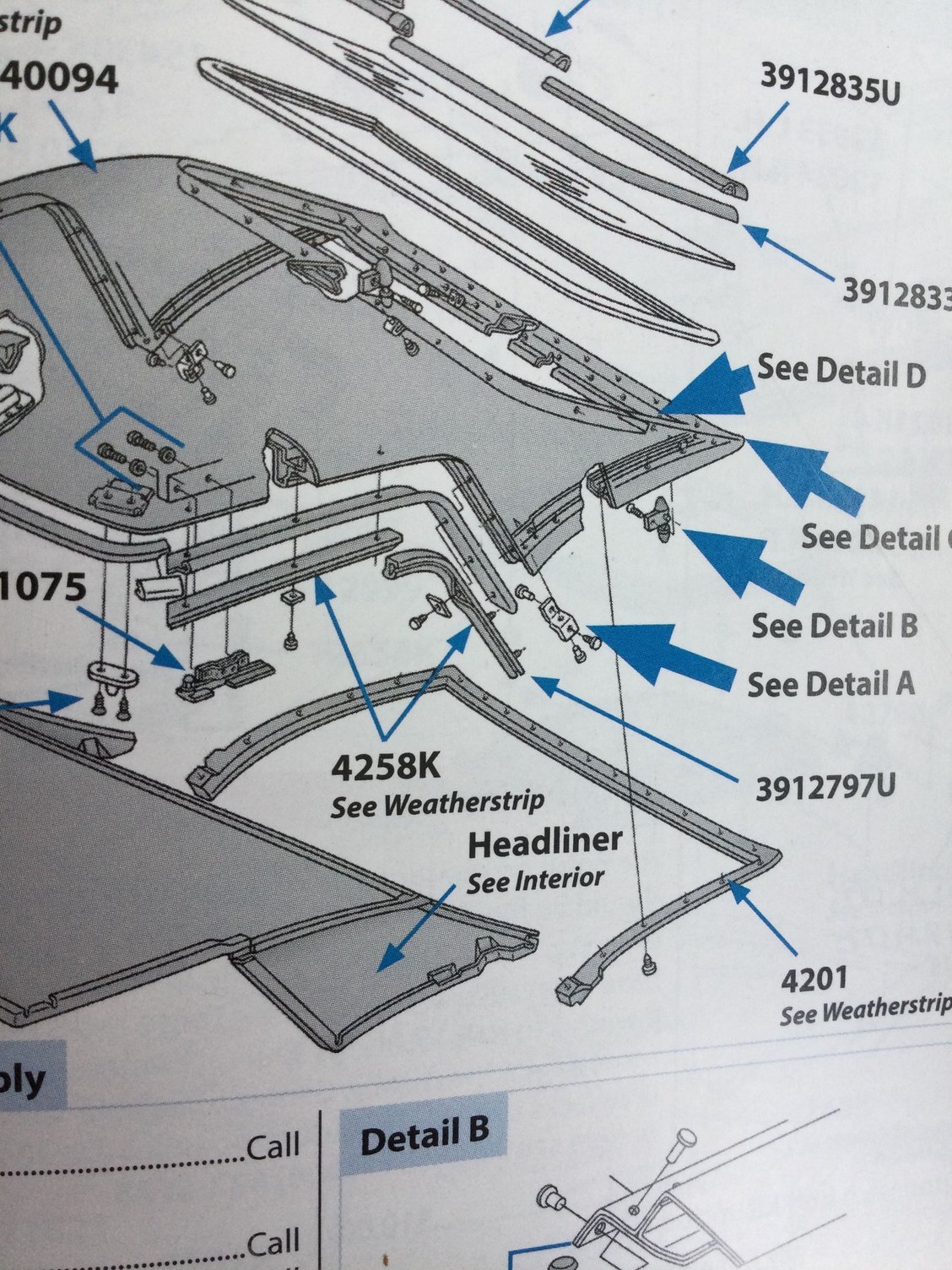

I will take an uneducated guess that your car didn’t leave the factory with a hard top? I can’t figure out how to get nuts on the “threaded posts” sticking out of the bottom the hardtop, my soft top is in the way. My 73 came with special “Receiver looking nuts” on each side of the rear deck. All the vendors sell the parts needed and installation only requires drill the fiberglass and mounting the receivers. The hard part is the metal bracket with rubber cover that is mounted on each side of the hard top. No one sells them, our old friend Ernie at Willcox was kind enough to get me a used set he has. You can try a Corvette Savage Dealer. Here’s a picture

The above catalog is from Paragon, other vendors may have a better illustration. If you need a better picture let me know, and I will take a photo of my hardtop.

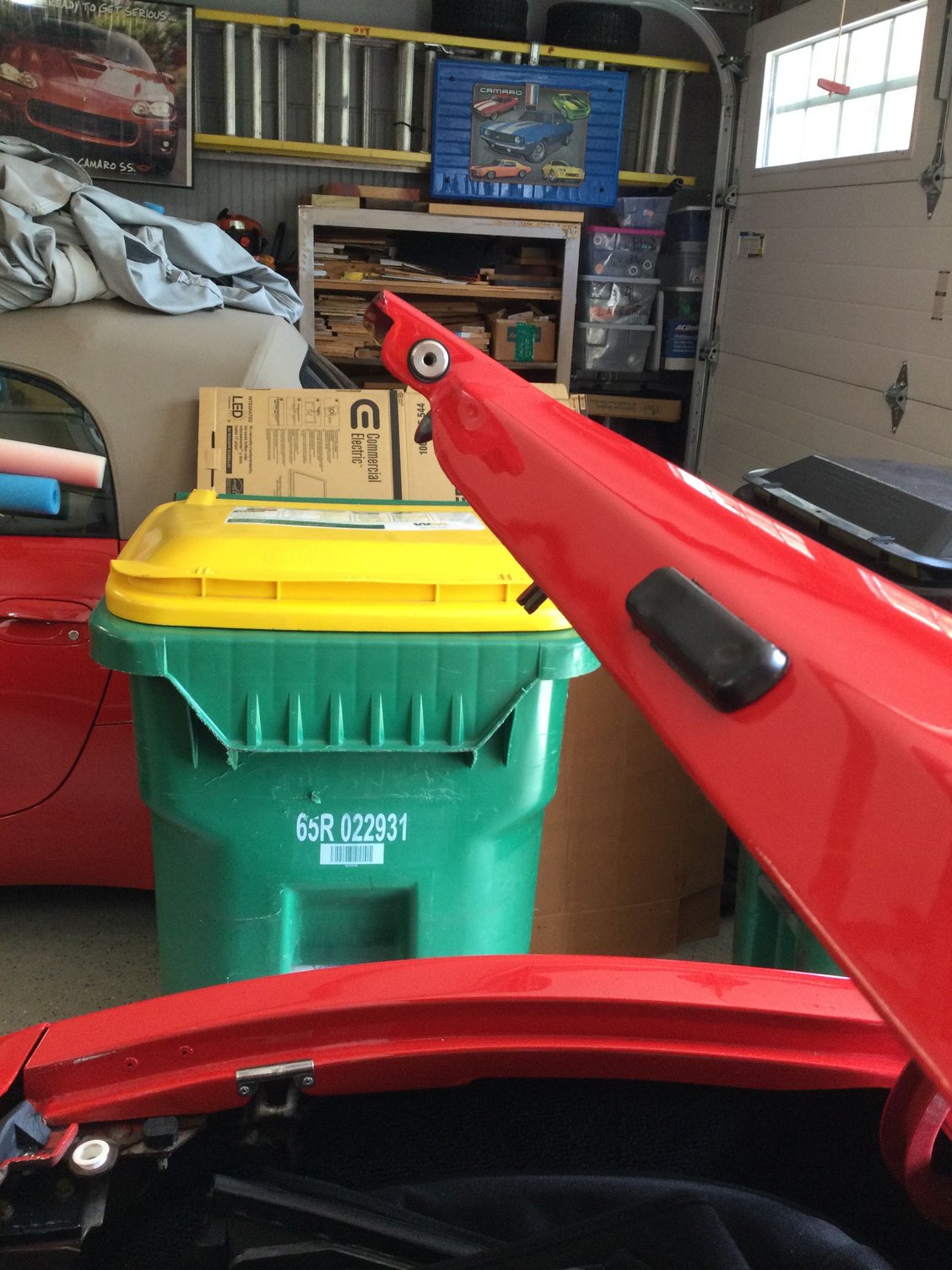

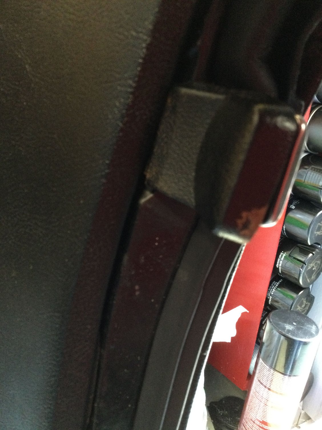

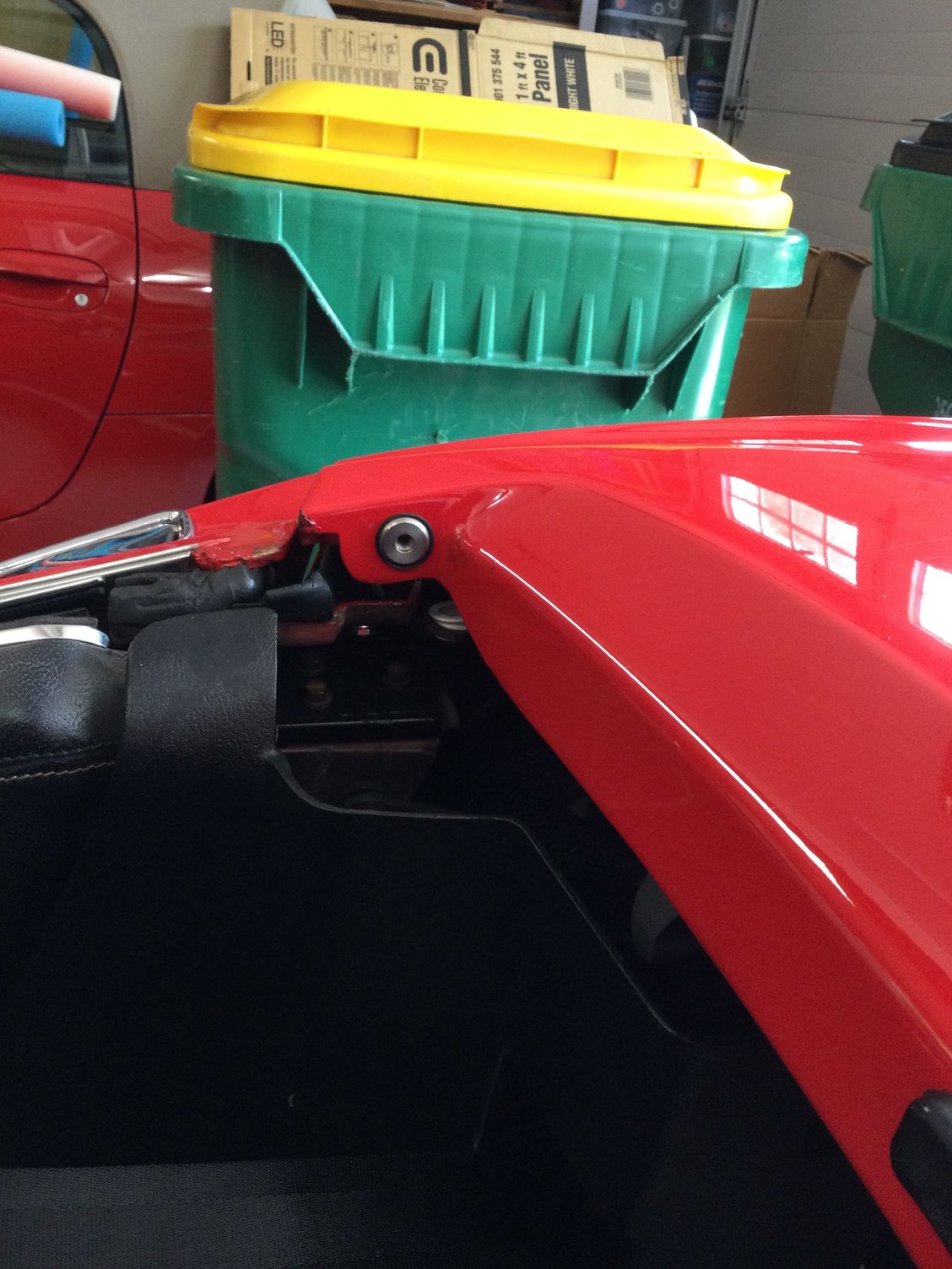

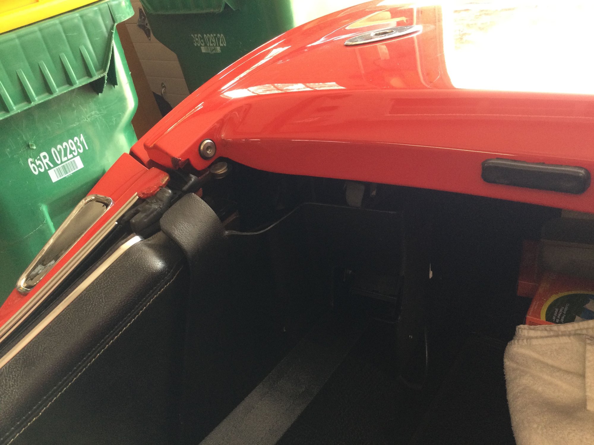

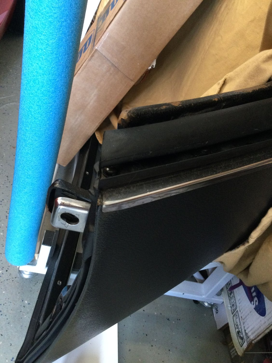

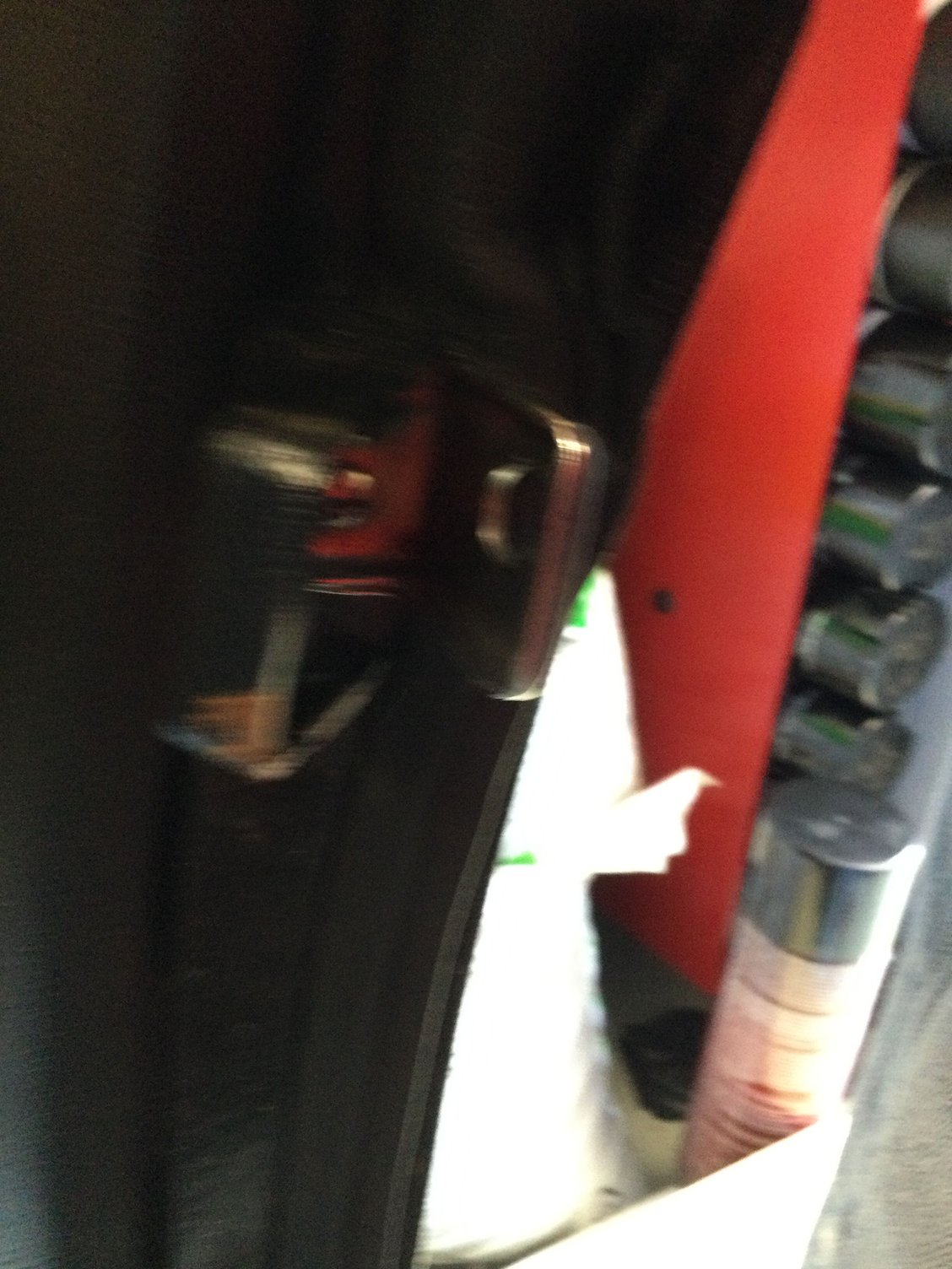

Here are pictures of the receiver parts mounted on each side of the deck lid. The other pictures are the meta l bracket mounted on the hardtop with the rubber cover. This is the way the car and hardtop came from the factory in 1973.
The brackets are not sold by any vendors, you would have to call a corvette salvage yard
The rubber cover was dyed to match the car interior
The stainless steel round receiver is where the special screw is inserted through the hardtop bracket, vendors sell theses parts
The receivers are on each side of the deck. I don’t use any nuts on the shafts coming out of the bottom of the hard top.

Thank you. Now I see and understand it.

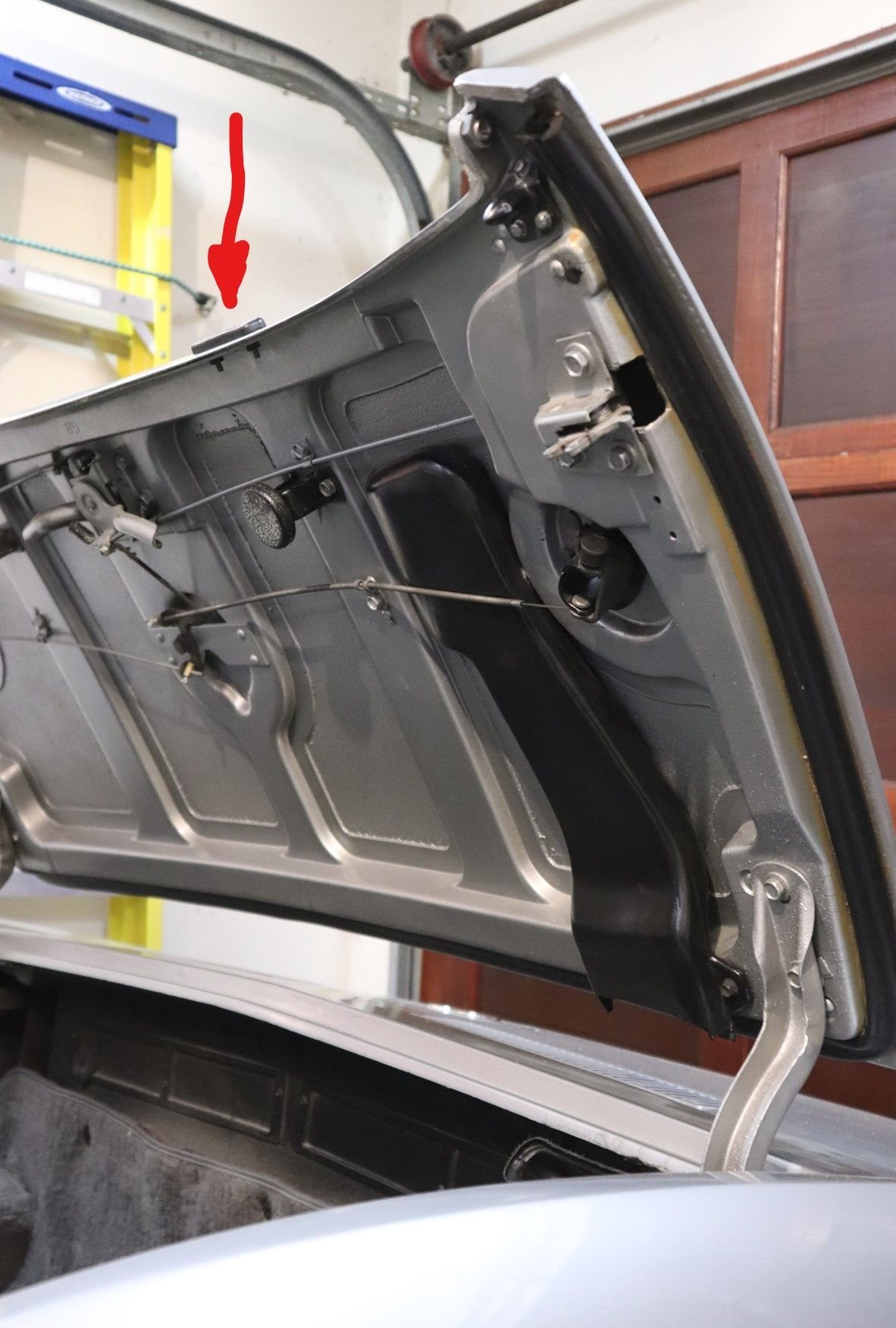

If you don’t mind,could you tell me what that rubber bumper is on the edge of the lid?
Old Aug 7, 2022 | 07:10 PM
'73and'75's Avatar
'73and'75
Joined: Aug 2019
Posts: 451
Likes: 520
From: Chicago Burbs
Seat back bumper (2)

I need to find those seat back bumpers also as my driver's seat has scratched the lid.

The 68 and 69 did not come with the seat back bumpers. Obviously they can be added. The 68/69 seat back shell did not come up high enough to touch the lid IIRC.
If your car came with the hardtop, there would be a hole in the middle of the deck. Only 68 did not have the hole.
