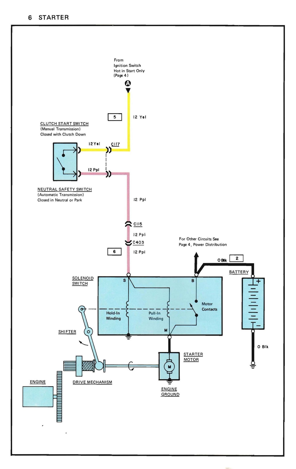

JMO...
#14 gauge wire may be a little small for that load, I would jump to a #12 like the drawing calls out...
