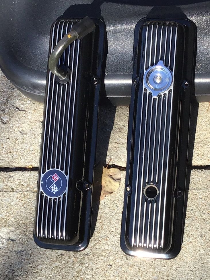

Hey Guys!
Any tips or how-to videos for installing new gasket and valve covers? I'm a novice at best, just got a C3 and am learning as I go. Really love teaching myself and being able to work on it.
Below are the ones I'm looking to purchase. Thank in advance.
1969-1982 Corvette Aluminum Valve Cover Show Quality | Eckler's Corvette (ecklerscorvette.com)

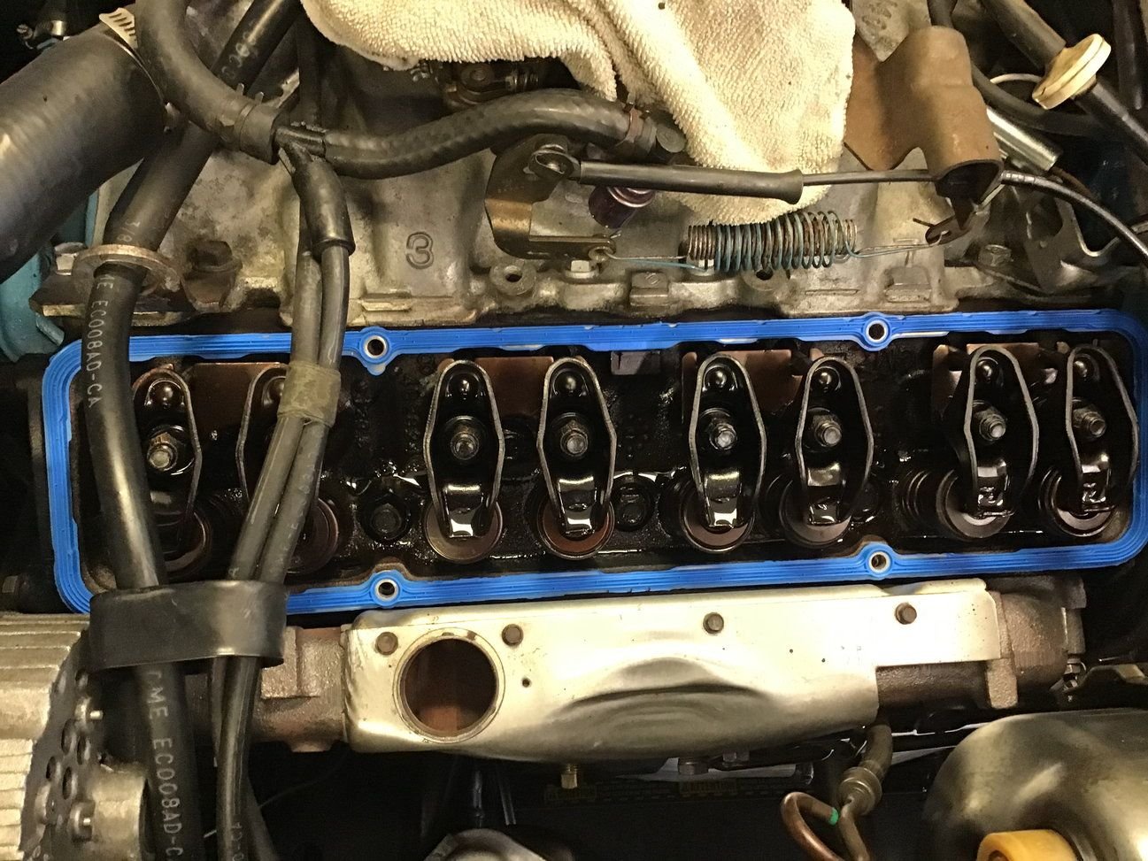

I have used the reusable rubber gaskets with good luck but recently upgraded to the blue neoprene speedway gaskets I bought on ebay and they seal great.
these are what I bought.
https://www.ebay.com/itm/265568111160

These are the gaskets I have had the best success with. They are pricy but last for years, and are reusable, if you remove the valve covers:
https://www.oreillyauto.com/detail/c...gaskets&pos=19
They include weight spreaders for the bolt holes, but you will not use them with the aluminum valve covers. They have a metal core, so it is difficult to over-tighten them. They are installed with no adhesive. I normally put them on the valve cover, and install the bolts, to help keep them in place, when I set the valve covers on the heads.
