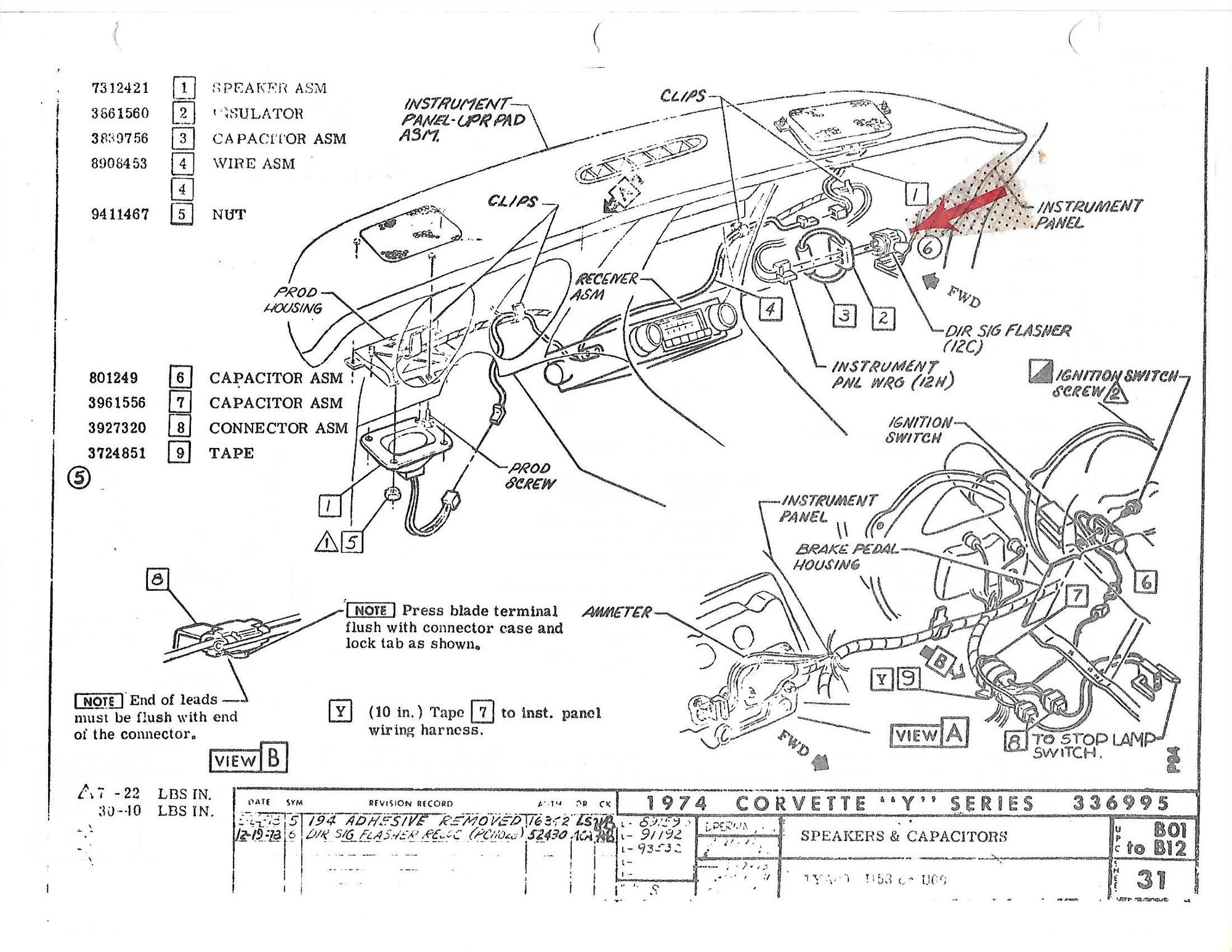

1971 corvette, turn signals come on outside and on dash but do not blink. Hazard Flashers do blink. Is there fuse for the blinkers or is this a different issue?

The turn signal flasher is over here:

Yup, I would try a new flasher can first. The bimetal spring probably stuck closed.
And the 4 ways have a separate flasher can. When I was young and poor, I'd just switch them.

Thank, was the flasher can.
