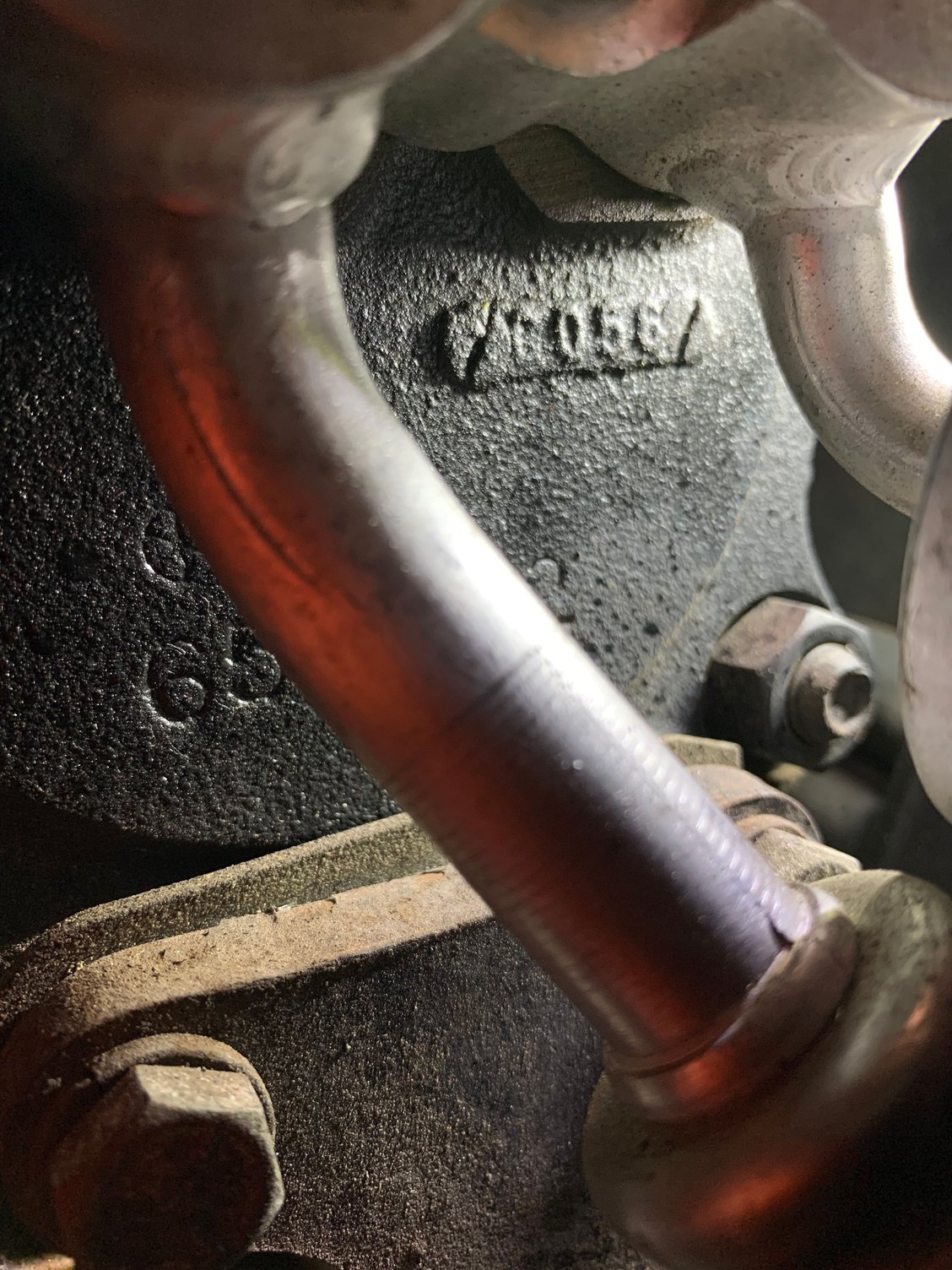

AC Compressor:
Modelnumber on the decal: 6550133
Castingnumber: 6555302 D45
Castingdate: G056

6550133 was used on several Chevy models from 1962 till around 1969 but not on a Corvette. The code number is a date code printed in black ink of MMDDYS (where S=shift) would be on its foil label. Yours is the casting date of the case. would equate to July 5th 1966.
6555302 was the compressor head used across all GM lines for many years and models.

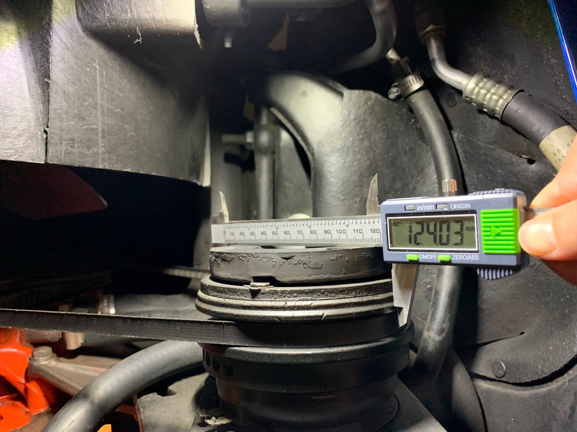

That's the way I read it also. Only thing I would check also is the pulley diameter (OD) . If it's about 5 3/4" its a Vette comp. 72 BB had a smaller pulley and the SB had a 5 3/4. 6550133 was a 66 Chevelle foil.

If I have measured correctly is the pulley its 124.03mm, so in inch is 4.883", that's near by a 4.870" pulley.
Or was measurement method incorrect?

Measurement was correct and the BB used the smaller pulley.

Okay, than it’s a complettly inccorect compressor on my 72 C3 SB.
1966, Chevelle decal, BigBlock Pulley etc.
