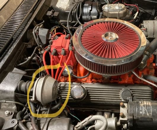

I don’t have a pic of the hoses themselves, but you remove the two hoses from the actuator circled in the photo and use a dowel or similar object to plug them so they don’t leak vacuum. Your actuator may look different, more like a soup can than a spaceship.
With those hoses plugged, the door will have to be opened by hand, by taking the rubber plug off the front of the actuator and pushing on the diaphragm inside with a blunt object. To close, just push down in the wiper door itself.
