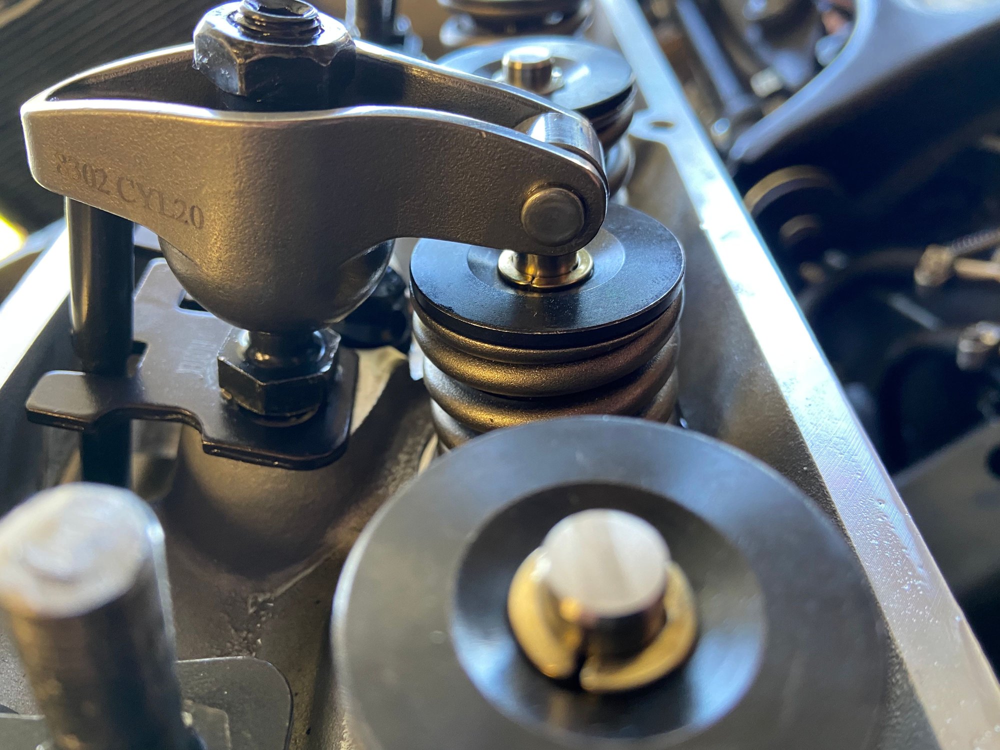

Hello,
I recently put new heads on my engine and shortly afterwards realized the new heads have valve springs that are a larger diameter than the old ones. I have cast steel roller tip rockers right now that are rated for 1.5” valve springs and the new heads have 1.560” single coil springs. Would the old rockers work or should I purchase new ones?

The amount of lift with the camshaft will be the deal breaker.
If you can get a breaker-bar on the crank bolt, slowly turn the crank until number 1 cyl, Intake valve is at its maximum open point. Or you can use #2 cyl. Which ever is easiest to get at and inspect.
Then take a feeler gauge between bottom of rocker and retainer.
Off-hand I don't remember the minimum clearance. But you should be fine with that set-up.
Edit: Google says 0.020.
Another web site says 0.030
And yet another says 0.060

Pushrod length needs to be checked. Longer pushrods and lash caps might save you. Check the clearance first before you go buy more parts.

I installed the rocker with a length checking pushrod and it looks alright to me. But I’m still not 100% sure if I don’t see something that may be a problem.

Looks good to me. Would like to see a shot of a valve closed just because.
What ever clearance you have on that retainer to rocker gap, the other 15 should match unless it's a dual pattern bump stick.
I see an old mark on the stem from checking pushrod length. Pretty much dead center.
And maybe its the camera angle but it appears the rocker stud is not torqued all the way? I see a gap under the head of the bolt. That would concern me.
Either the stud is incorrect length and bottoming out in the hole or really thin guide plates? IDK

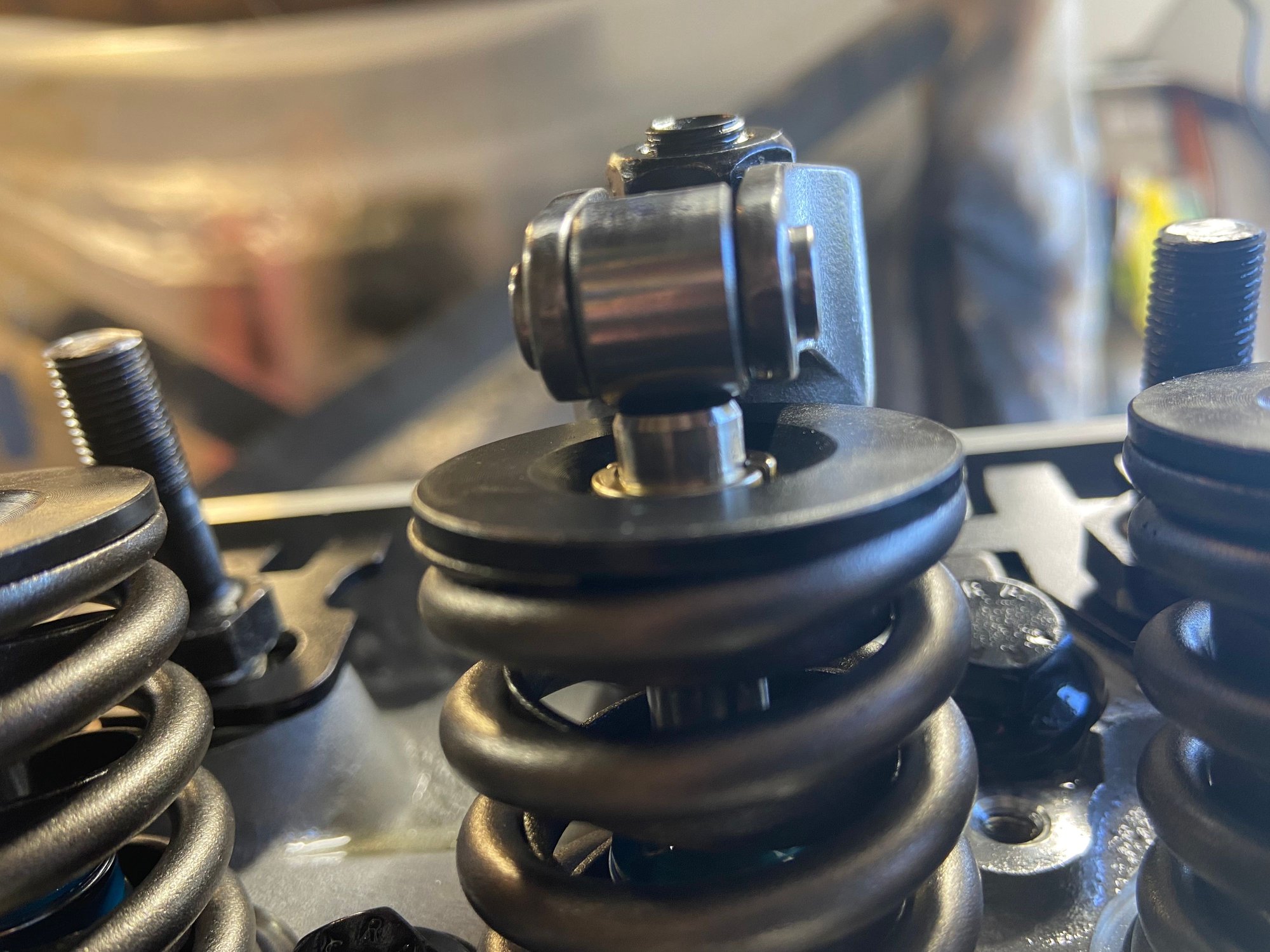

The cam is a hydraulic roller .495 intake .500 exhaust so I think it’s alright. Also, you’re right, they aren’t all torqued yet as I’m still adjusting some of the guide plates. The valve closed picture is below.
Thanks again.

Ok, good. I see a nice gap between retainer & rocker.
I also see the spring pocket is milled for a larger valve spring if you choose to do so. But I wouldn't push it.
I usually give the rocker stud a drop of Loctite Blue before installing. Do your studs go into the port? In other words, are threads showing inside the runner?
If so, that's an all-new ball game of issues.

Unfortunately the studs are threaded into the intake runners so I guess some kind of thread sealant is in order.
