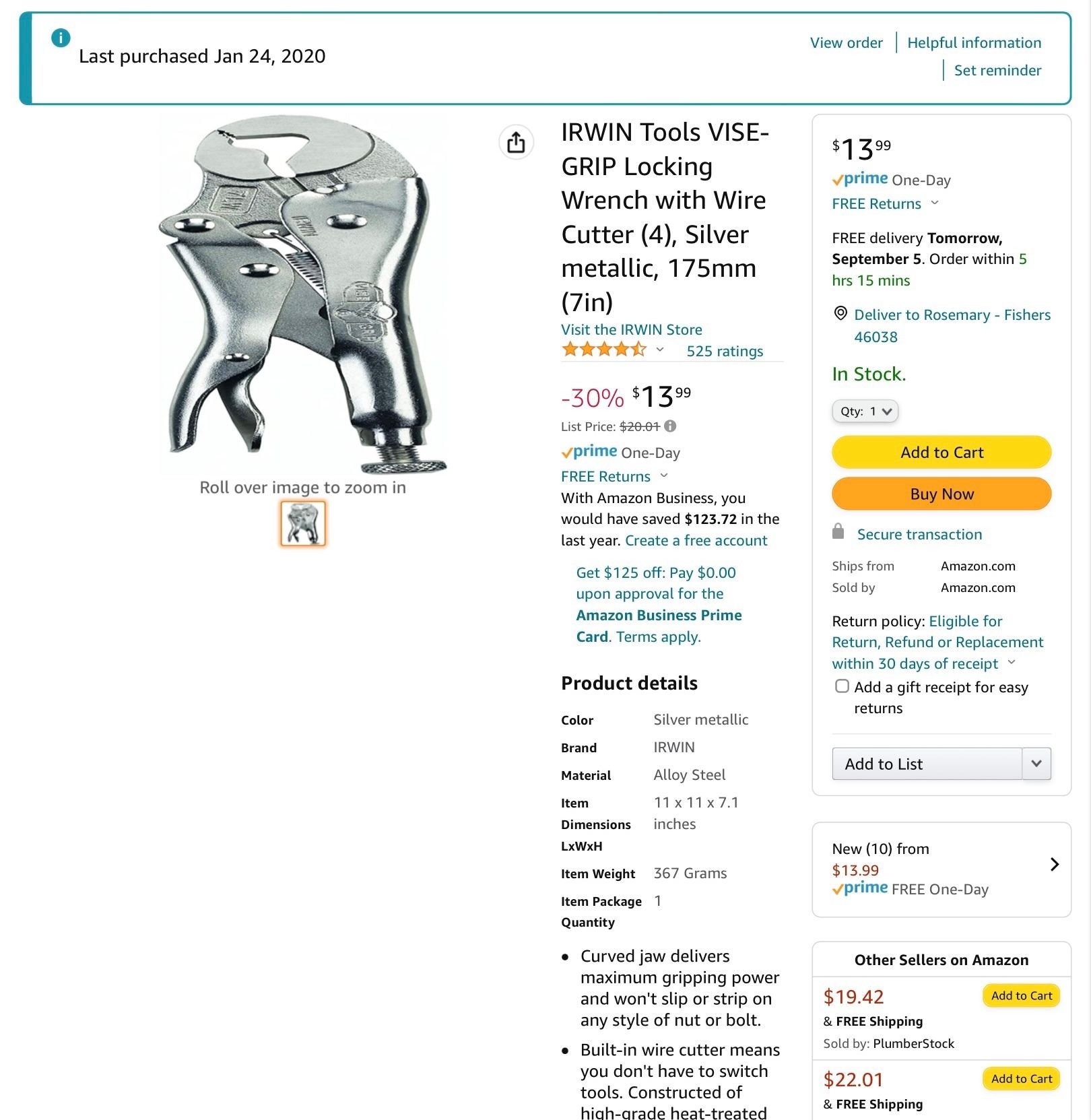

I had same issue with getting brake line off
i would use a nut grabbing vice grip to better turn and not crush.
i would order replace a new brake line.

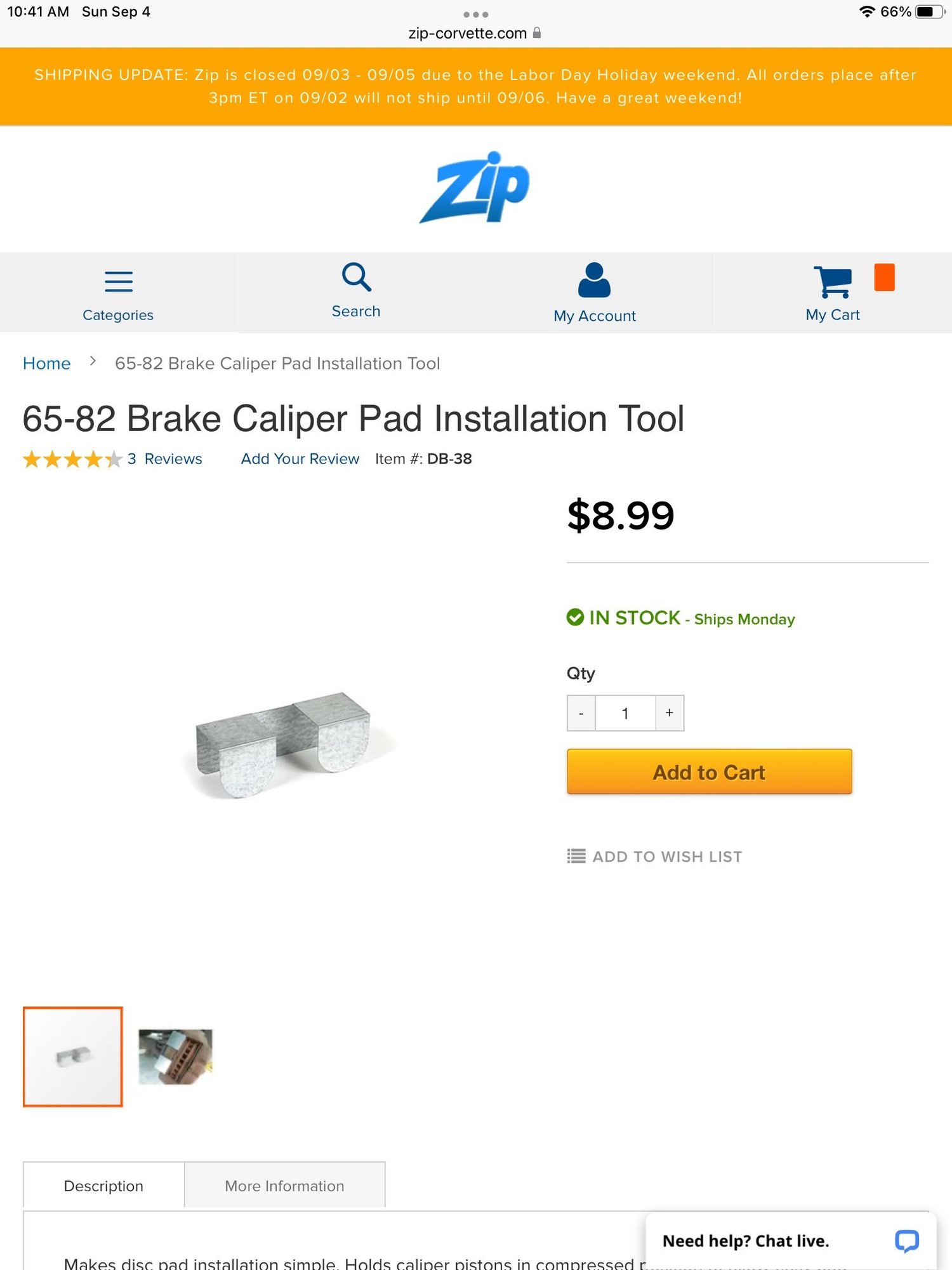

manual says 2 crossed screwdrivers and push into bore. Many use a piece wood to fit in between and slide pads in while wood out. I use the metal caliper holders from the vendors.

I should have asked first or watched a video, and I totally forgot about the book. I slid the pads up once to get a look at them but never totally removed them and just figured it would be easy... Tool will be on the way....

To just slide the pads in the caliper before installing it on the car should be easy, there should be enough room. I put both pads together and slide them between the pistons. The hard part is sliding the complete caliper over the rotor. I tried the caliper tool in the picture, I didn't have any luck with it. I use the block of wood, just a bit wider than the rotor. Slide the wood between the pads, start by sliding over the rotor as you remove the wood. Got some wood!
