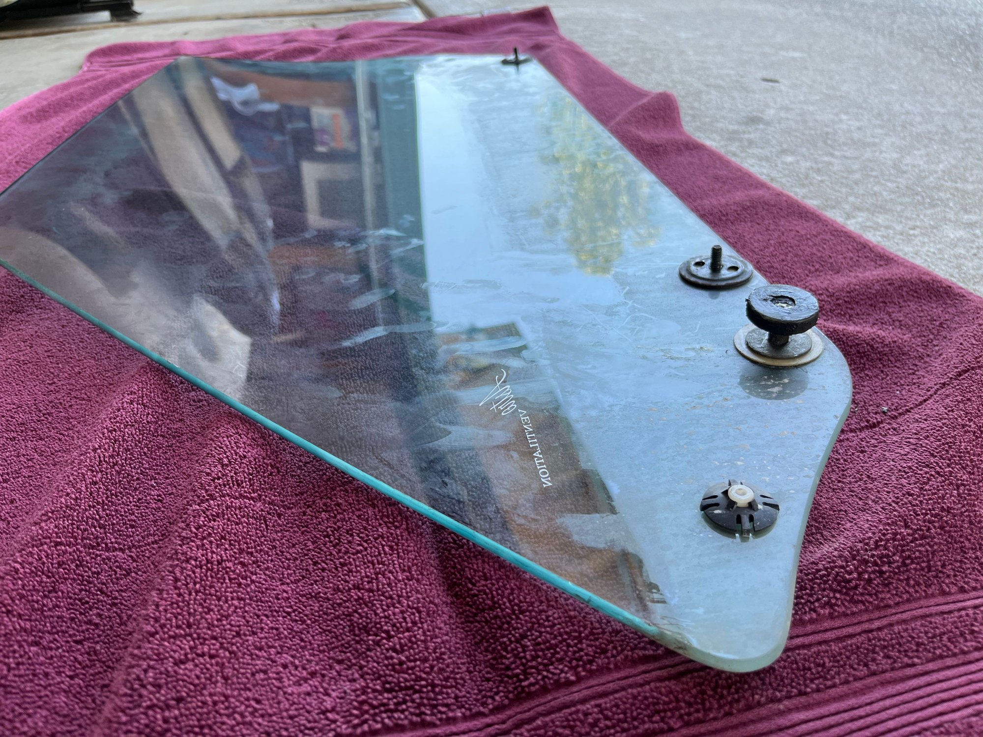

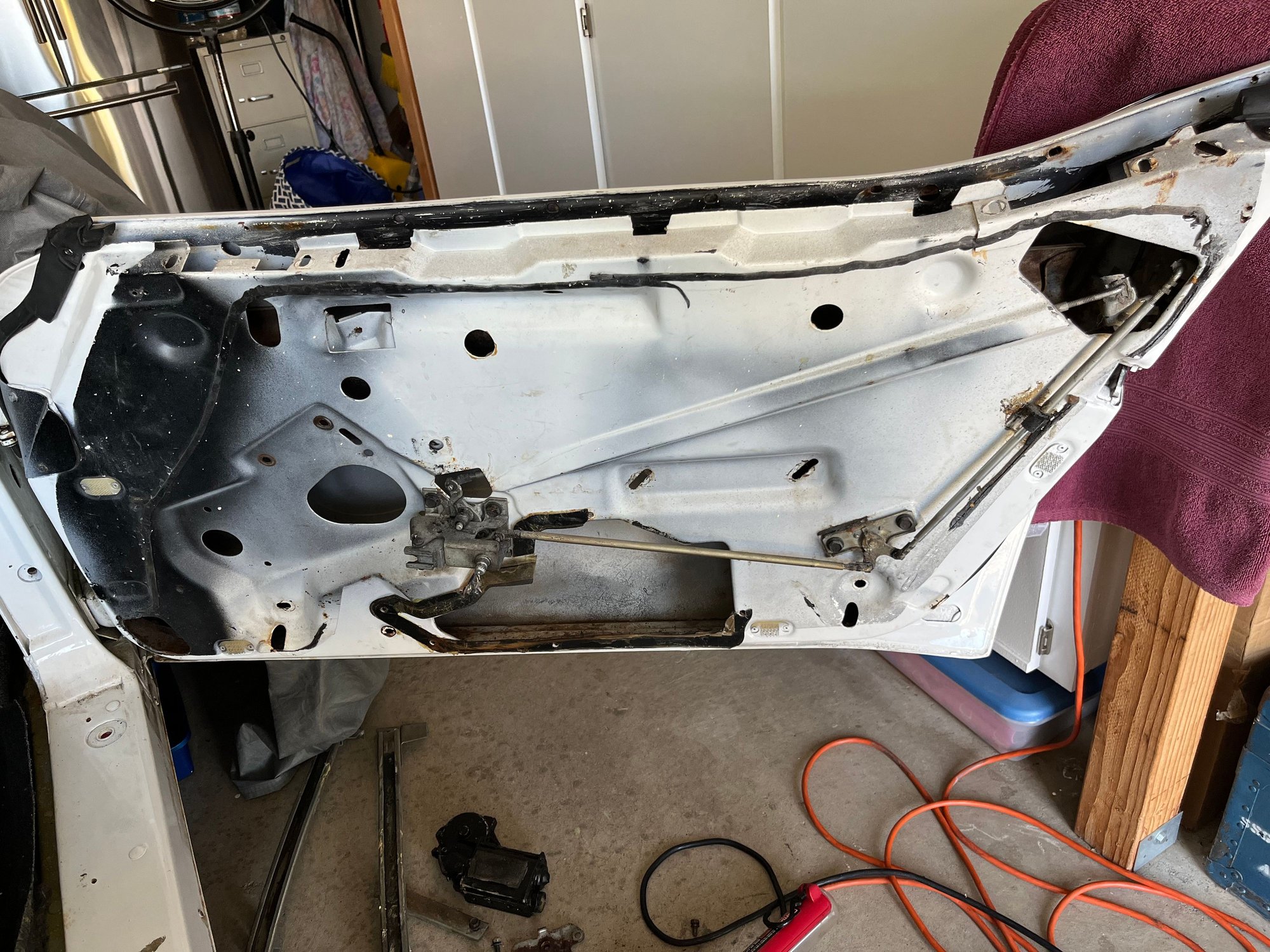

Today I spent about three hours in the garage and removed the window, motor, slides and regulator from the passenger side door.
The videos and the information from everyone was a big help, but it turned out to be a trial and error kind of task.
After removing the stops, all the bolts across the top of the door and the nuts from the rollers on the window, I still couldn’t get the front of the glass to come up and out.
I removed the motor and loosened all the channel bolts, but the one bolt threads on the front of the glass and the front roller wouldn’t come out of the track.
I continued to try and manipulate the glass all over but no luck.
I ended up stuffing a large beach towel up into the door and removed the regulator bolts and let the spring uncoil.
Once I removed the towel and let the glass slide down everything was nice and loose but still no luck getting the glass to disengage and come out.
As I sat there going through the videos and looking at the door in 109 degree heat, I realized there was still one bolt in the lower front portion of the door that I missed.
Once I removed that bolt, everything slid out, the glass came up and out and all the rollers came off the slides.
The slides and regulator came out the bottom opening and I was done.
I didn’t even scratch or crack the glass.
It was a good afternoon.
