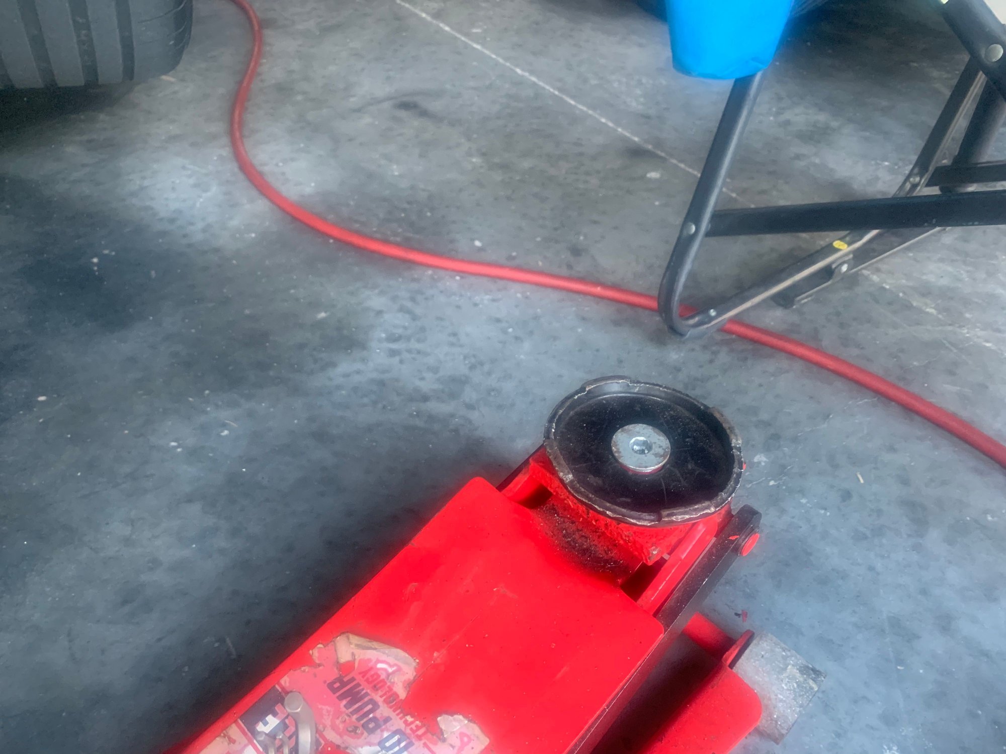

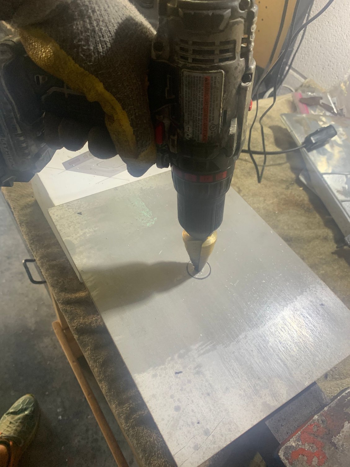

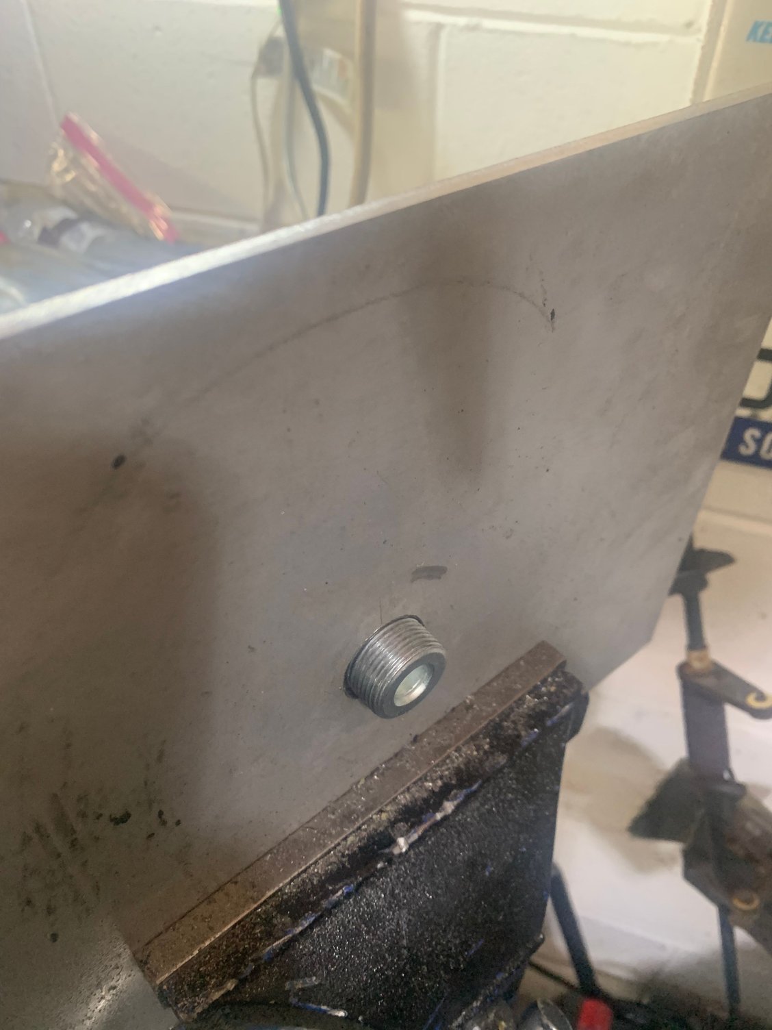

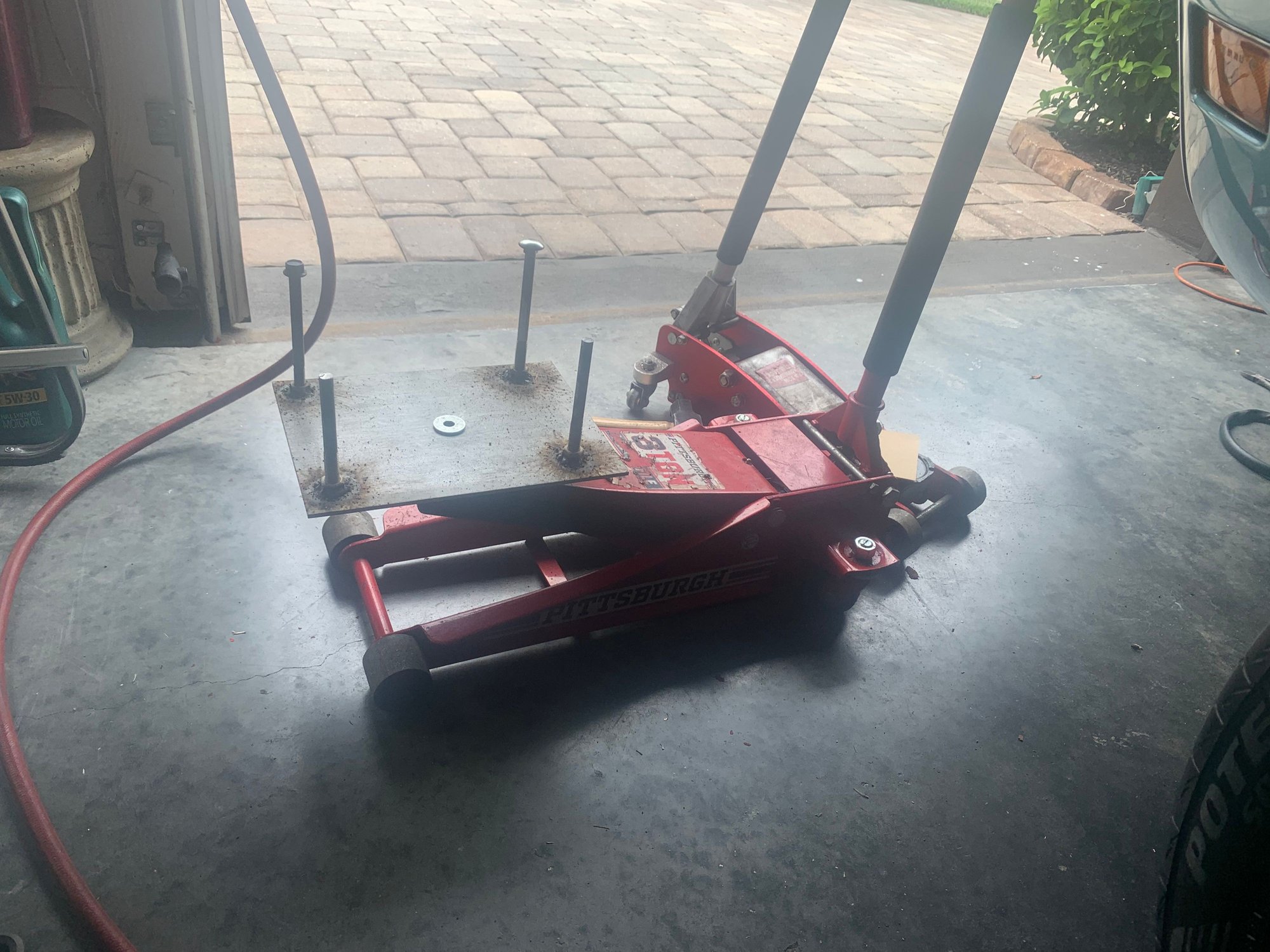

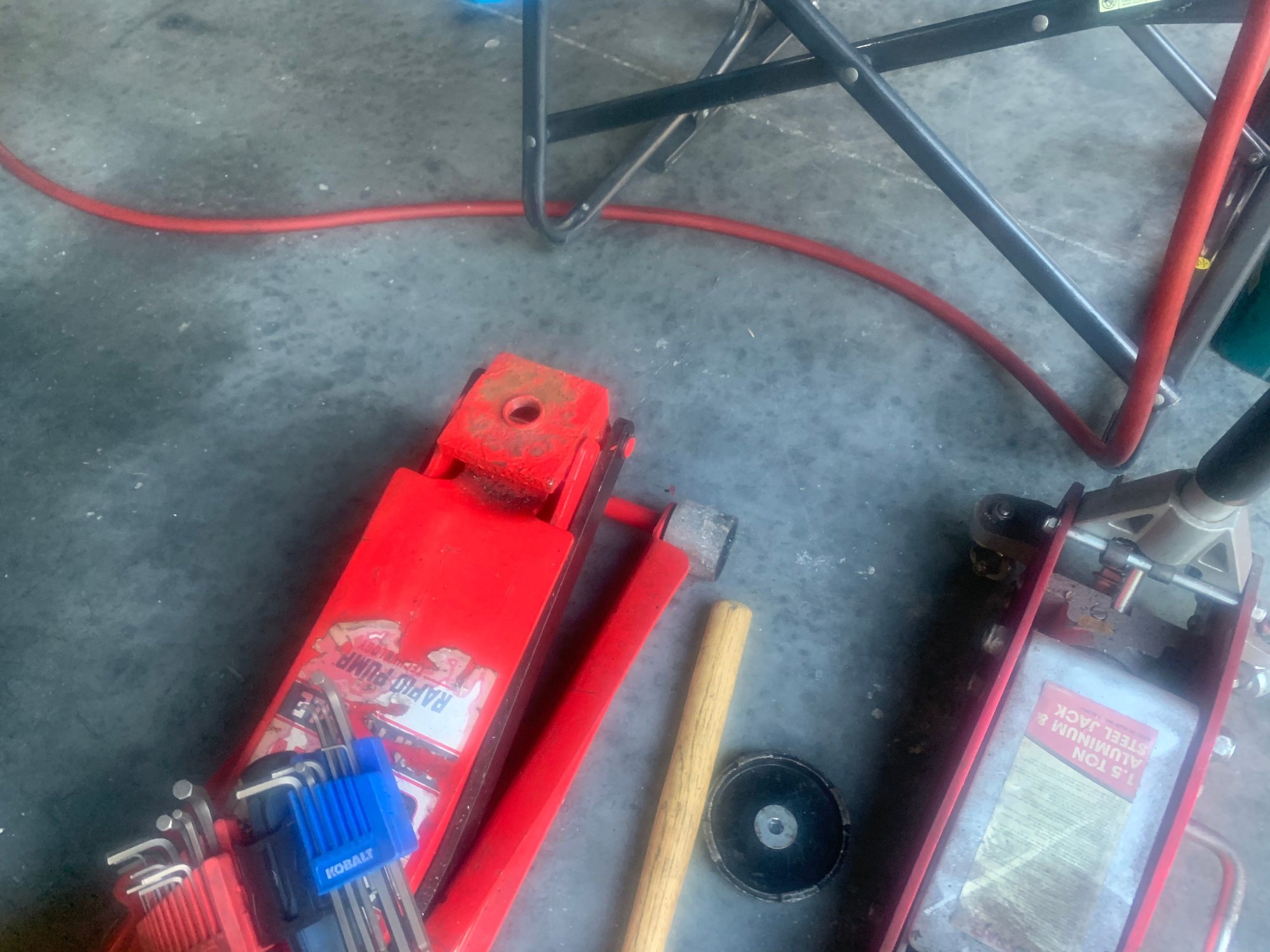

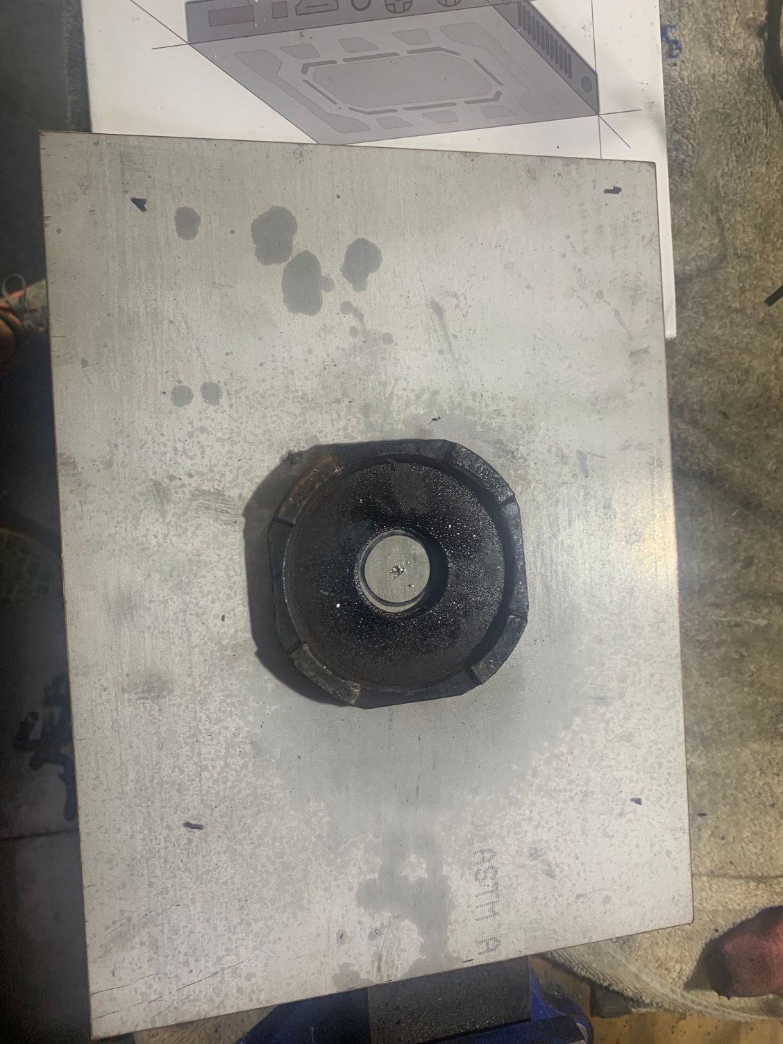

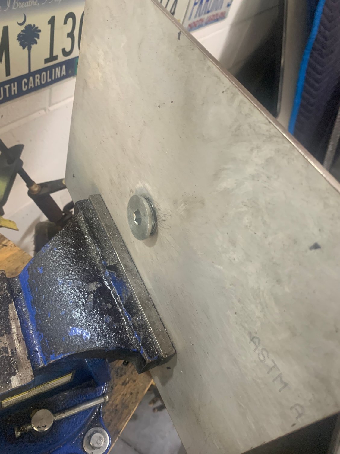

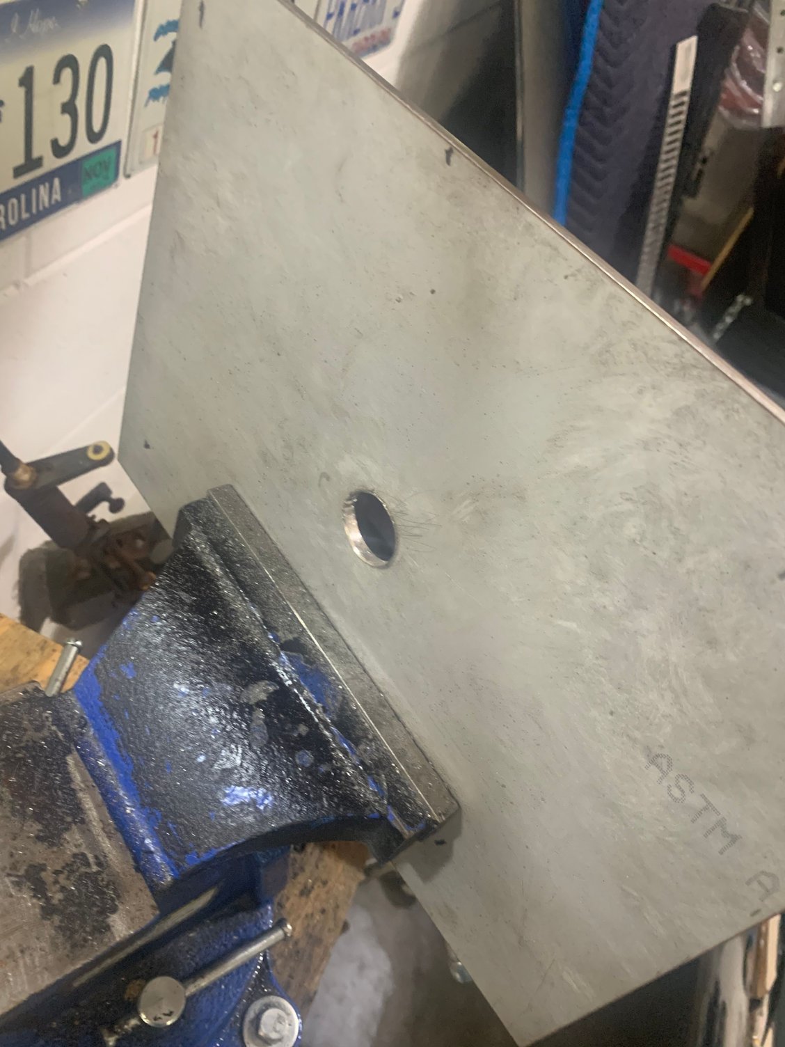

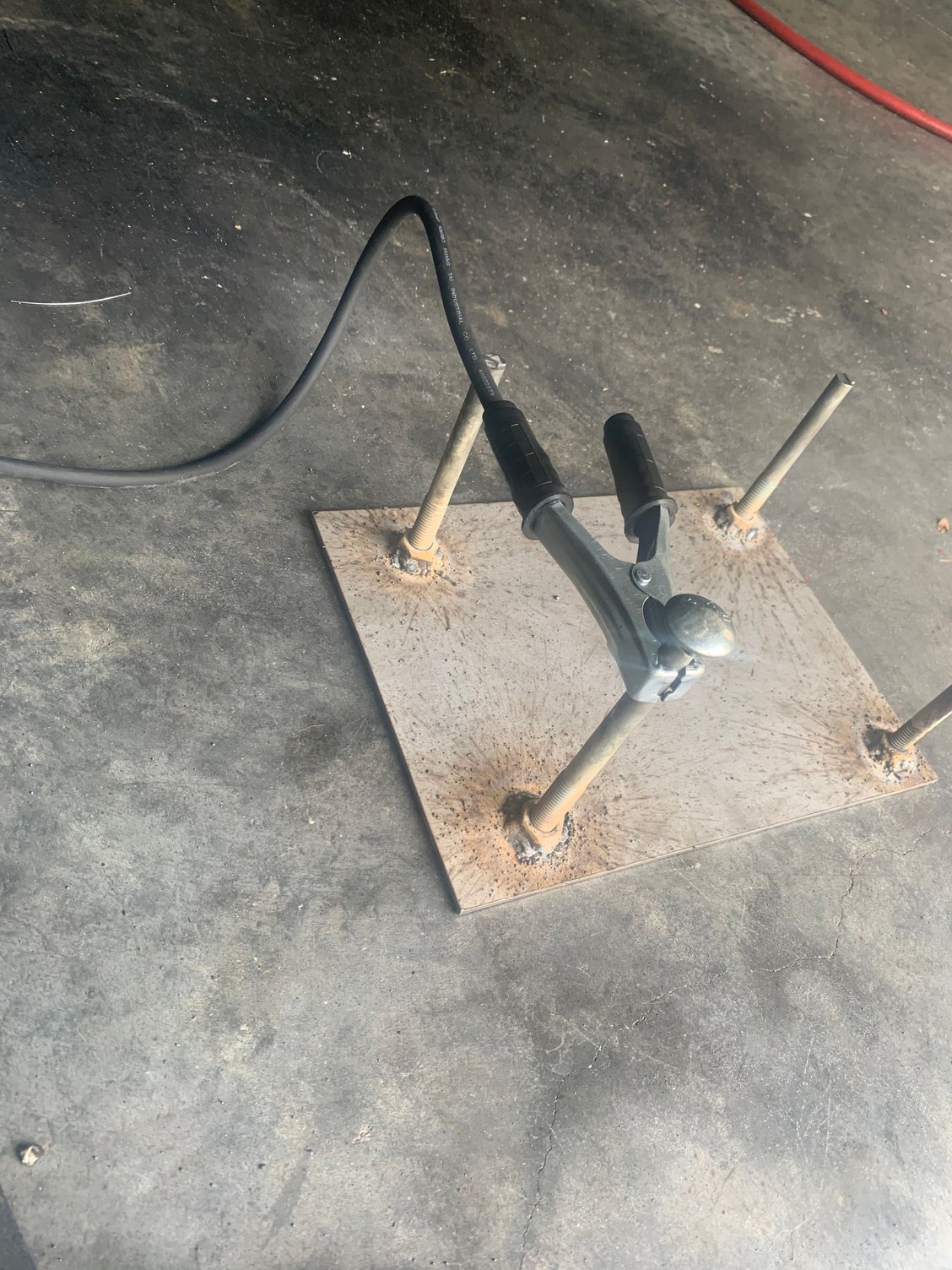

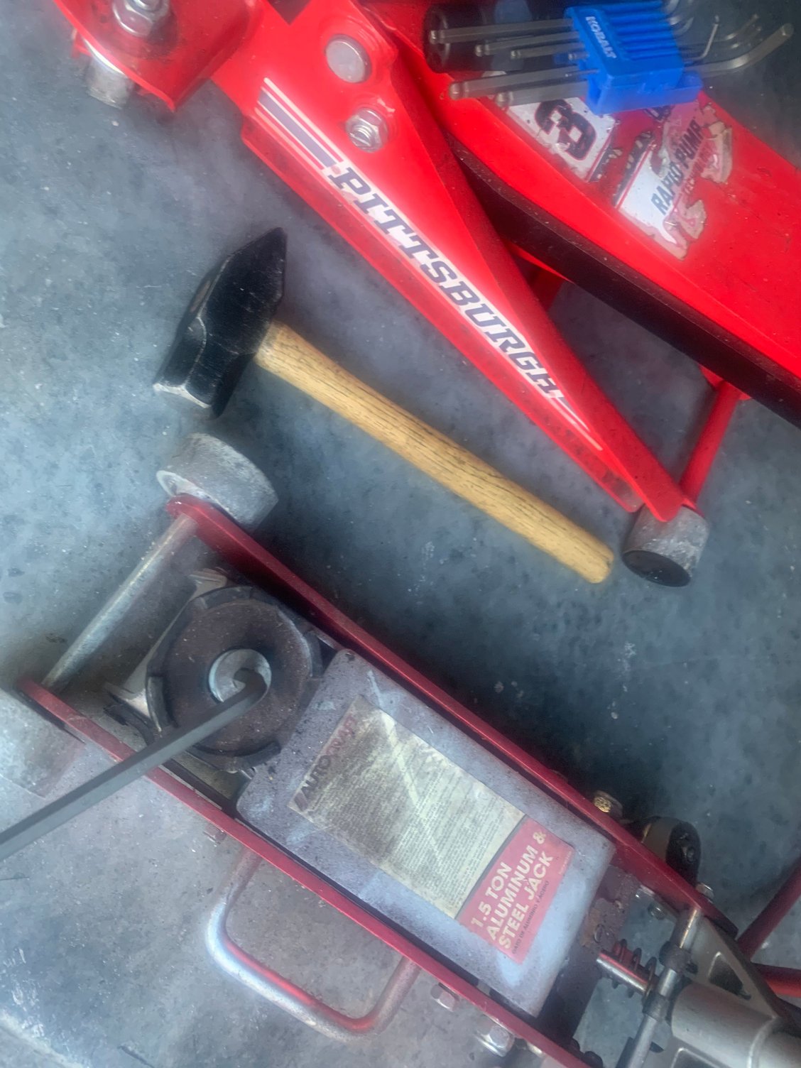

Starting fabricating the tranny jack adapter. Had some scrap bolts and a piece metal left over from when I made my removable crossmember. Doing this on the fly but pictures will speak a million words.
Removed the base from the floor jack
Left over metal with 4 scrap bolts and nut
Jack with plate removed
Jack plate from an old floor jack I had that isn’t operable. I will weld this plate on the metal base
Bolt that goes into the floor jack base
I haven’t welded in a long time but I don’t need them to be beautiful welds. Just sturdy

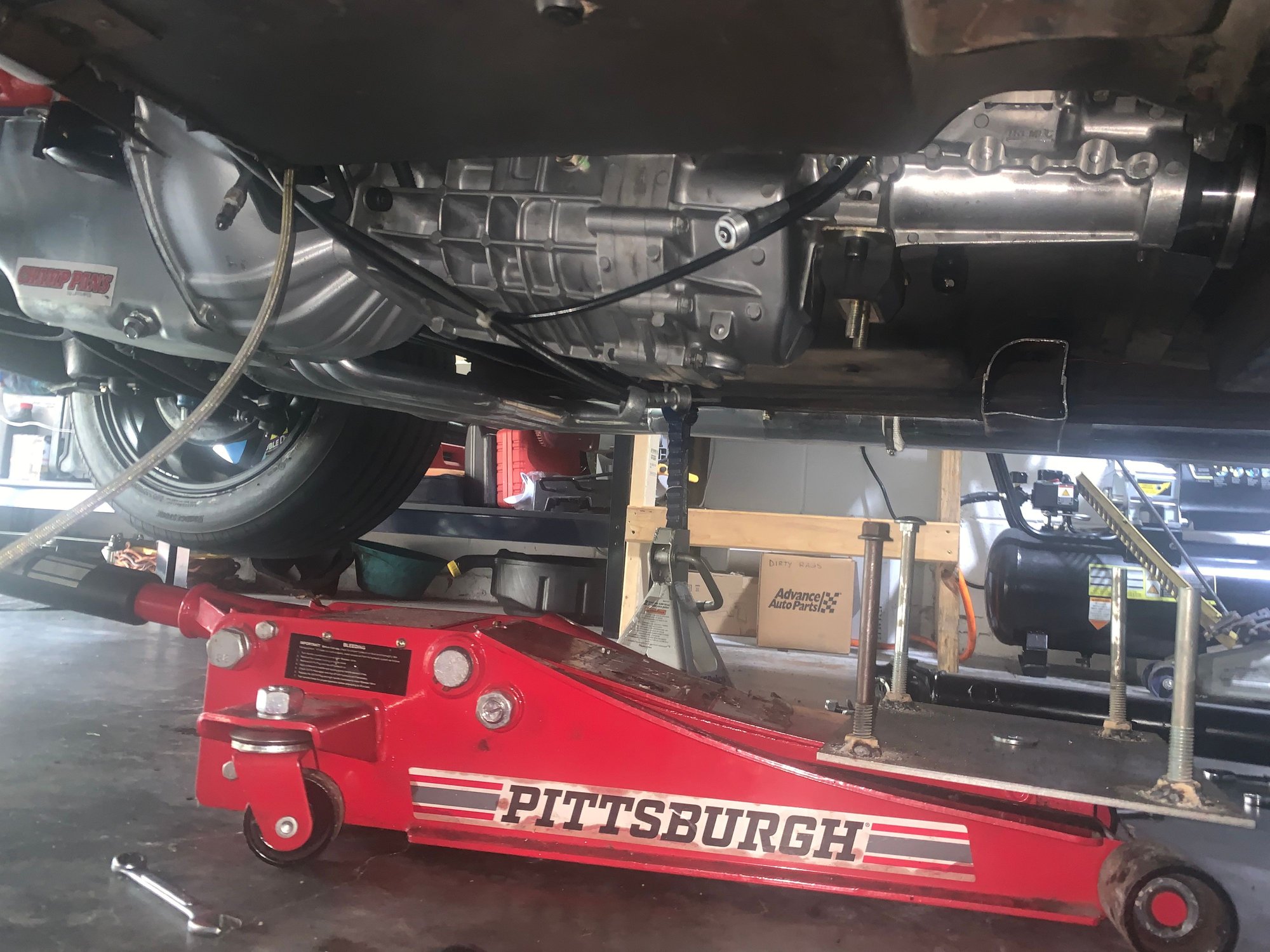

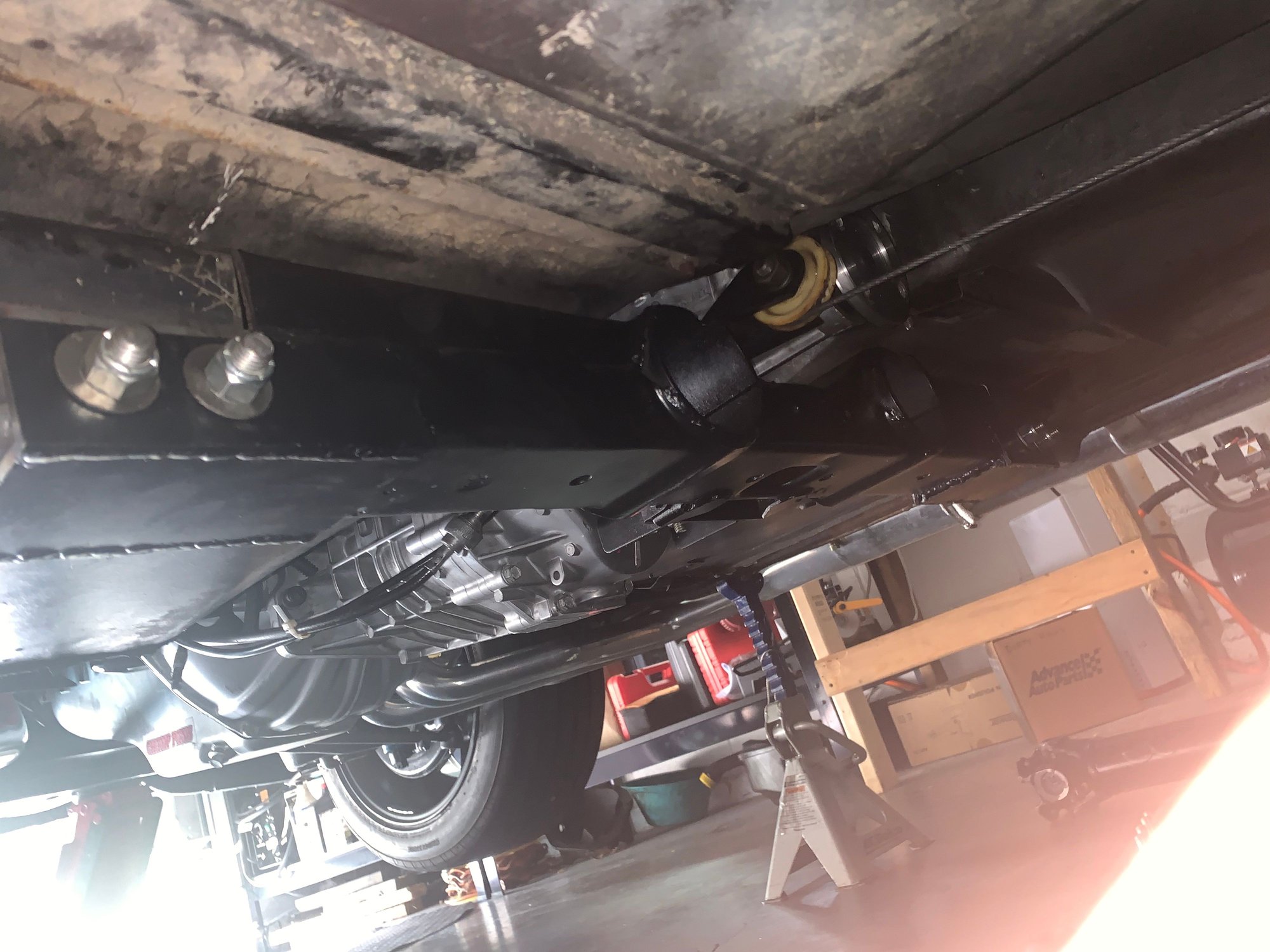

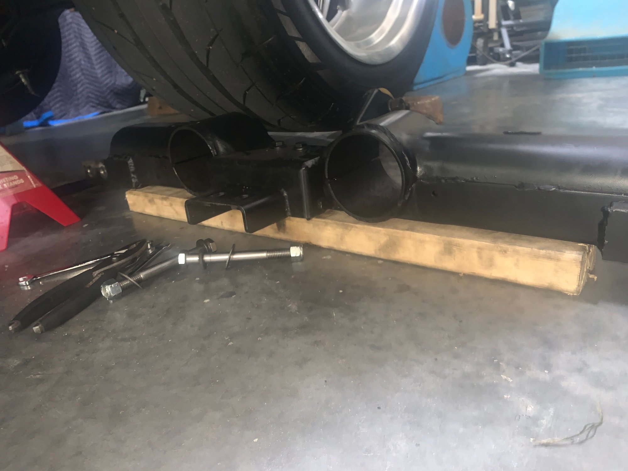

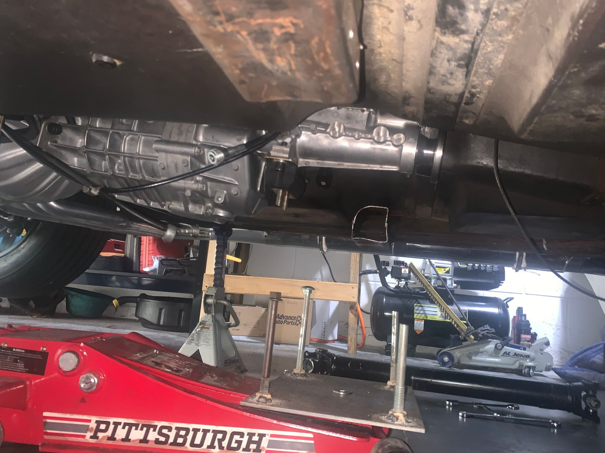

Well got the to bearing hose off, took off the speedo cable, removed the crossmember,
The adapter completed and fastened in the floor jack
Jack in position
Crossmember off
and took on the shifter stick. Unbolted the tranny at the bell and the home made adapter seems to be doing the job. Don’t have the tranny completely out yet as I think the to bearing won’t let it come completely out. Had enough fun for today so will pick up on it some tomorrow.

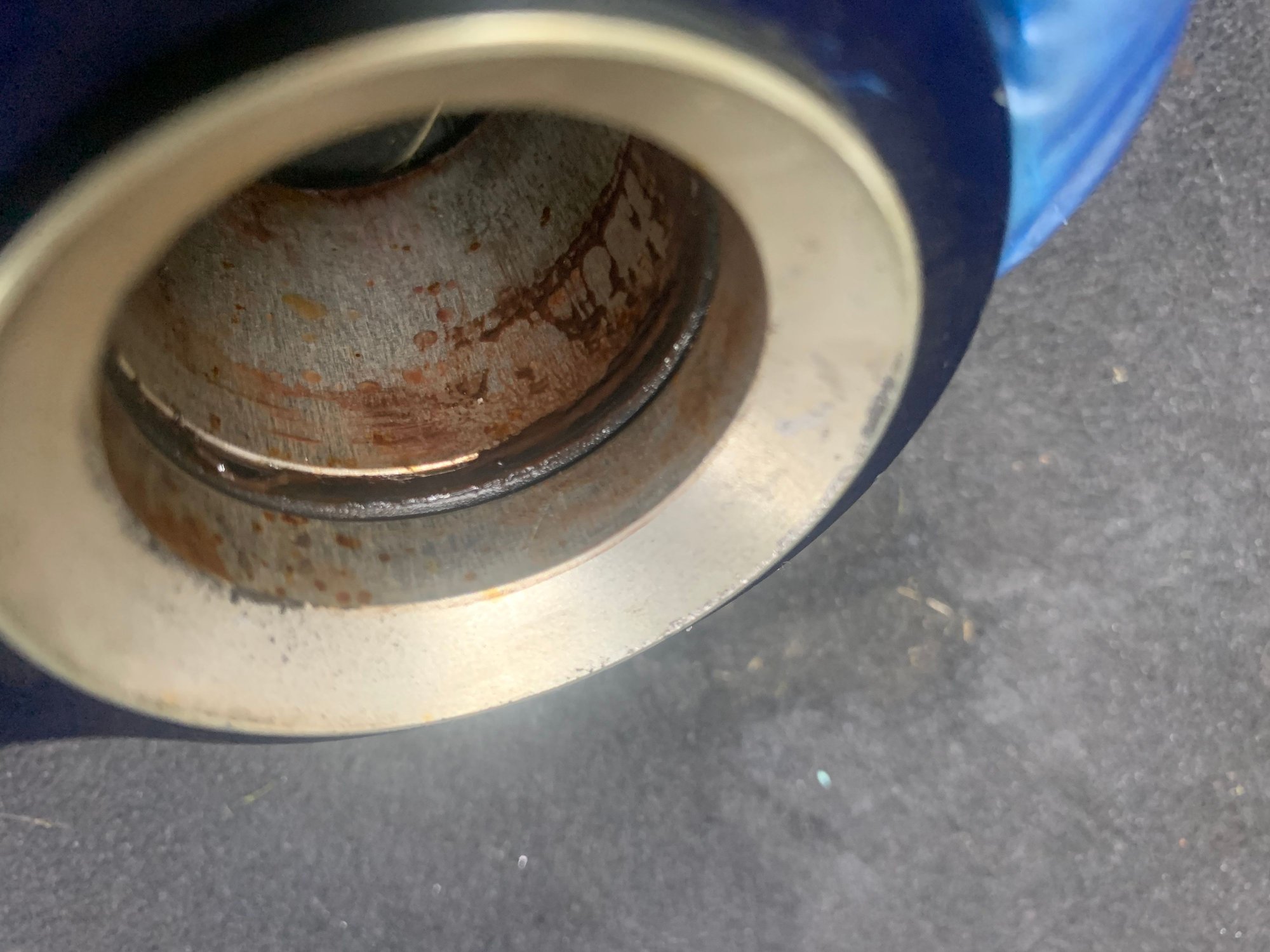

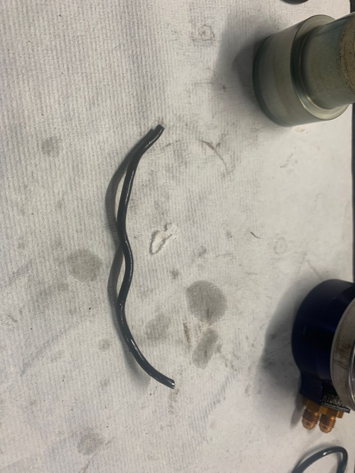

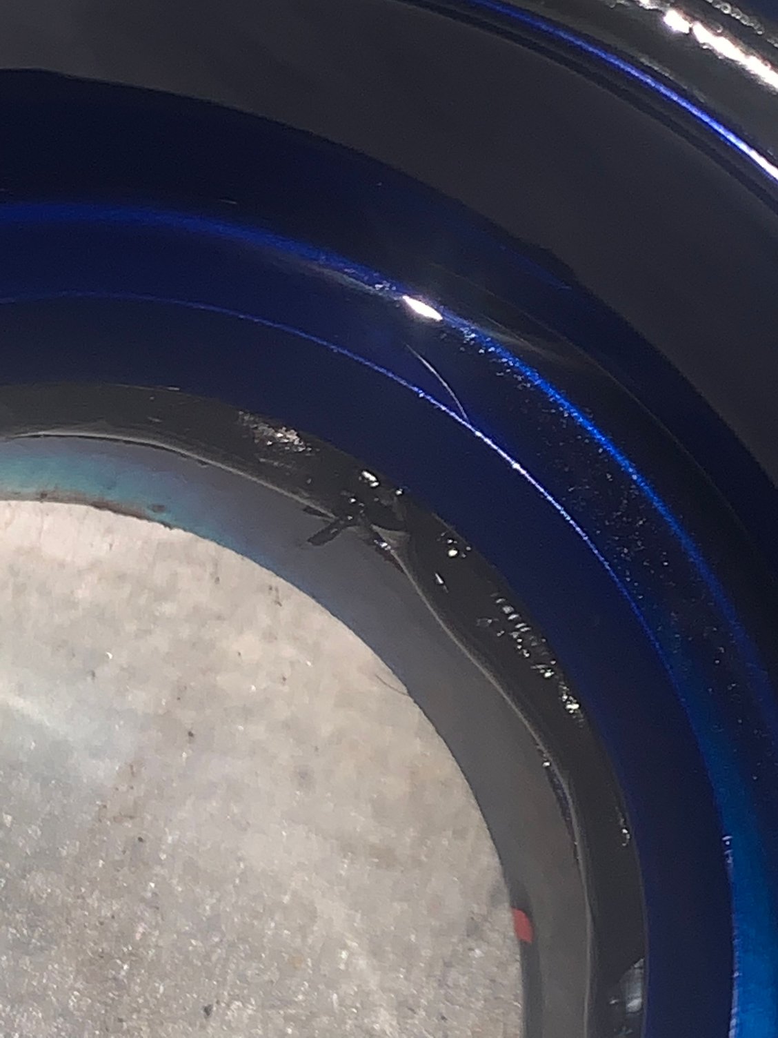

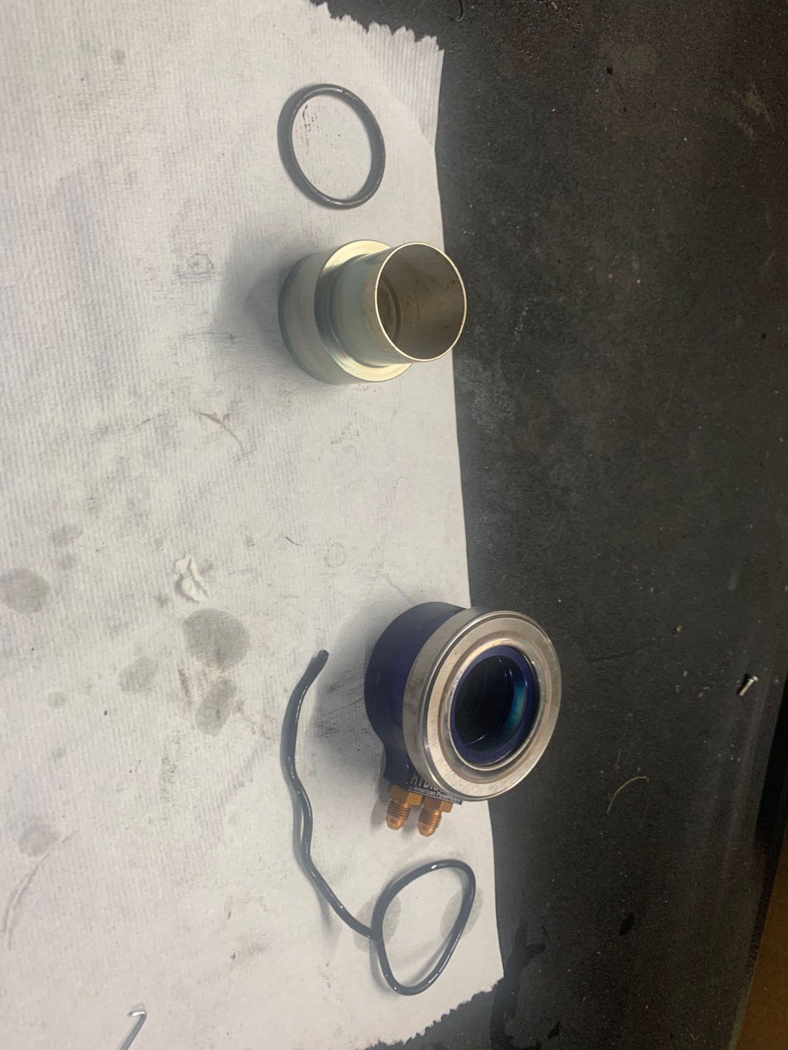

Update. I got the bell off and pulled out the tranny. The remaining brake fluid leaked out of the bearing. Cleaned up the bearing and applied light air pressure through the main hose. Definitely wasn’t holding and I could see a little fluid blowing out from the breached o ring. It’s all cleaned up now and I have the new orings for the whole thing on the way. What a PIA for an o ring!
You can see fluid all over the inner bore of the bearing
All cleaned up waiting on new seals. You can see the broken one that caused the leak in the middle.
You can see the break here on the o ring that caused the clutch failure.
Failed o ring.

I have no idea what caused this o ring to fail but I hope I don’t have to do this again anytime soon. I’ll check on the clutch while I’m waiting for the seals and make sure everything is hood there. It should be as it’s a McLeod clutch with only 700 ish miles on it. For now it’s time for some FOOTBALL!

Looks like mine....LOL
