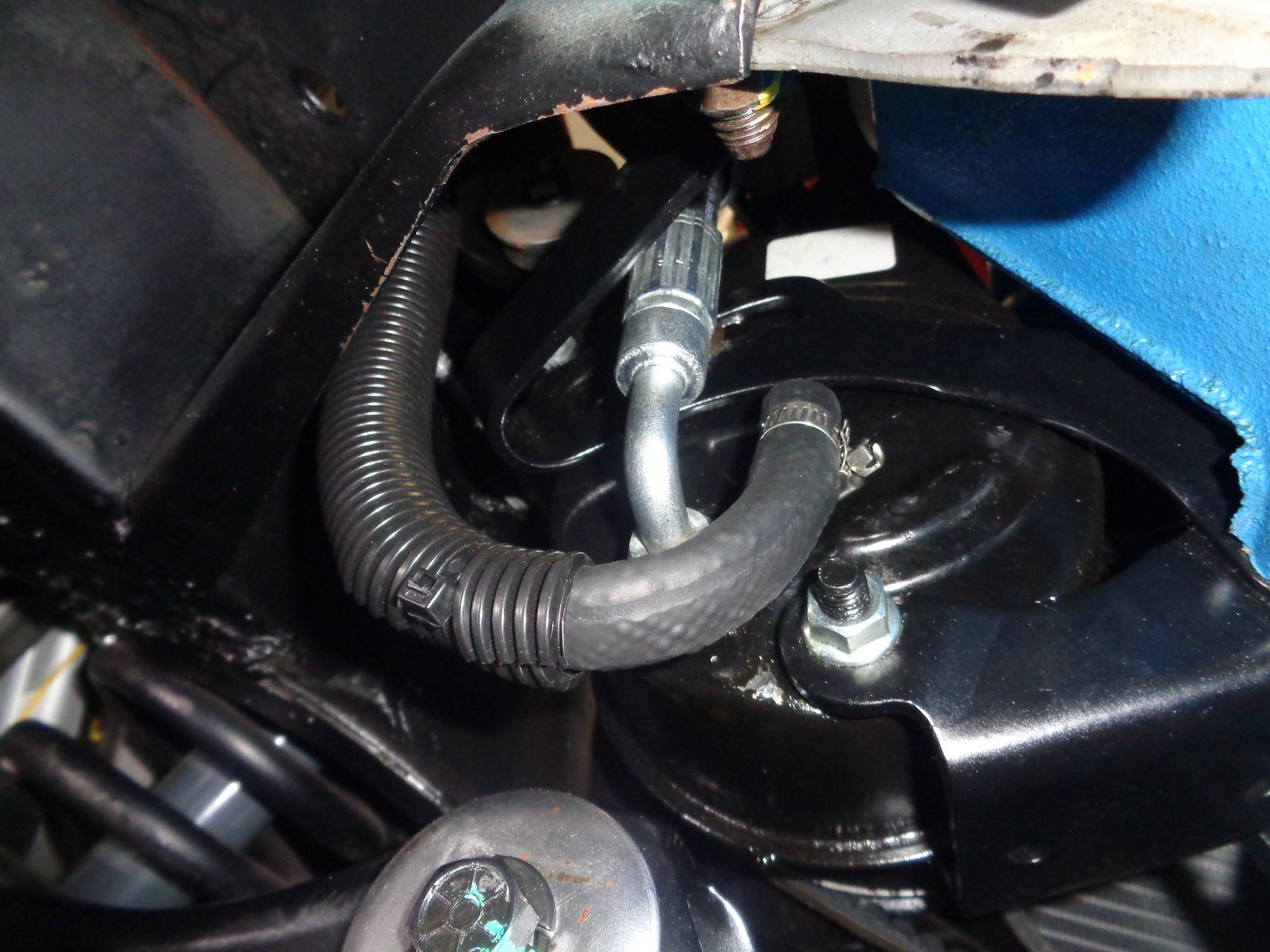

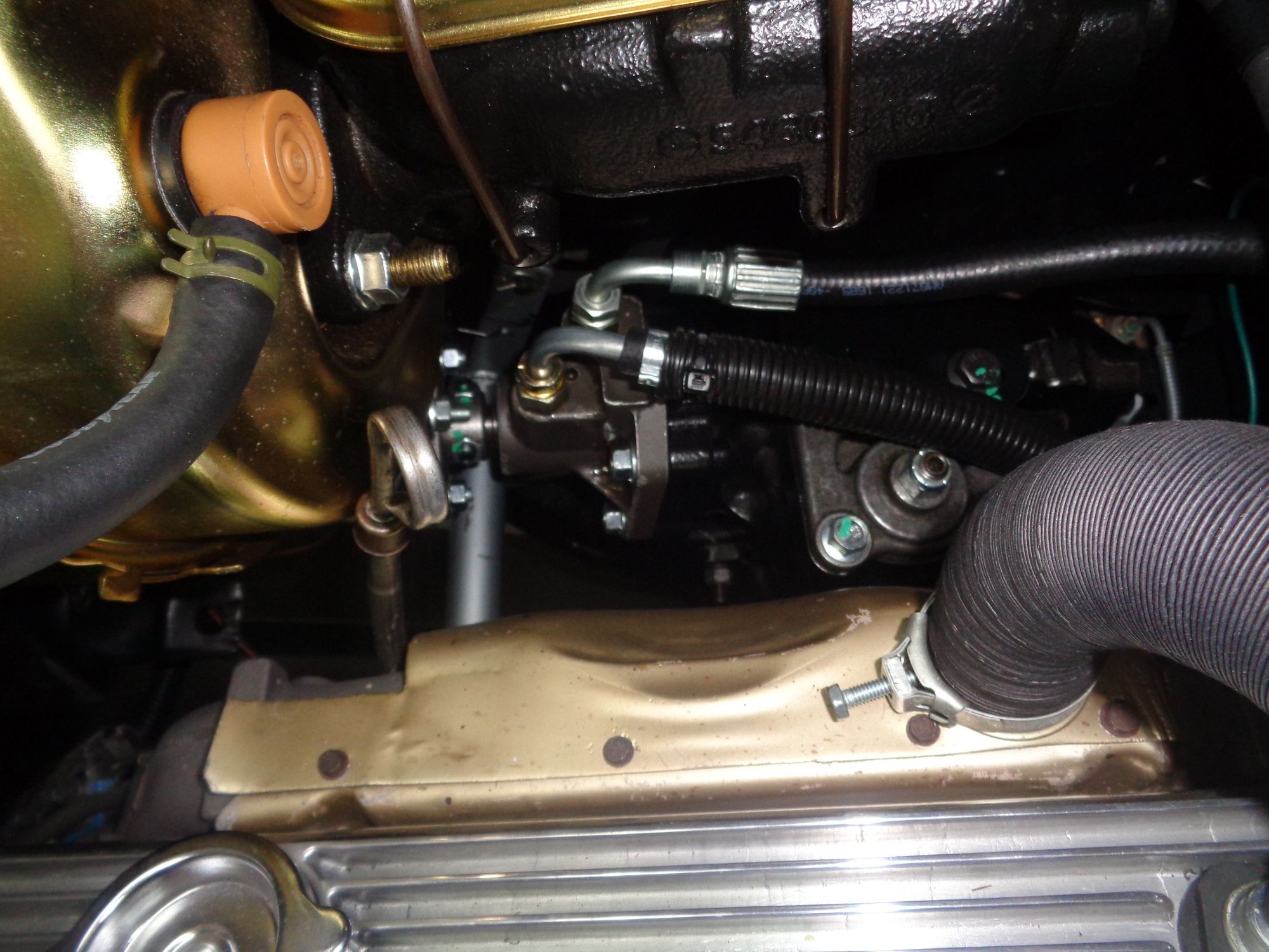

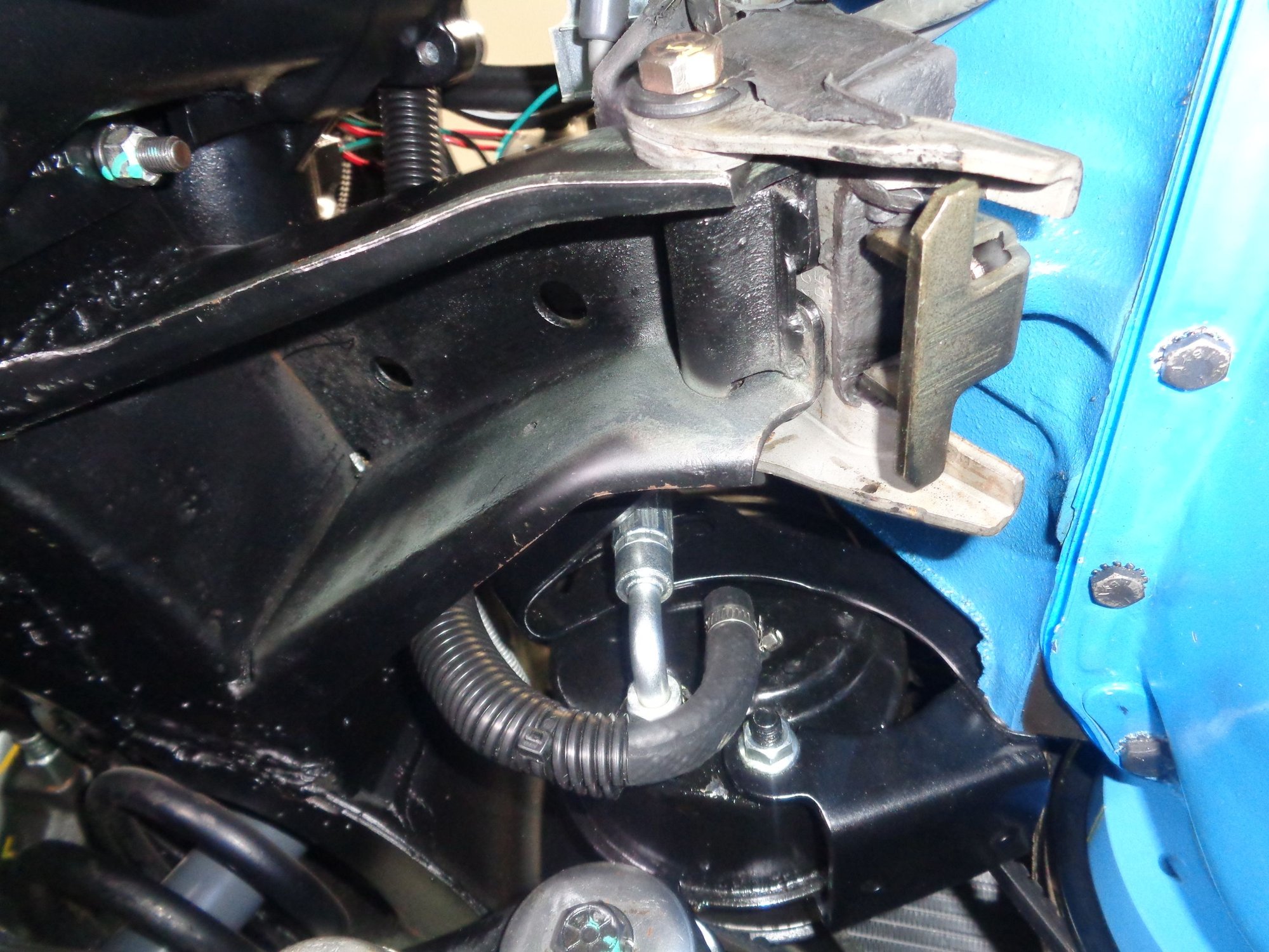

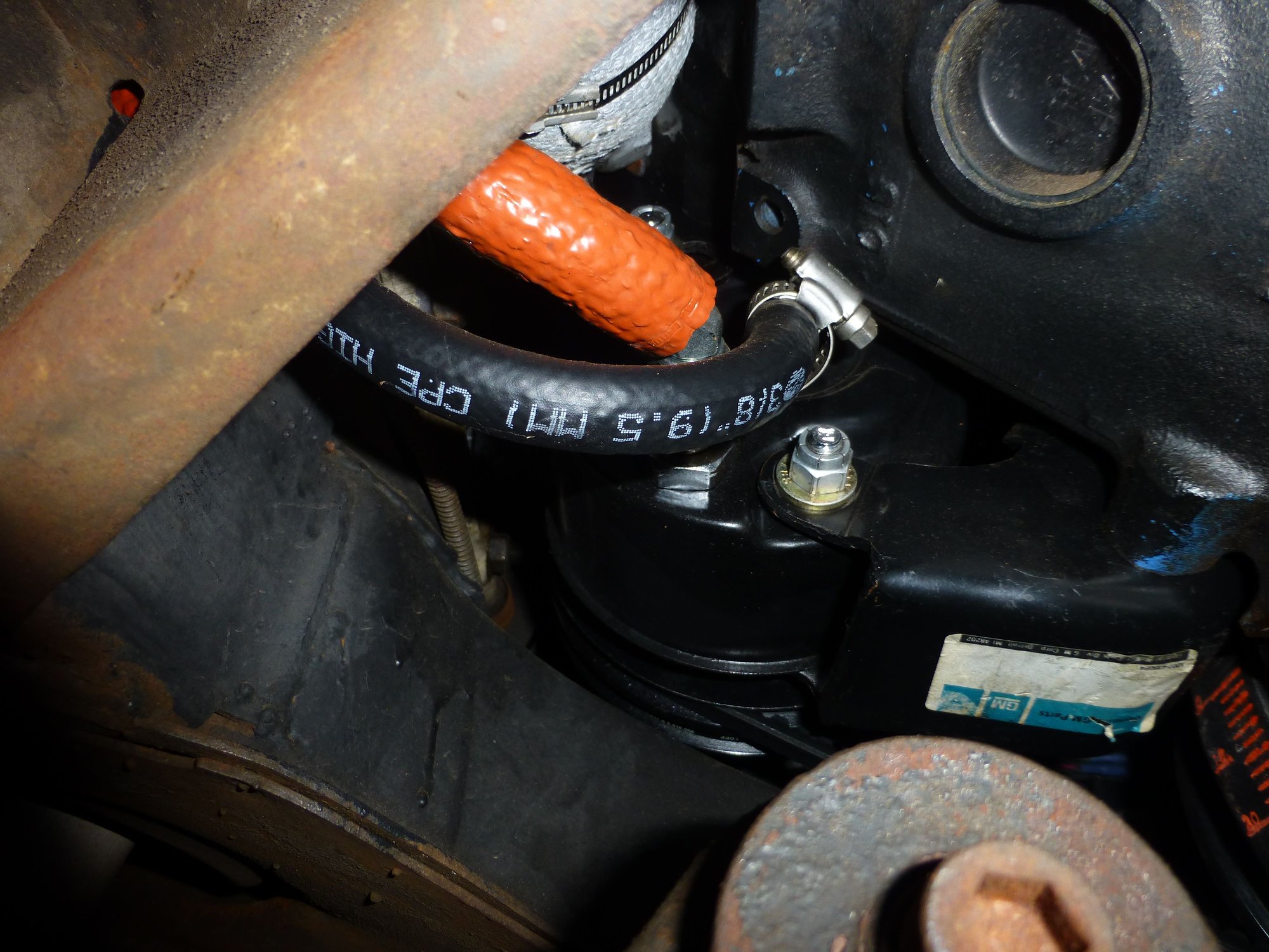

Put the hoses on before you install the engine. It will make it much easier. Have them facing forward. I opted for the adaptors to go from the o'ring seal to the inverted flare. I guess some have had leak issues pushing the tube seat into the steering box. I just started my up for the first time today and didn't have any leaks (that doesn't happen often!).

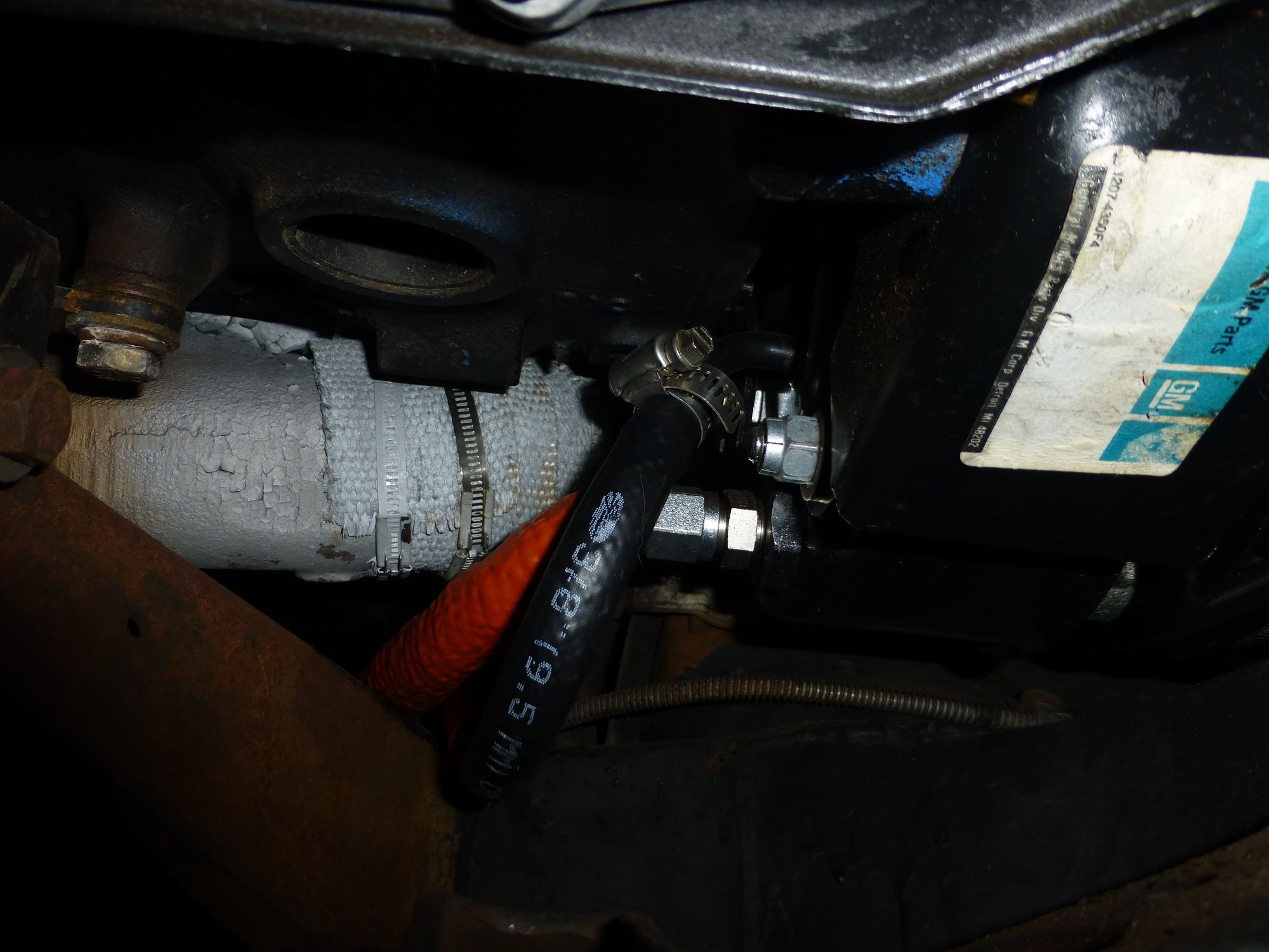

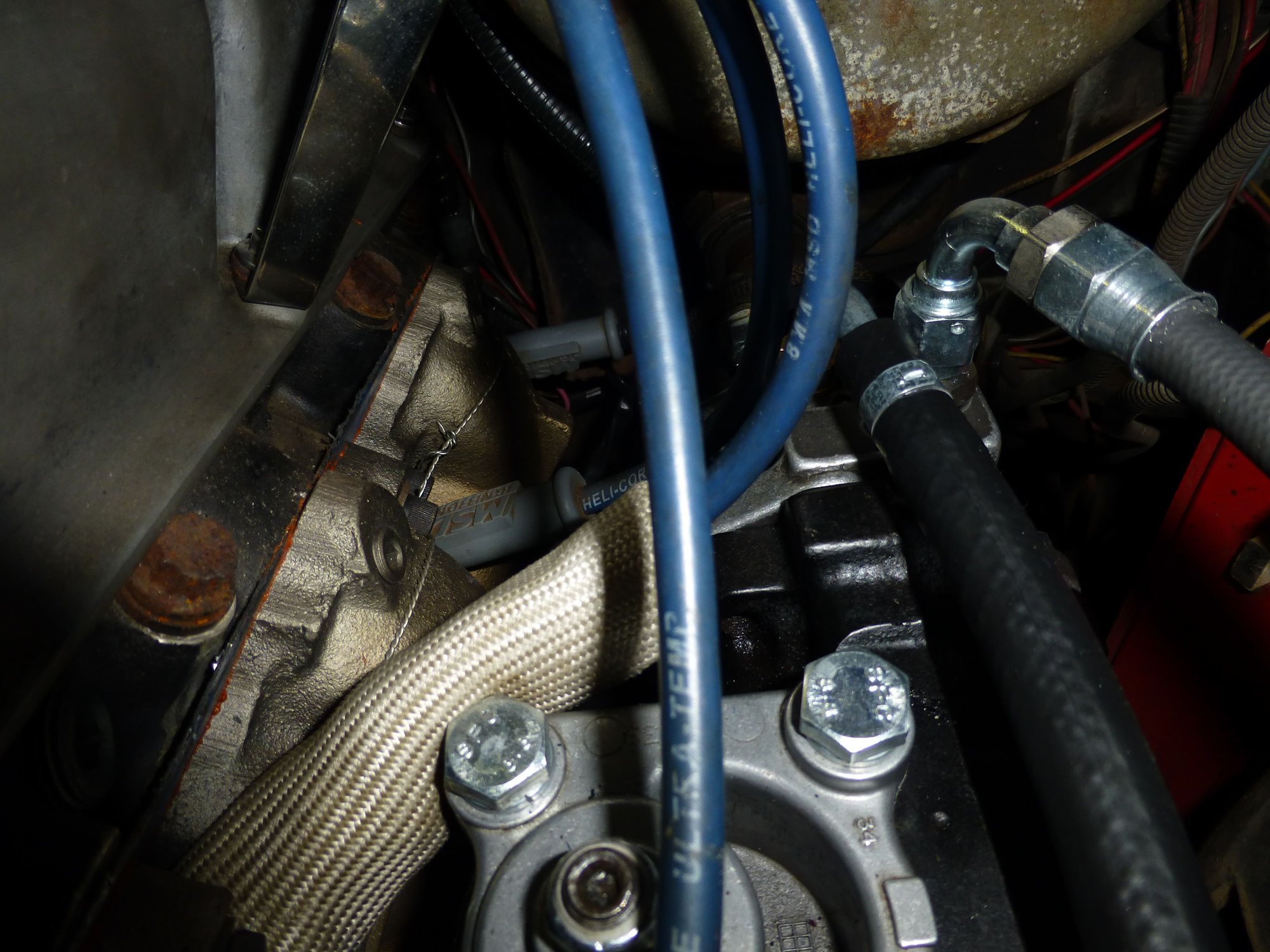

i am currently finishing up my borgeson conversion in my 73 today. I do wish i had seen this pic last weekend. Routing the lines has definitely been an issue for me, motor in car, headers, etc. The pressure line not so much, but the return line has been a b*tch for sure. I would love to see a bottom side pic to see how you routed the return line. In order to route mine without any sharp kinks i needed more length than what was provided with the kit. As for leaks, using the adaptors, the only issue i had was using the supplied return hose that come with the kit that goes into the box. Trying all 5 of the different adaptors i had on hand, no matter how tight i tightened the nut into the box, the tube was still loose. I finally tried using my oem return tube with the adaptors and it tightened perfectly. I noticed the oem was double flared as opposed to the one with the kit was only single flared. So, i cut the extra length off my oem tube, flared the end of it, and just used it. Did a couple of test cranks last nite to bleed and fill the system, and so far no leaks.
Personally, Borgeson went thru the trouble of pre-making these lines to specifically fit this kit in these cars.....I cannot understand why they did not just go ahead and use O-ring fittings on the box ends when they put the kits together? Right? or am i missing something?
If you have any pics from the bottom side of your installation that shows how you routed the return line to your pump, i'd love to see them. Thanks
EDIT****** so after looking at the pic again, i noticed you have used screw in adaptors, so, sorry. My kit came with the brass inserts that you just sit into the holes. I would have preferred the type adaptors you used, or again, just why didn't they use o-ring fittings.

I agree with you. The return line is too short. If the nipple on the pump came out horizontal instead of vertical down, it would be OK. You can see in my pictures, the hose just makes it without a kink. I covered the hose with some convolute tubing because the hose comes real close to rubbing in numerous places. I might do what you did and buy a longer hose.

i think I used some generic RockAuto return hose. 1970 Caprice 454, has a 3/8" steel tubing 90-degree end with 3/8" inverted flare fitting, requires that brass insert, hose cut to fit, Gates 361350, Edelman 70551, or equiv.

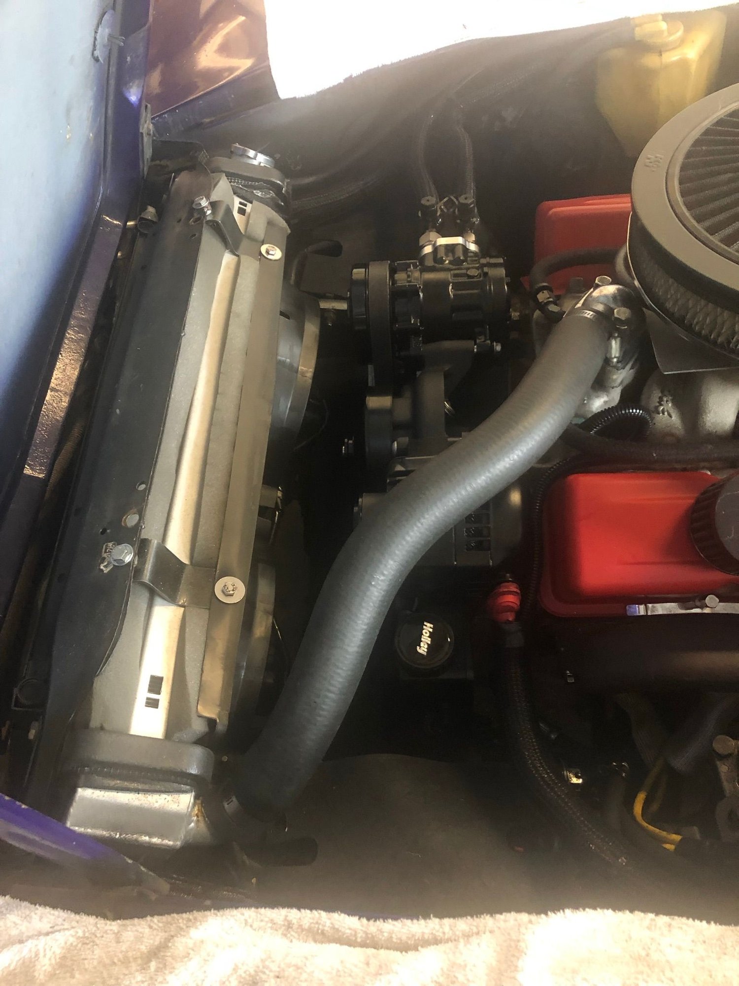

Borgeson box installed a while back . One of the best upgrades on the vette.Brace installed when they came out a few years later. Running a Holley Midmount Serpentine system ,the PS pump works perfectly with the box..
