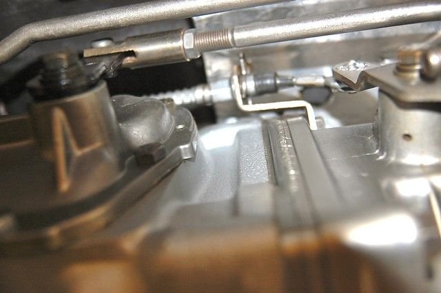

I swapped out the TH400 for an M20 about 2 years ago and have loved it, although MPG has risen.
Lately I've been having problems shifting into Reverse for shutdown and Key removal.

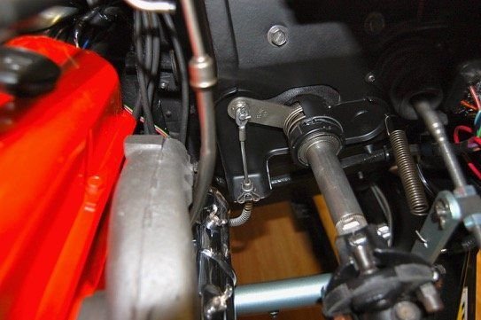

First it became harder and harder in finding Reverse. Once it did, no problem in Key rotation and removal from Ignition Switch. Now it won't shift into Reverse at all. I did stand up the frame and crawled under the car to inspect the Interlock Cable's attachment nuts at the Reverse Arm and the Cable's Guide Plate for any backing off or looseness. All looked fine to me.
From on top, the Steering Column's Lock Lever just does not want to be pushed up all the way up by the Interlock Cable from the Shifter. Something is not wanting the Tranny to go into Reverse Gear.
Should my next step be to undo the Interlock Cable at the top where it attaches to the Column's Lock, and would I be right in then assuming that IF I could easily shift into Reverse AND the Interlock Cable's end extends full up, the problem lies within the Steering Column (Key mechanism)?
Feel a bit stupid in asking since I've rebuilt this Tilt/Telescopic Column earlier, as well as a friend's standard Column, and learned much about them from The Shea Writings. But I'm wanting input for others.
Thanks much.
Steve

After disconnecting the Interlock Cable at it's upper end, I've found the Column's Interlock Lever to freely operate, indicating the shifting problem lies underneath with the connection or Transmission Shift Linkage.
Steve

My experience has been that the cable binds at the transmission end. These cables don't like to be pushed.
If you need to replace the cable, be sure to buy one like the original with the steel sheathing.
Also, if you pull the upper end of the cable with a pair of pliers, you should be able to pull the bind/loop out at the transmission end.

Problem resolved.
Found the Reverse Rod's length adjustment Nuts loose. Makes sense; was a gradual worsening of getting the Transmission into Reverse gear.
On another subject, had to adjust the Interlock Cable's virtual length by loosening the Steering Column's Firewall Support Nuts (interior side, studs marked Yellow) and rotating the Interlock Cable's attachment point DOWN (Green arrow), making the Ignition Key operation more free and easy while in Reverse.
