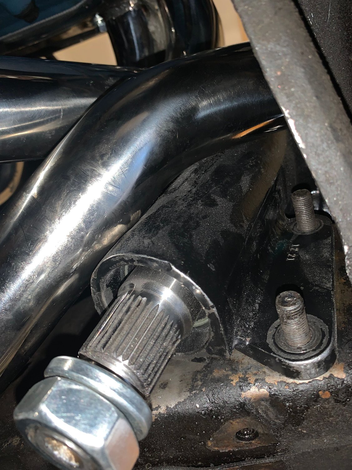

1980 vette 350 with doug's ss headers with side pipes, and borgeson steering. steering box has tab that conflicts with header. I can take the header back out and dimple, but does anyone know what purpose this tab serves? If it could be ground down 3/16" I would be good. Or has anyone had this same conflict?

If I had to guess, that tab was cast into the steering box housing to accommodate different mounting schemes. In a car with a different frame configuration, that tab would be drilled and tapped to accept a stud or bolt. I'm pretty sure the Borgeson folks modify the box to include the triangular mount for our cars. I'd give them a call/email to confirm, but if it was my car, I wouldn't hesitate to grind off that tab. But I'd ask Borgeson first.
Is that your only conflict? Can you post some photos of the box installed with the headers? This is a question that always comes up.

Thanks guys, yes only conflict so far, and I already have the driverside pipe installed, so I really don't want to take it back off. I was going to call borgeson, but feared a don't touch it or stance from them, but we'll see. I keep you posted and post pics when done.

update, borgeson said no worries chop it off. I'll post pics when it's done

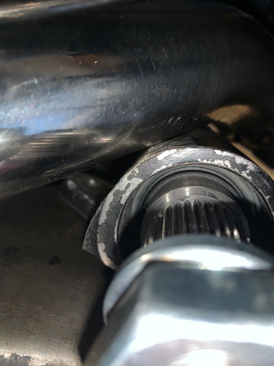

so ground it all smooth, it slips in but dead nuts tight on the pipe. Guess it’s heat it up and dimple. Ugh!

Put some exhaust wrap on the pipe right there AND dimple it.
