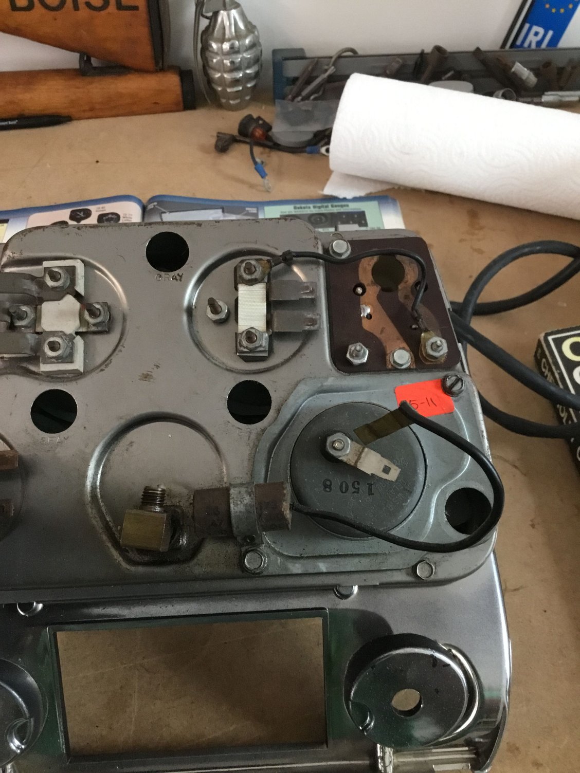

1968 gauge cluster. What does the capacitor between the clock and oil pressure gauge go to? Didn’t take enough picture when I took it apart.

Connects in with the clock power to stop radio POP when it trips

Could that be for the radio? There is a note in the FAM page,,,, 12 B6 ..... Connector "to radio capacitor"
To Capacitor ?
