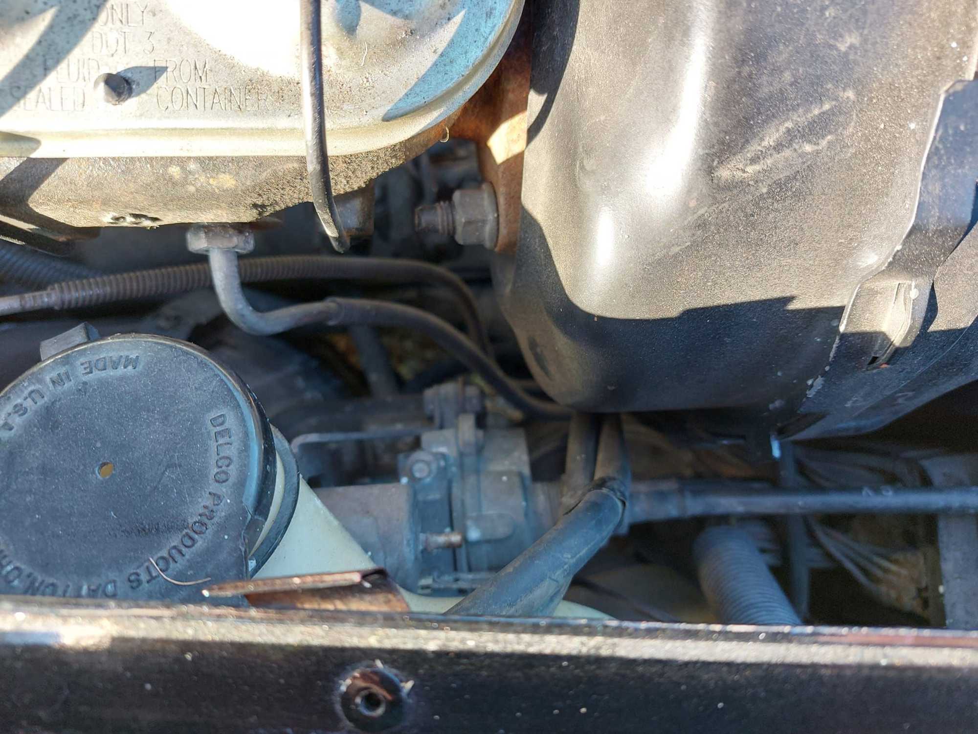

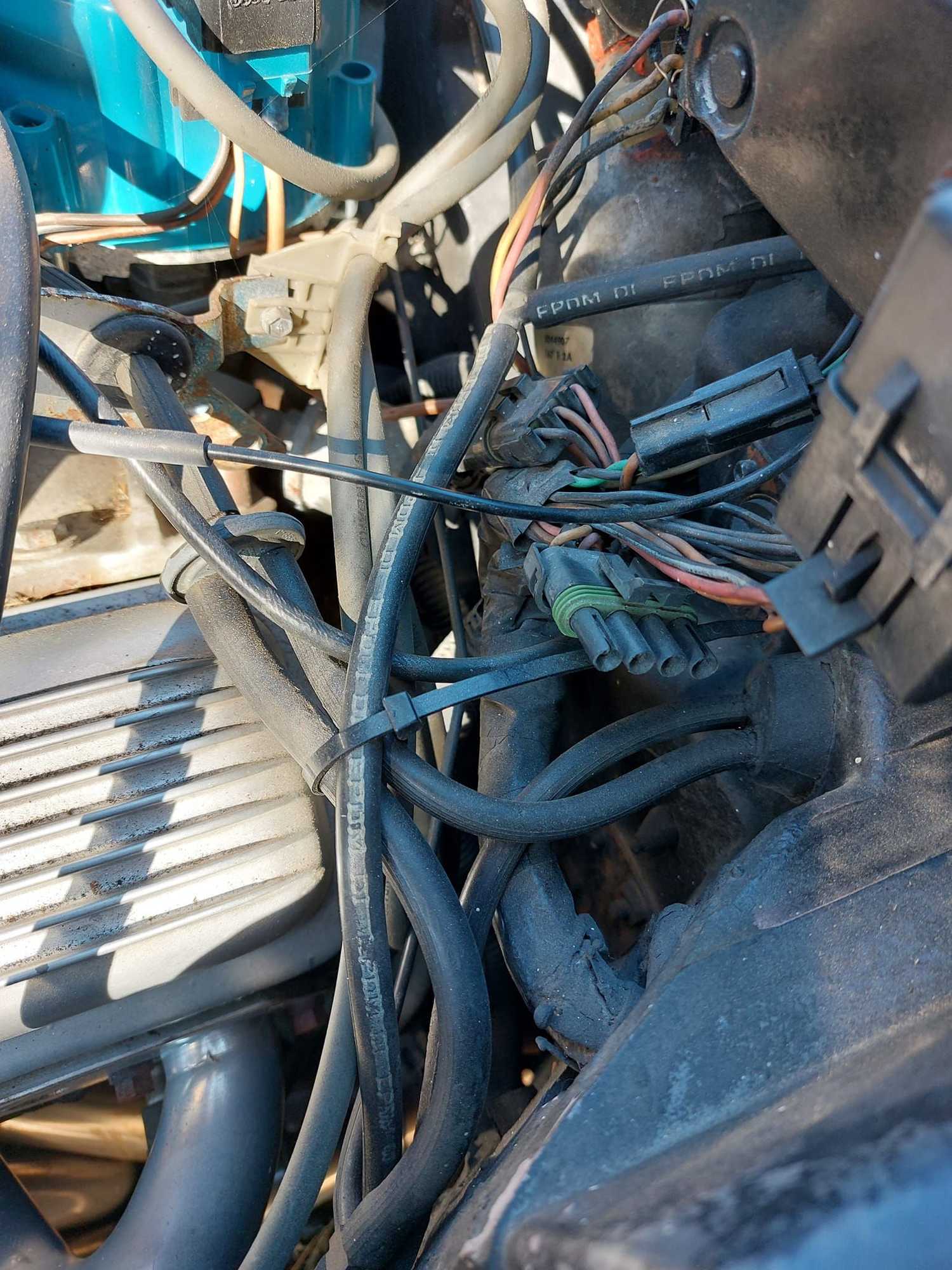

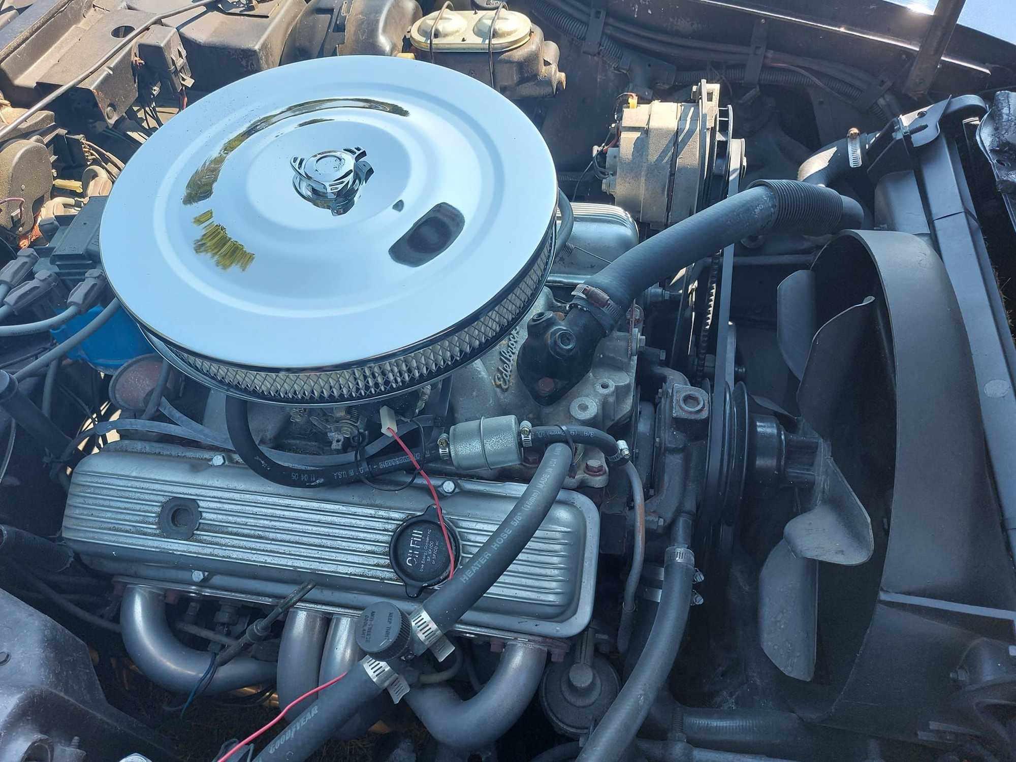

Forgive me if this weird to ask, I've only had this Corvette for about three months, I have got a lot done but I'm still learning about this car, yes I have googled but I have read so many different things it's a little confusing.The RPM gauge works great but the speedometer doesn't even move, some say it's a cable problem (25.00 bucks replace and thats it easy fix) some others say the whole dash needs to come off, I'm also asking because my other gauges are not working as well, I'm including a few pics as you can see, especially in the last pic there is wire adapter that should be plugged into what? Anyway, again forgive me if this is a silly question, but I had to ask.

Your 2nd photo shows the Cruise Control Transducer.
There are 2 cables.
The bottom cable is coming from your transmission
The top cable is going to your speedometer
If you remove the top cable from the transducer jack car up so wheels are off the ground, put in neutral have someone Rotate By Hand you should see FM square end rotate.
If that is rotating it is a good sign the speedo gear in the transmission and cable are good to the transducer.
As far as that unused connector plug it might have something to do with a replacement non computer controlled carburetor.
