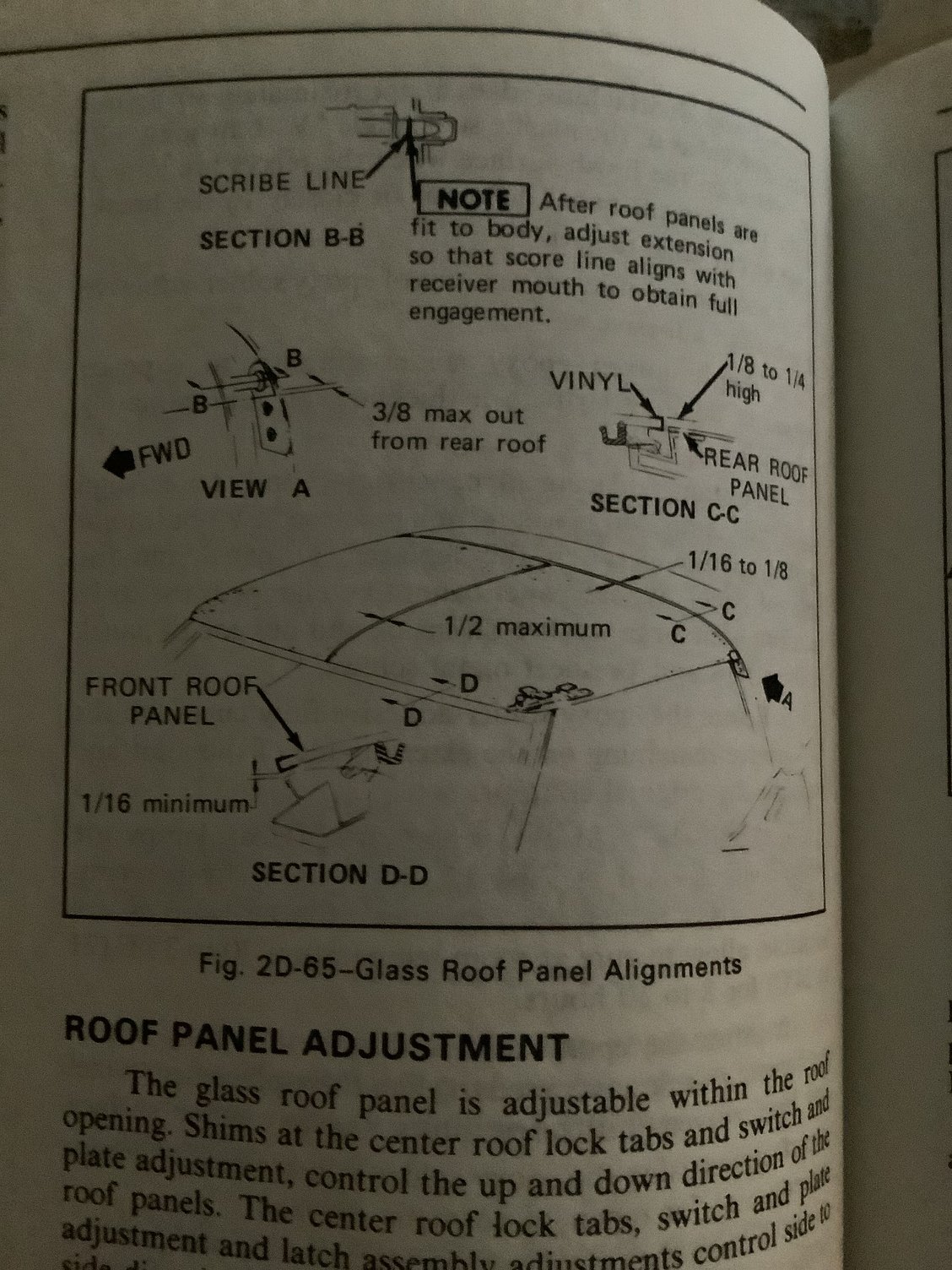

I hope eveyone had a pleasant and safe cruisin season. I know I did and hate to see it end. Ok so now for my question. Is there a way to adjust the rear of the t tops where it mounts into the mounting bracket. To make it sit more flush with the rear of the the roof line? The right side seems to be worse. Any input would be greatly appreciated. Thank you.

There is a little wobble room in the holes. There is a plate behind the fiberglass that the screws go into (careful, don't drop it down into the void of the pillar) and there's a little, not much, adjustment there.
Keep in mind that the roofs were never meant to be flush, they actually stick up more than you'd think at the rear

The glass roofs were supposed to sit 1/8" to 1/4" high at the rear, partly due to the increased thickness of the glass and then the rubber surround on the edge.

and pay attention to force needed to shut..
