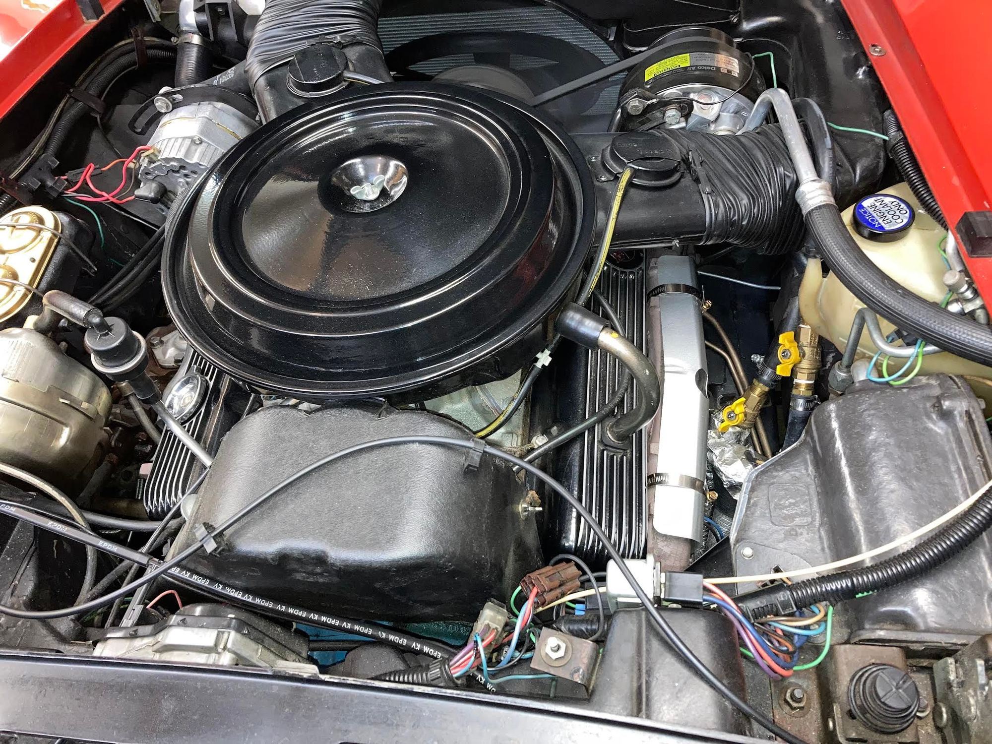

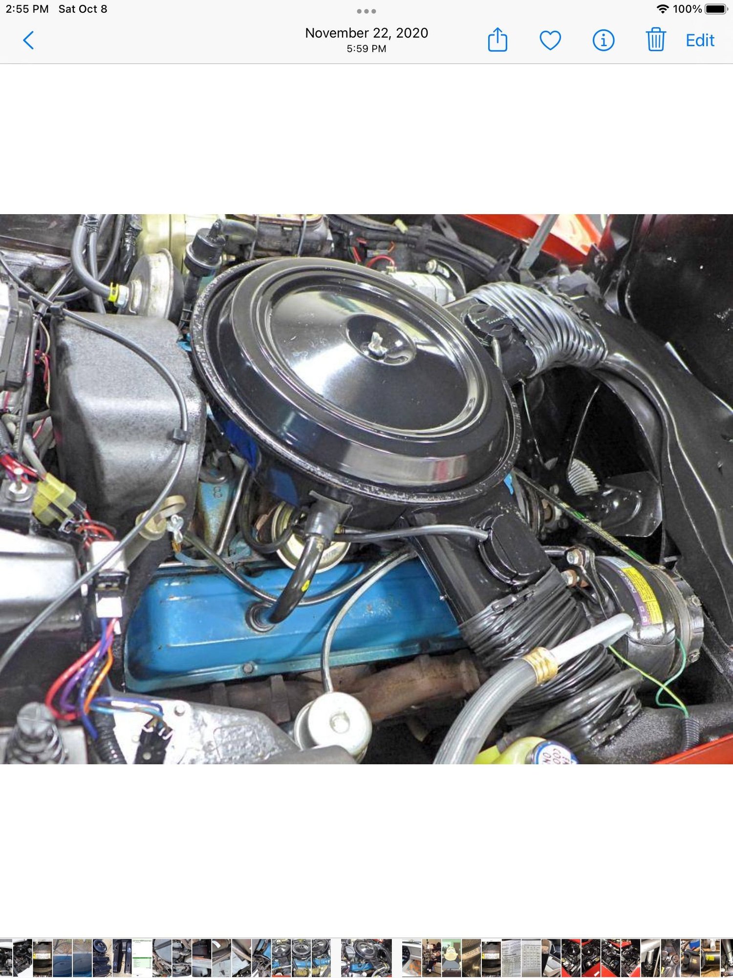

L82? Or regular engine
l82 were aluminum finned, regular steel stamped painted blue.
suggest this

We are both AACA members and the original stuff seems to be important. I personally like the chrome ones myself, but we are trying to do stock.
