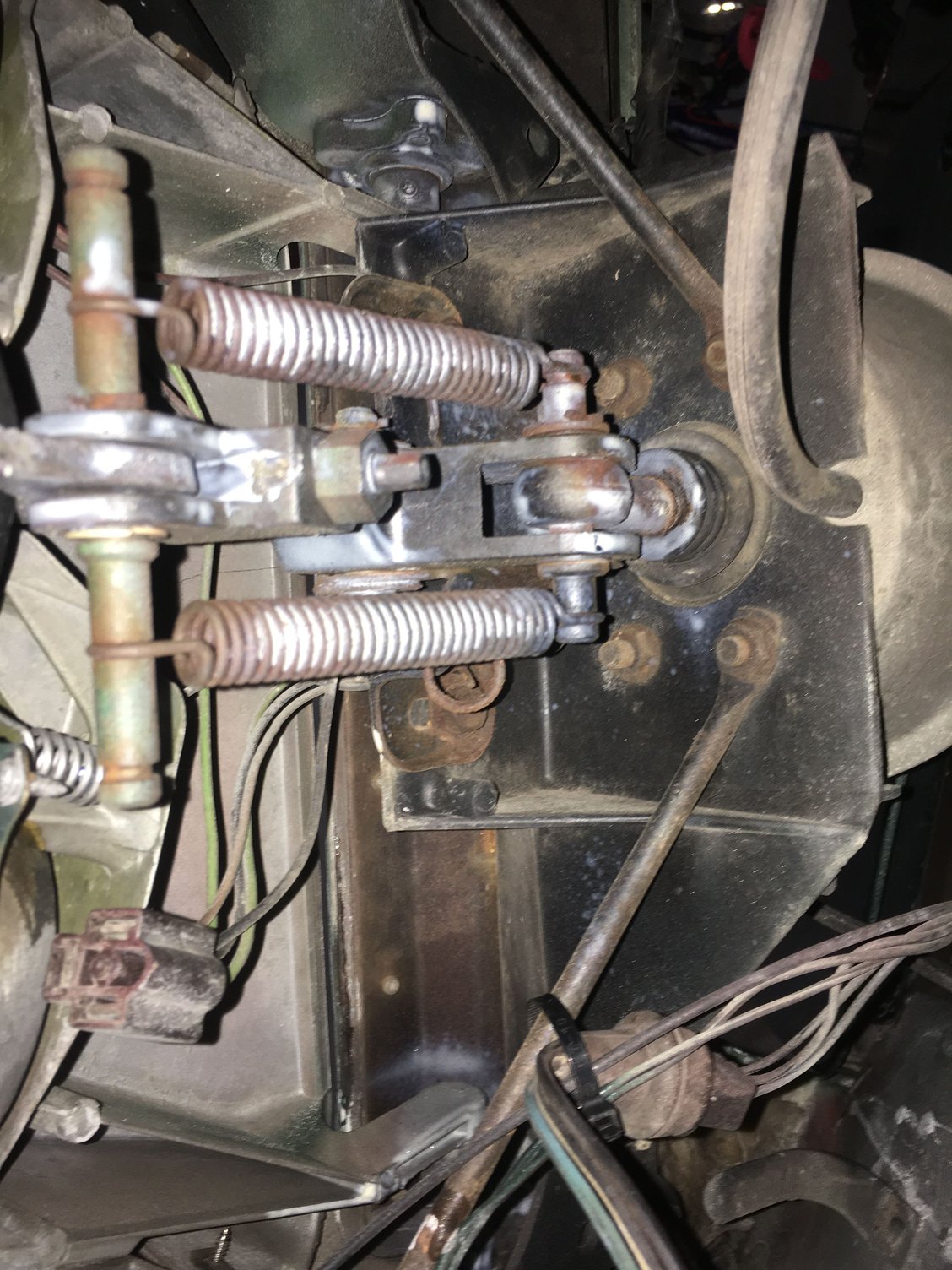

Still picking my way through my list of to-do’s and have set my sights on the Headlamp actuators, looking to recondition them.
Just crawled under the nose to inspect the actuator boots to judge if they had covered that when they “completely restored” my car and shocker, they are torn looking original to the car. I half expected that so I’m going to order the rebuild kit but I’m seeing broken springs. It looks the housing springs ??? And all 4 of them for both sides are broken. The remains of 3 of them still hand in place so at least there was that to tip me off about what’s wrong and where they go otherwise I might not have picked up on it. The headlamps do work without them. These are the housing springs right? The AIM exploded view is a little confusing. I’m going to look to see if there is an extensive rebuild kit available.

How loose is everything? If she’s sloppy I would order a rebuild kit similar to this. https://www.topflightautomotive.com/...UaAvvEEALw_wcB

Remember to spray/presoak all nuts/bolts for several days before trying to remove the assemblies...to avoid breaking the heads off the bolts
I’ve restored other cars, trucks and antique tractors so I’m quite familiar with rusted and scary ancient bolts.
My go-to for the really nightmare looking bolts is Kroil . The bolts on these don’t look too bad though.
Half of that top flight kit contains what I’ve already replaced, headlight adjusters and associated springs. The other half is exactly what I’ve got in my “cart” in my Zip Corvette account.
