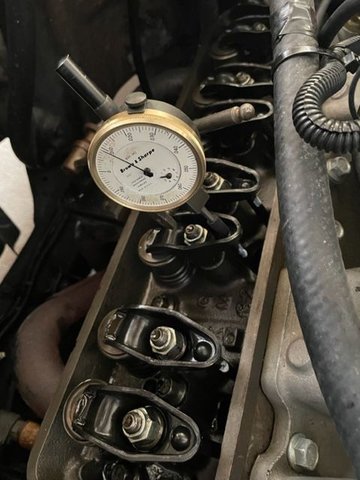

If the filter checks out OK then readjust the suspect valve the correct way, #2 exhaust rocker arm nut will probably be lower than the others, not a good sign but does not tell you what's wrong. I pull the plugs and spin the engine with a large ratchet on the harmonic balancer nut. Then I would measure the cam lobe lift as mentioned above and also check the valve in the other cylinders of that bank to see how they compare(see Pic below). Remember intake and exhaust have different lift values so make sure you are checking the exhaust valves...If #2 is significantly less than the others then its time to get the wrenches out, most likely the cam. If #2 is the same as the others but you have to crank the rocker nut down further to set lash then you have a shot at it being a lifter issue. Either way you have to fix it, just cranking it down until it stops making noise will lead to more trouble.
