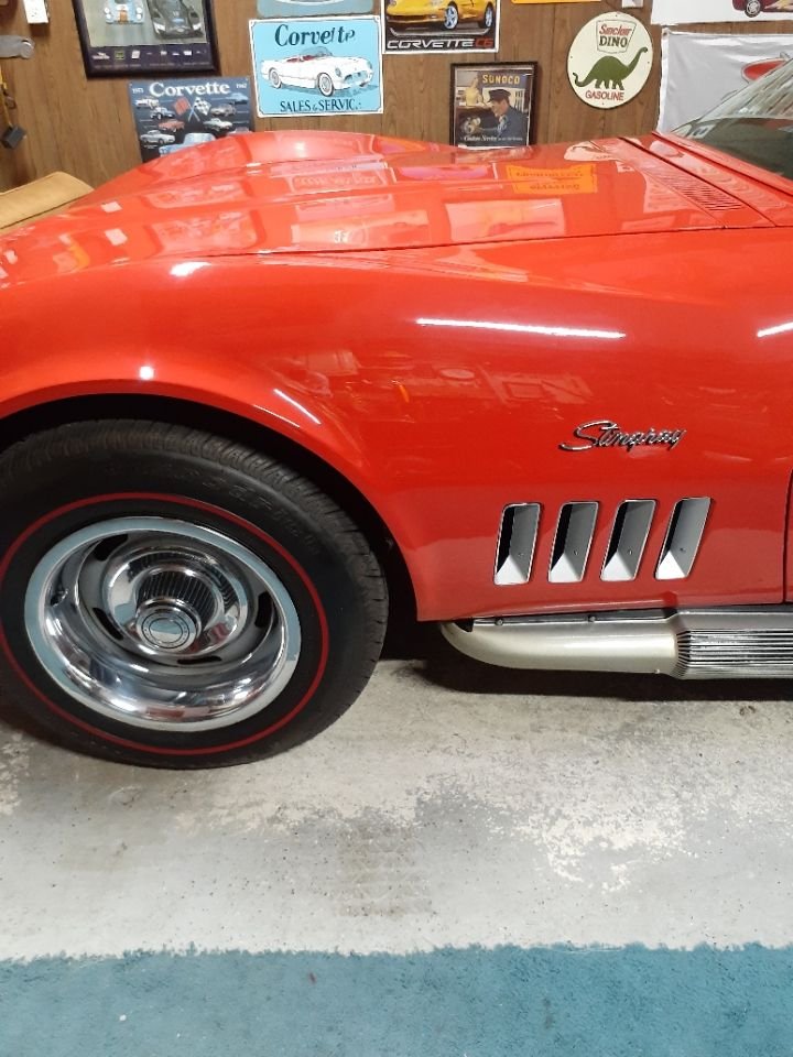

Or go with RED stripe tires .They look good on a red car and I believe RED stripe tires was a option in 72.

sw69vette , i really dont want to spend $1500 on red lines , i only drive the car a few hundred miles a year!!

I understand. It was a hard decision for me to make on buying RED lines but car came from factory with them.

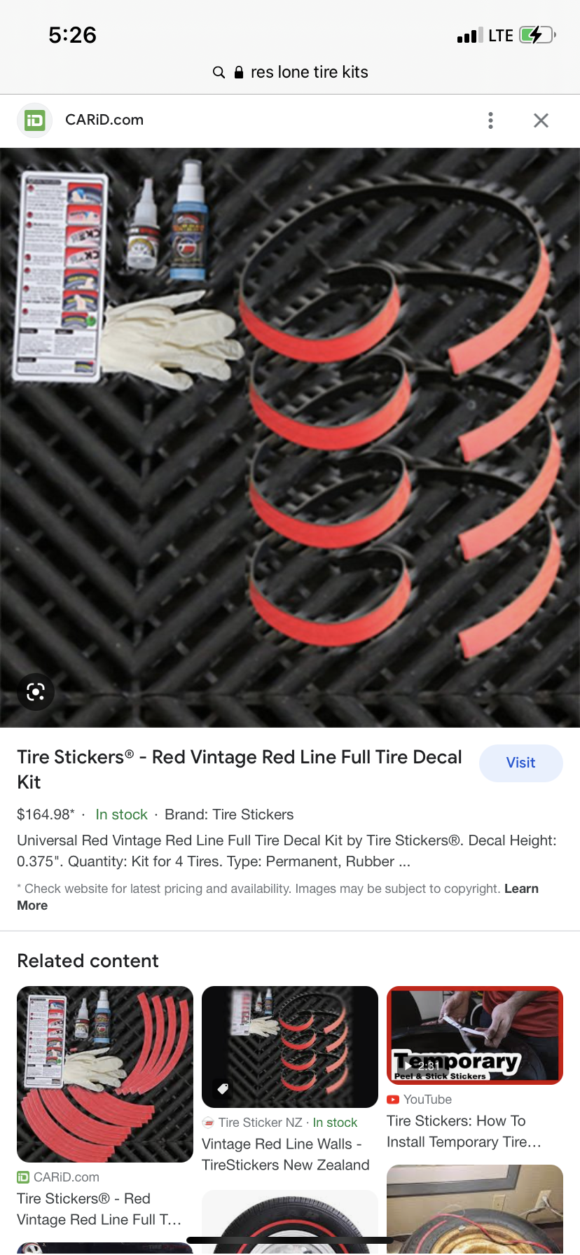

you could flip your tires and put a red line on them yourself they make kits

forman my tires are about 20 years old, if you want them you can have them!!
Old Oct 13, 2022 | 10:37 PM
forman's Avatar
forman
Joined: Mar 2010
Posts: 2,270
Likes: 375
From: Randolph nj
Naa that’s ok just trying to make it cheap
Old Oct 14, 2022 | 05:29 AM
Bills17n72's Avatar
Bills17n72
Joined: Sep 1999
Posts: 4,911
Likes: 698
From: grand rapids, lowell mi. area
forman , i was wondering how good them would work , thanks anyway!!
