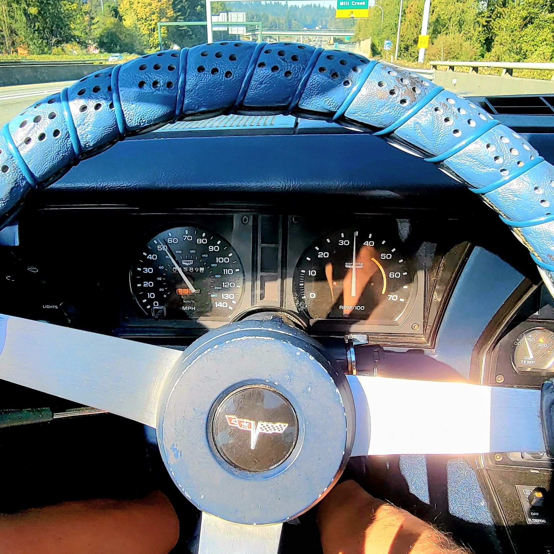

Through the magic of Amazon, I ordered a digital RPM reader and got it 2 hours later. I marked the harmonic balancer with white tape. My wife held the pedal at the below RPM the best she could (she's a keeper...)
Gauge idle of ~750, RPM meter reading 650.
Gauge 2,000 RPM = meter 1,320 RPM
Gauge 3,000 RPM = meter 1,925 RPM
Gauge 3,500 RPM = meter 2,250 RPM
Y'all have been a great help, thank you! Looks like my attention needs to be on the gauge. So this issue was same with both HEI units, old and new.

try removing the radio suppression capacitor near the distributor to see if that effects the tach

I have a completely stock (so the old owner said) 1981 C3 with a 4 speed manual. Since day 1 of owning this car (1.5 yrs) it has always been high strung on the freeway. I replaced the carb and manifold with simple Edelbrock parts and installed an Accel ignition - the car runs and shifts nicely.
However it runs at 3500rpm at 55 mph on the freeway. Yeah. It's not slipping, accelerates just fine. It has new 255/60- 15 rear tires. As far as I know it has the stock T10 transmission. The car hasn't been touched with stock motor, etc. Hard to imagine the 2 previous owners would have changed just the rear end. This would be a helluva rear end ratio. I checked speedometer with GPS and it's accurate within a MPH too.
What the heck? I will jack the car up this week and try to figure this out. 4th gear should be 1:1, right?
Thanks! - Jack

Time for a new tach board or whole new tach!
I had a similar "reading high" issue like you have. I tried taking the tach filter out of the circuit and it didn't help. I tried a new tach circuit board and it didn't help either. I bought a new tach assembly from Zip and that solved the issue. If the filter doesn't change anything for you, then its the board or the tach's movement. I'd buy a new whole tach assembly. You could take the board off the new tach and put it on the original and see if that helps, if not, put the new board back on the new tach and just install the whole thing. Tach's are ridiculously easy to change out on 78-82 cars.
