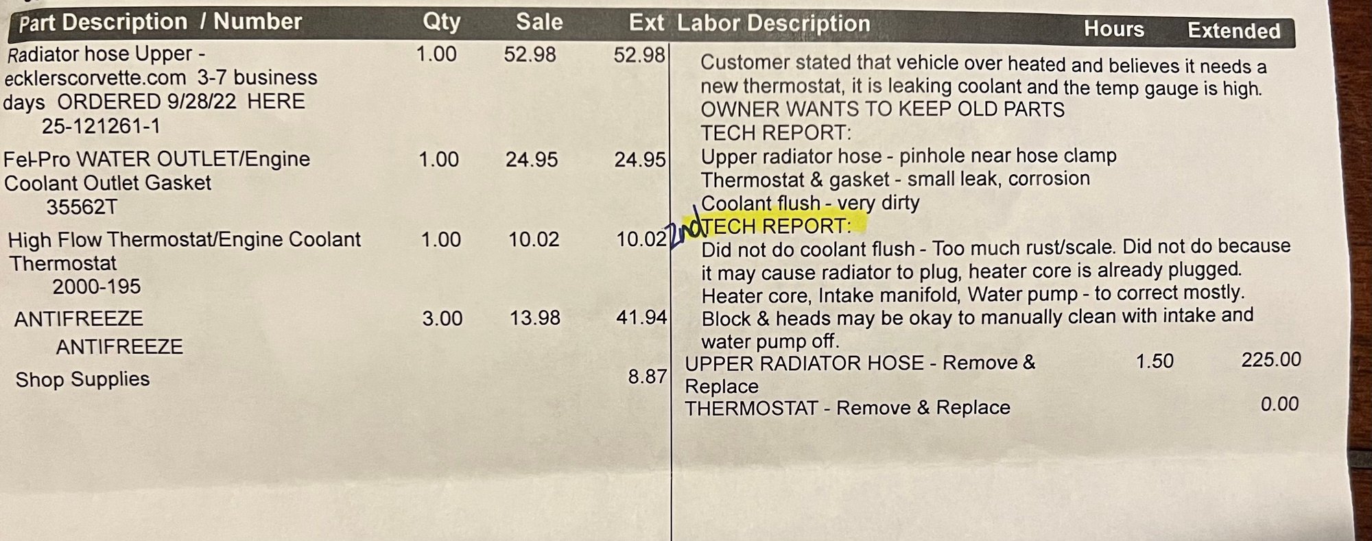

I recently took my '77 into the shop after it was overheating and spitting coolant expecting to replace the thermostat. After replacing the thermostat & gasket, they opted to not do a coolant flush due to too much rust & scale, and doing a flush would knock this loose and cause further issues. They also shared the heater core is already plugged.
Looking for advise on what's the best next step. Should I wait for issues to occur, or look for a shop that could tackle helping clear this up? Am I risking further damage by continuing to drive?
Thanks in advance for any help.

Take a look at @interpon's image. You might be better off with a new radiator.
But you should still flush the old coolant out of the engine. There are two drain plugs on the block below the heads that can be removed. It's a lot easier with the exhaust manifolds removed, but you should still be able to get to them. Be ready with a bucket, and perhaps a screwdriver to punch through the crud and get the flow started.

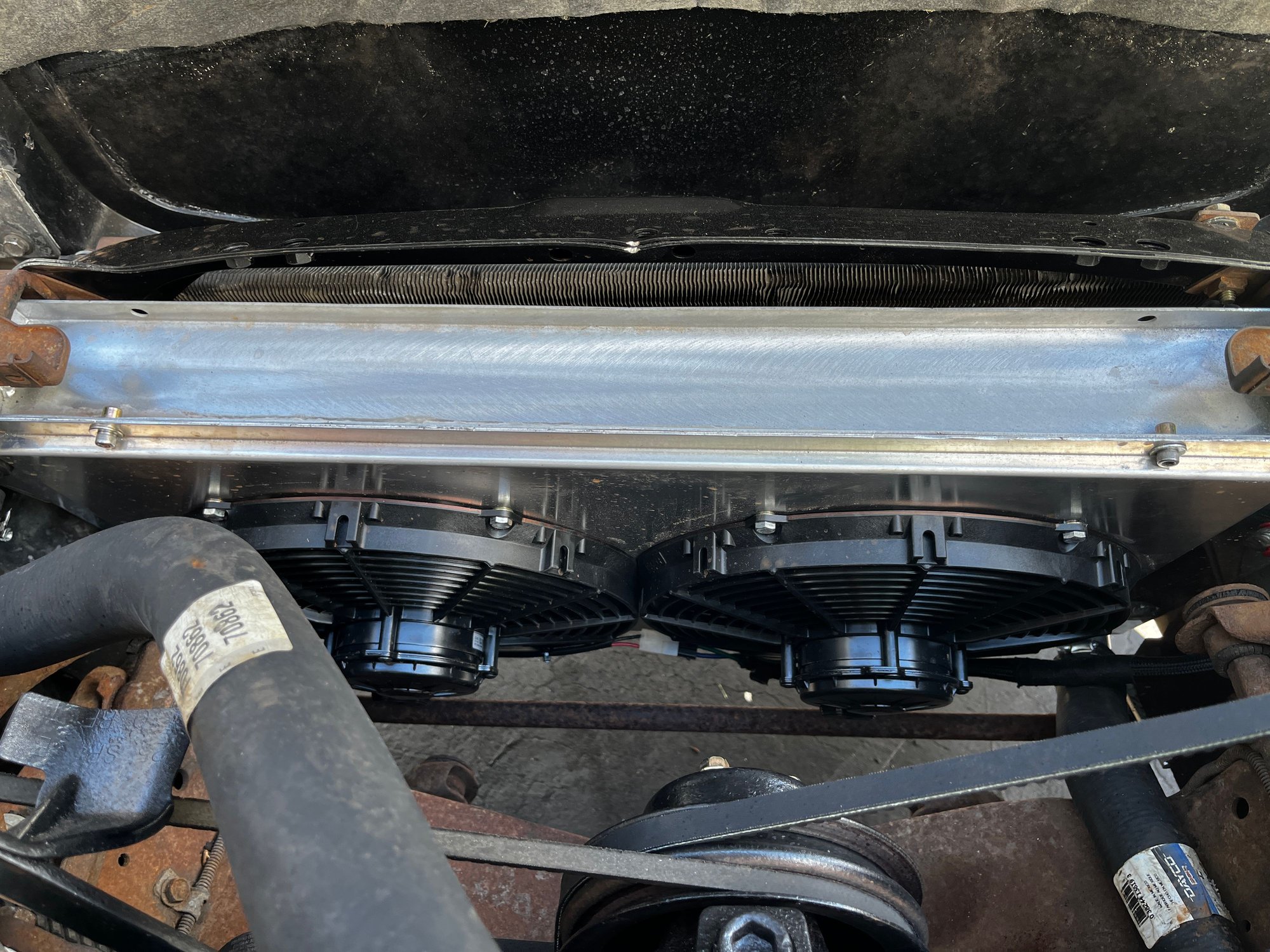

I just went through the same thing last month. Replaced the water pump and then found out that the radiator was shot. I decided to replace it with a 4 core "Champion" aluminum with dual 12" electric fans. Yes it was expensive, and yes it is, what some will say, "overkill", but I guarantee that I wont have any overheating problems and wont get stuck on the side of the road with any radiator problems...... The rest of the car is a different story.
