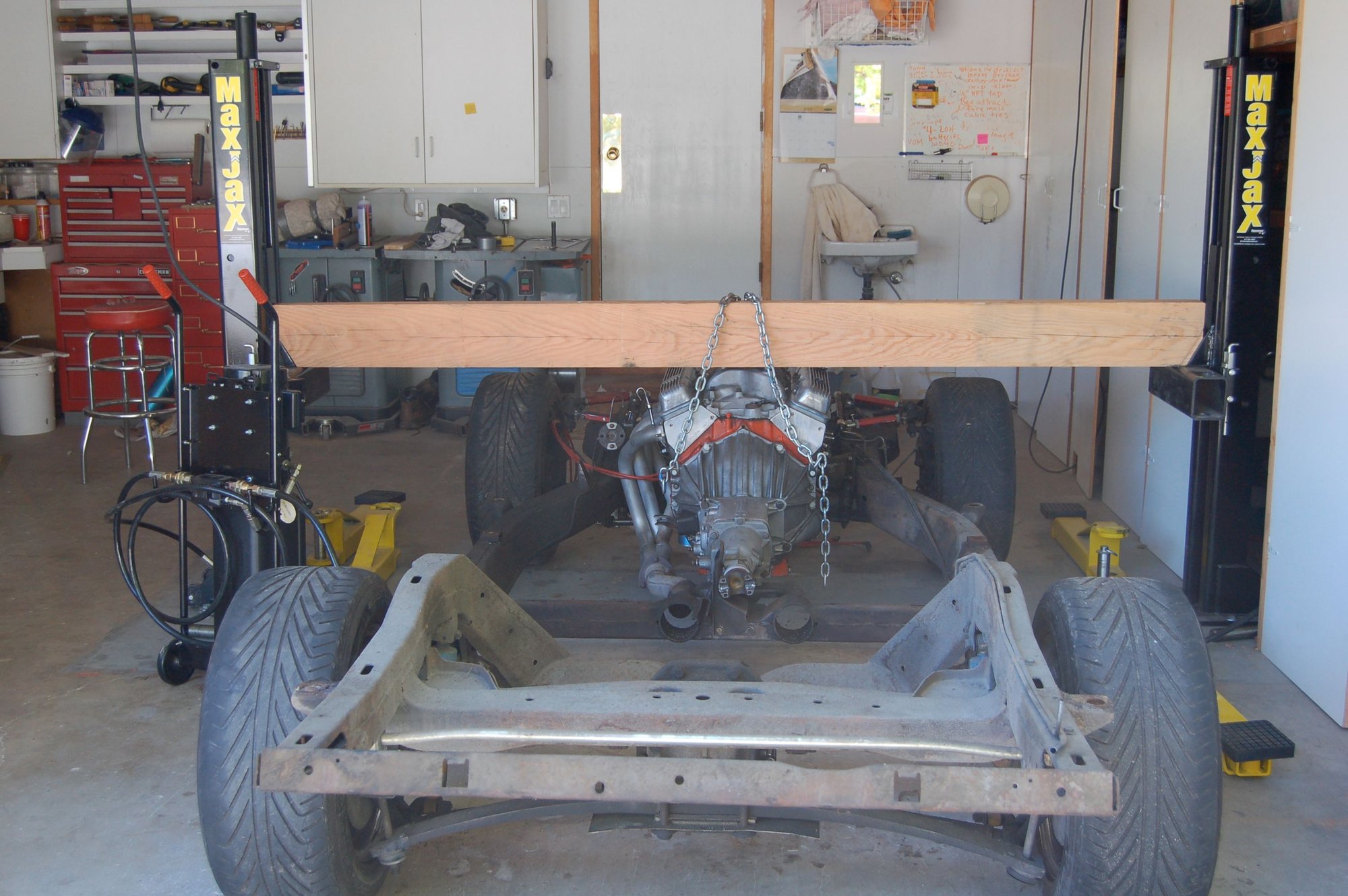

So finally someone has mentioned MaxJax. Like OldCarBum I had to improve my 50 year old cracking garage floor. At the end of the day, you can just unbolt the posts and store them off to the side. I have lots of pix from deconstructing my car, but I'll show this one. Try this with a QuickJack! I generally leave the passenger side lift in place as it is out of the way.

Same with the Triumph C7000 but it doesn't included wheels. I use a hand truck to move them to the wall. All the fittings are quick release too.

I have a friend with a Max Jax 2 post lift that has gotten almost constant use for about 10 years. He just recently had a seal leak but other than that he’s had all kinds of vehicles on it without issue.
