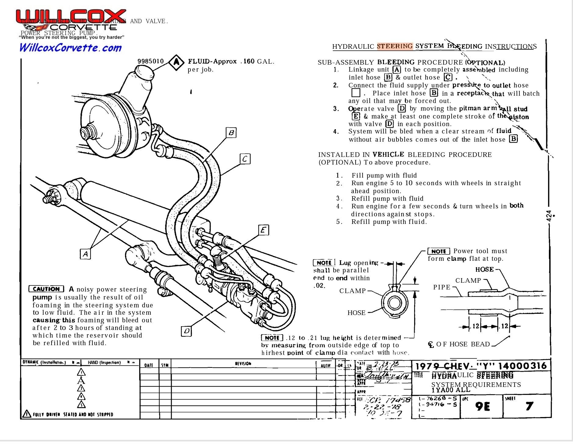

example of aim below for a 79..but directions should be same..sponsors sell..
