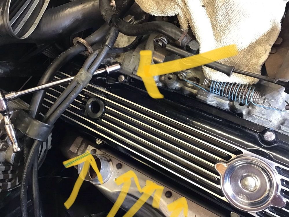

Drivers side look easy. Passengers side look to me like I will have to remove this (whatever it is)? What's in these hoses, coolant, air?
Old Nov 13, 2022 | 01:54 PM

air diver valve
airpump system

Just found out it's air. That will make it a lot easier not having to deal with coolant.

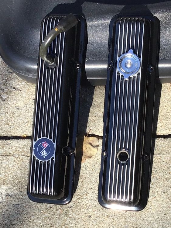

Originally Posted by interpon
1628 fel pro here too…no sealant..but needed longer bolts..stud time?
uh oh while there..time to refurb cvers
https://www.corvetteforum.com/forums...ification.html
Definitely going to clean and re paint them. How did you paint the accent color on the top of the ribs?

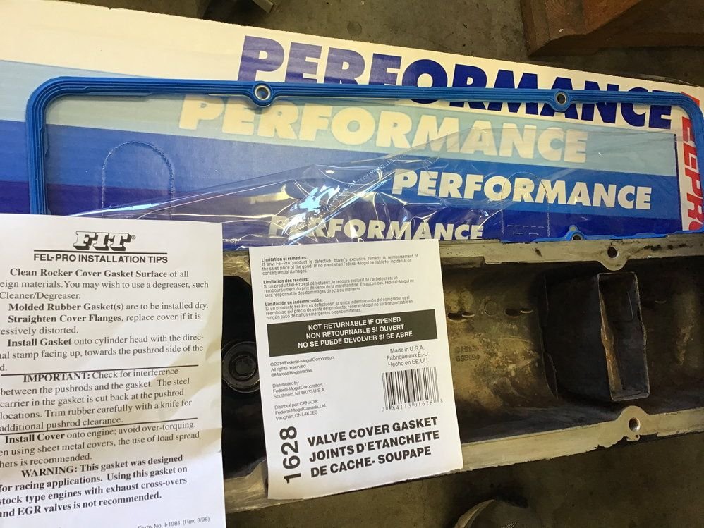

Also this is a pic of the gasket they sent me. Not sure why one side has two holes. I assume when I go to install one of them will be the right set of holes. We will see. Also, did you just tighten them till it felt right or use a torque number?

Powder coated then da sander on ribs..they are bare aluminum..i think i noted in thread
the gasket i used had a steel washer spacer so you could not over tighten..
i went snug light…
edit..in thread i used my new mini ratchet to snug down..almost impossible to over tighten

Somewhere during the years GM changed the valve covers from having the bolt hole from being exactly across from each other to the holes being offset so some gaskets have 2 holes to fit all valve gaskets.

Might be too late, but....First, I strongly suggest you use the blue 1628 Fel-Pro's, they have a steel core to prevent "over-compressing" the gasket, they Do Not leak, no sealer at all...they're re-usable and will last a long, long time! You will need longer bolts as mentioned above, personally I went to the local hardware store and bought allen headed stainless steel bolts, lock washers and flat washers....they really match the valve covers accenting the ribs and won't rust or need to be painted. As far as the rib tops being silver, around the '80 model C3 the valve covers went from aluminum to magnesium! On the magnesium covers the tops of ribs are painted, due to the fact that magnesium tends to turn dark quickly and doesn't retain its shine like aluminum....you'll want to take that into consideration when restoring the finish on your's! Good luck👍
Edit: to restore the finish, paint the tops of valve covers silver first (spray the whole top), after drying, tape the tops of the ribs with painters tape and trim with a razor blade or X-acto knife (will take some time). With rib tops covered spray your black, after the black sets-up a little start removing your masking tape very carefully with the tip of your blade to get it started lifting and finish peeling it off by hand!
