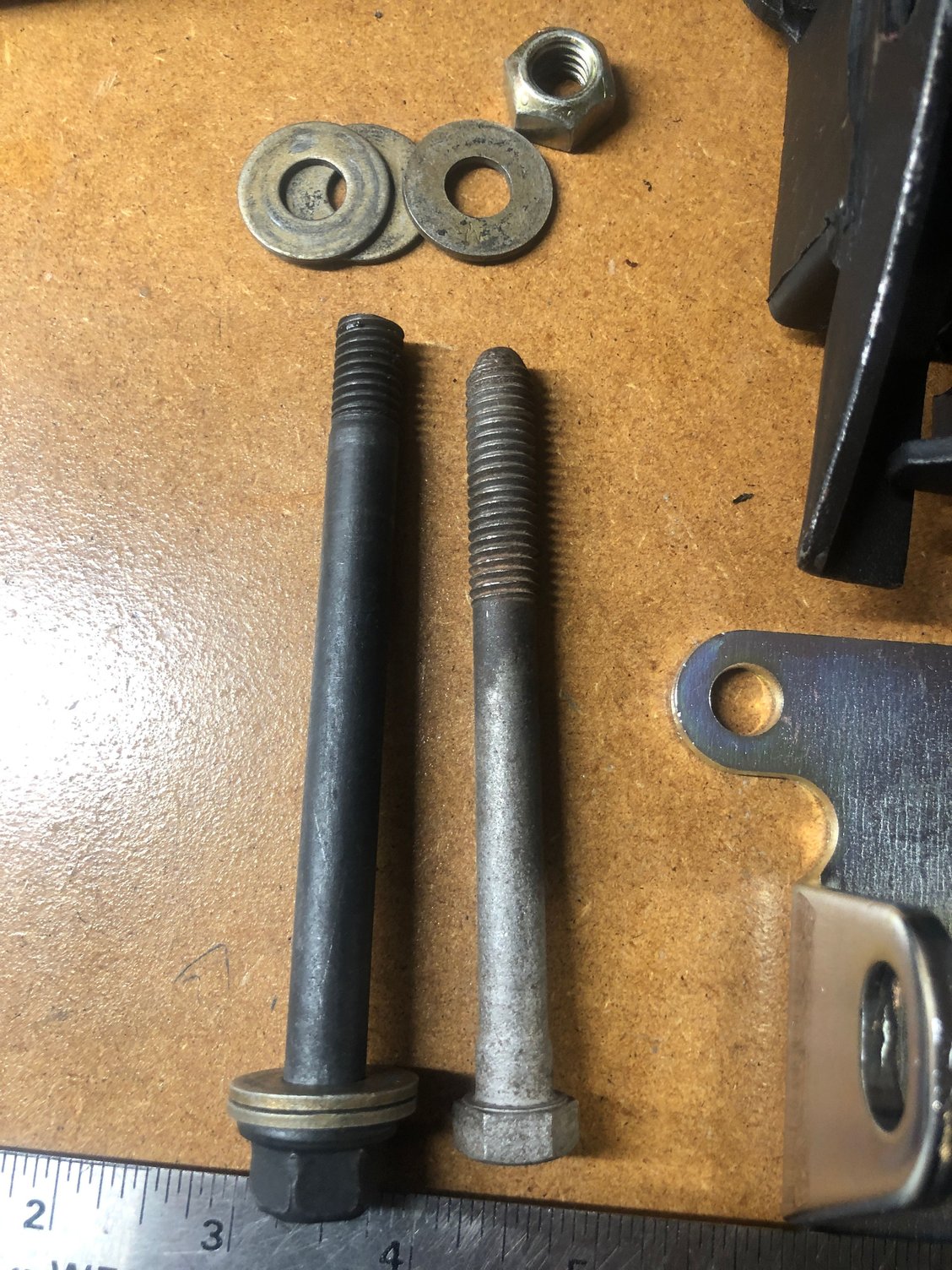

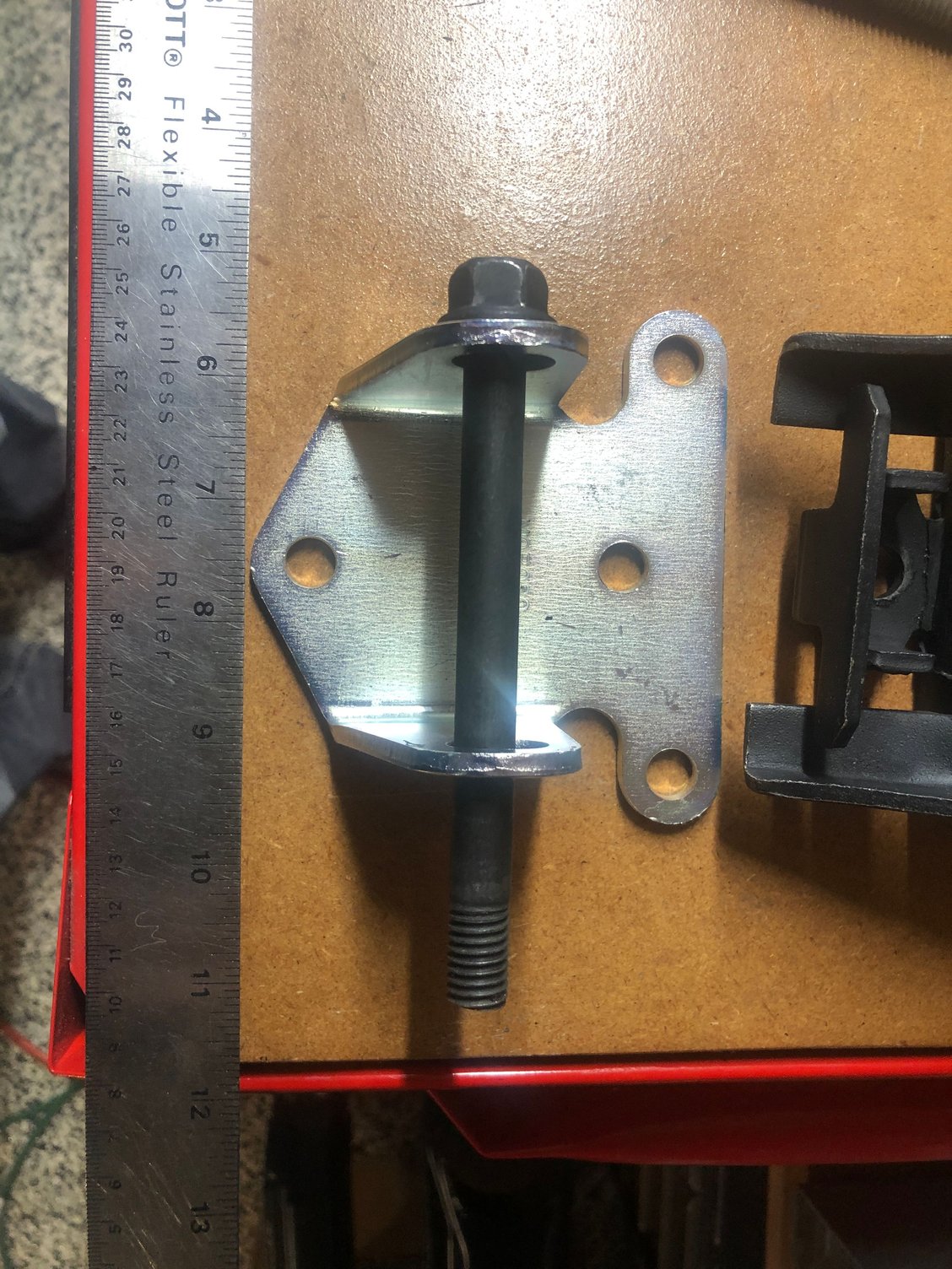

In a related question.....the solid mounts are narrower.....so the original engine mount bolt will be quite long, so do most of you just find a good Grade 8 bolt the correct length?. The width of the Moroso mounts is right at 3 inches. The other interesting thing is the diameters. Original engine mount bolts, and the ARP replacements have a small 1/2 diameter shoulder on the hex end of the bolt....then taper down to 7/16 inch diameter. The replacement bolts I used on my 77 were 1/2 diameter the whole way. Seems to me, given the bolts are in a shear load, they should be 1/2 diameter the whole way....AND the shank of the bolt should continue through both side of the engine mount....so in the case of Moroso solid mounts,.....seems like the correct bolt would be a Grade 8 bolt, 1/2 diameter....with a minimum 3 inch shank.....and then of course, enough threads for the nut. IN reality, with a washer under the head, and washer under the nut, the shank may need to be 3-1/4 inch, and then if necessary a few washers under the nut.
I suspect the smaller diameter is to accomodate the wide manufacturing tolerances.....which include the fact you have to line up the transmission, etc.
I just measured the height of the Corvette Central rubber mounts and the Moroso.....same exact height.

Hmmmm.....just realized another difference in these mounts. With factory style rubber mounts, the weight of the engine is sitting on the frame horn pads and all the bolts do is keep it from clocking from torque. Proof of that is that I can push the bolts in and out of the mounts with the engine sitting in the frame. With these Moroso mounts.....the weight of the engine is sitting on the bolts as there is no built in pad. So....to me, and I am not an engineer, that means the bolts have a shear load especially on these solid mounts. The entire weight of the engine is held up by the bolt shank....PLUS the clocking or torquing stresses from the engine trying to spin in the car. BUT....there is NO WAY in hell any torque on any SBC or BBC engine is going to shear a 7/16 bolt.....not going to happen.
.In any case it obviously works for the thousands and thousands of people who have used them.....WHATEVER the loads are. I know from airplane stuff I have done, bolts are capable of way more than they appear to be capable of. For me....if I use these solid mounts, I will find a full shank, 1/2 diameter bolts that runs the 1/2 diamater through BOTH lugs of the engine mount. That is the way we were trained in aircraft maintenance to select bolts, and how most are spec'd...if they are in shear. Having only one of the lugs supported by the threaded portion of a bolt is not good enough for me.
The other thing is true that the holes in both the mount and the frame horn are much larger than the bolt diameters......so at some point something has to come up hard against something to prevent rotation of the engine. I find it hard to believe tension on the bolt would produce enough friction to prevent that on a big torque motor.....but its probably a combination of both.....in any case no big deal.
This was not meant to start another bickering session.....I just wanted to know what bolts you guys use.....since you are saying that hundreds of thousands of people have used these mounts for years. But I will probably do it my way anyways.......thats the way I roll.

My car came with a failed driver side OEM mount. I used the stock bolts. They had enough thread to work with the Moroso mount. If that hadn't worked, I would have gone to whatever hardware store was closer, and bought a grade 8 bolt of the correct length. If you add a few washers to get the threaded section out of the shear zone, that would certainly be best practice, but I doubt it will matter.
Don't overthink it. You spent $18K on an engine that you'll run at half-throttle. Mount the engine, and go drive the car another 8000 miles.

I used 1/2 inch I believe grade 8 bolts all the way though and just enough shank to cover the mount so when it was torqued the mounts bottomed on each other and not the threads. The shank pretty much filled the hole and I would want sheer strength as much as tensile strength incase they loosened up.
