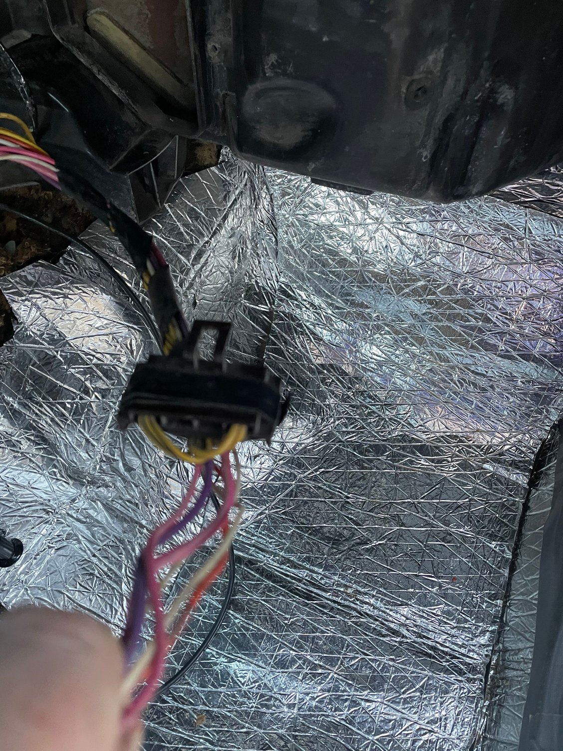

I found this connector in the upper right under the dash. One plug has 2 yellow wires and the other has 2 yellow w black stripe. It is right by flasher and near the courtesy light.

Not knowing the year of the car, is there an orange box nearby? Maybe courtesy light timer harness.

Oops sorry. 1974 coupe 350 auto with air, manual windows. No orange box

I believe there would be a warning buzzer for the seat belts plugged into that, came on when in gear type of thing

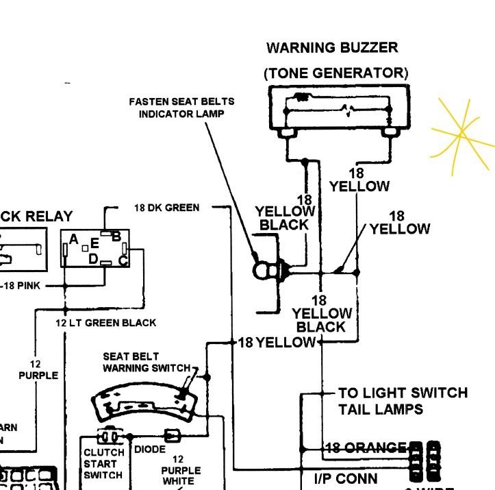

74 wiring diagram. GM seat belt starter interlock (manual transmission)
