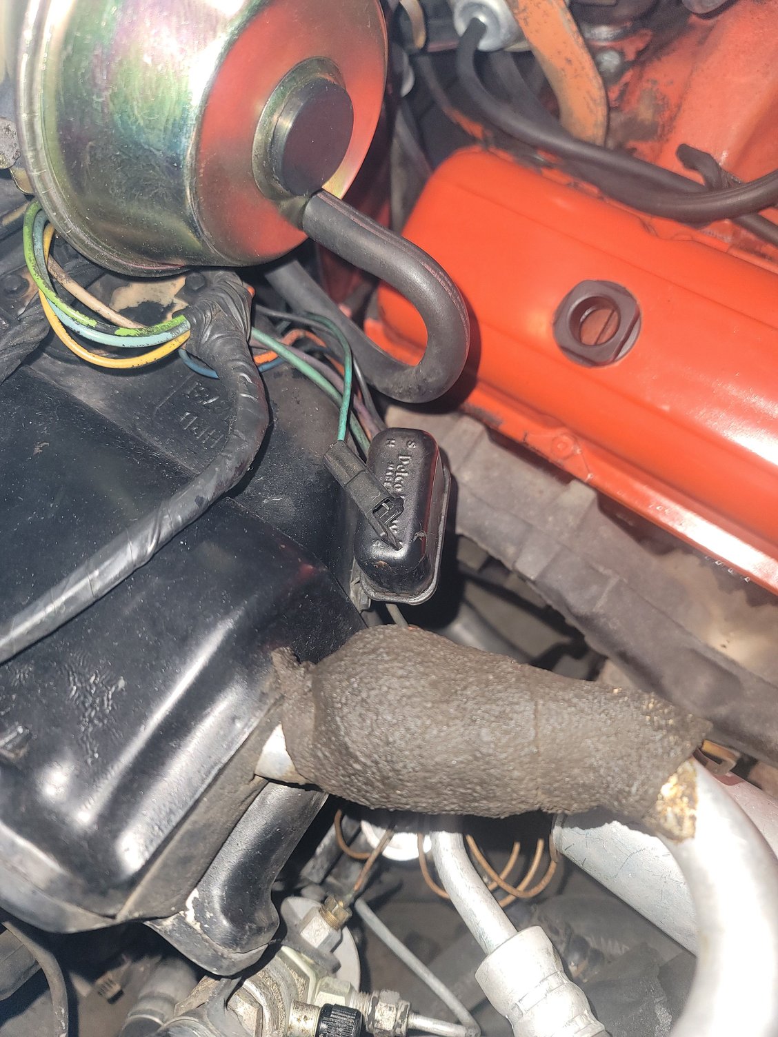

Found this green wire, origin unknown. I have not traced it back all the way yet, but it crosses back behind the distributor. it is a 1970 350/300HP auto with air. Has the solenoid on the intake for the distributor vacuum advance, forget what that is called, but has the connection on it like new. the only things I can think of that don't work on the car is the headlight warning light, but I think that is due to a broken wire I spotted at the switch. Seems to be a solid green wire, let me know what you think. I ordered a set of schematics, but maybe one of you already know what this is.
Thanks folks...

The headlight warning switch gets 2 wires so it's not that.
Does your water temp gauge work?

Goes to a temperature sender on the cylinder head between the last 2 spark plugs there is a short harness that you need that plugs into the green wire that is missing
