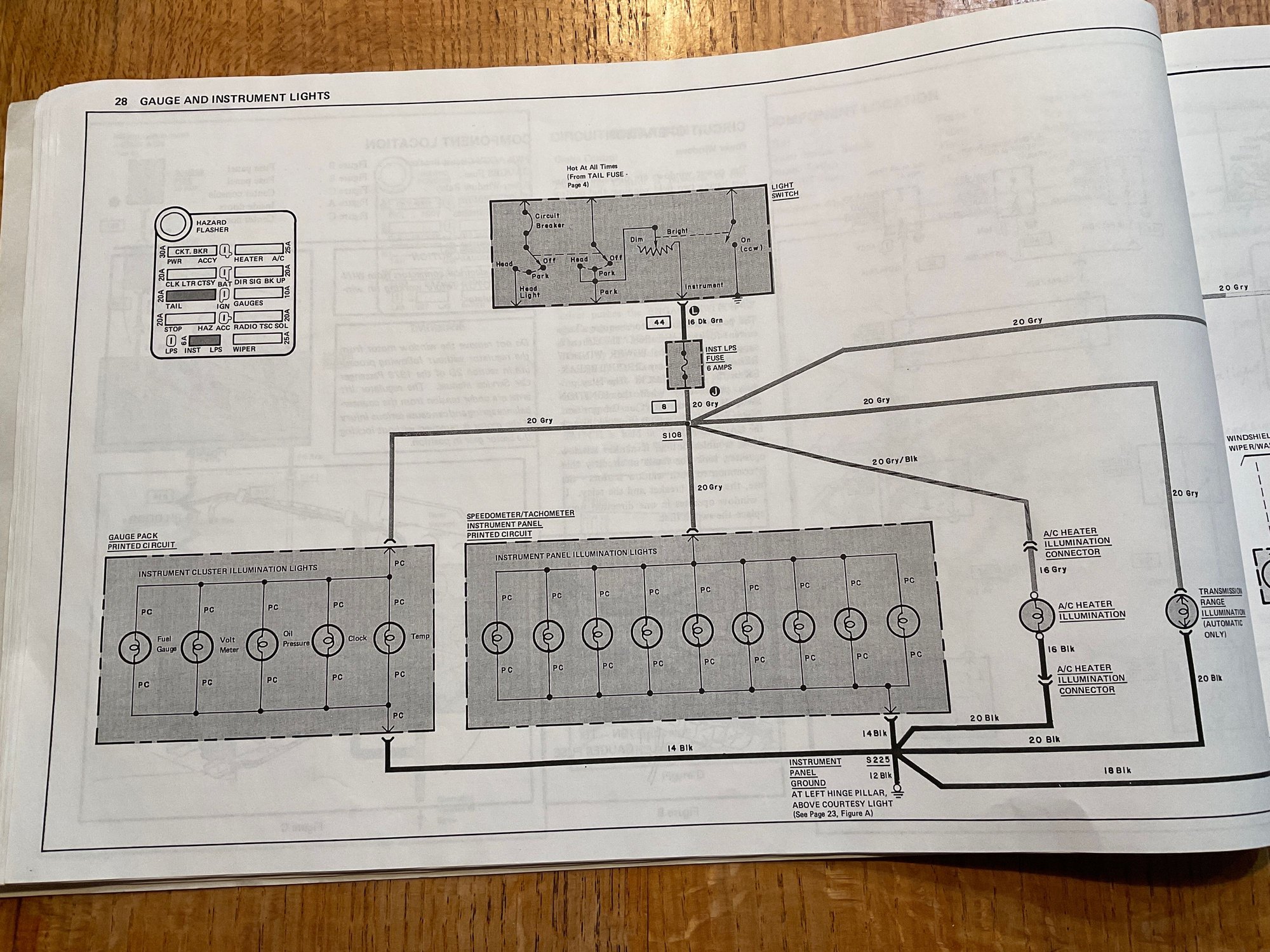

Hi All,
My tach and speedometer lights are not working. Yesterday I spent time to open things up and replace the bulbs but of course they still are not working. I am wondering if this is a grounding issue and does anyone have any info or pics on what my next move should be? I am fairly technical and know how to use a volt meter but have not removed the bottom dash yet to get into it. Wanted to get some info first.
This is on a 78 L82.

All the dash lights share the same ground. Weak spots in the circuit are the flexible printed circuit board, dimmer switch and headlight switch. GE replacement bulbs still available.

not sure what bottom dash you are talking about, as above check grounds etc..
NOTE- be sure the headlight adjustment **** is not in off position.. disregard if other lights work on dash..

Sorry the bottom panel under the wheel. Headlight adjustment it good. Directionals light up along with brake and high beams.

just to be clear…you twist the headlight switch to dim or increase dash lights..not the indicator lights
