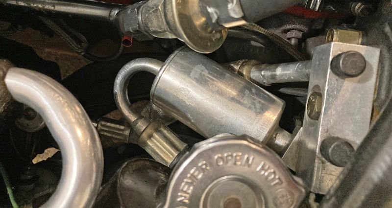

Guys I have a dilemma as I cannot locate anybody who can recondition my original Air conditioning hoses and pipes. I have noticed that the rubber is cracking and want to have them replaced while keeping the factory aluminum pipes. Do you guys have any suggestions?

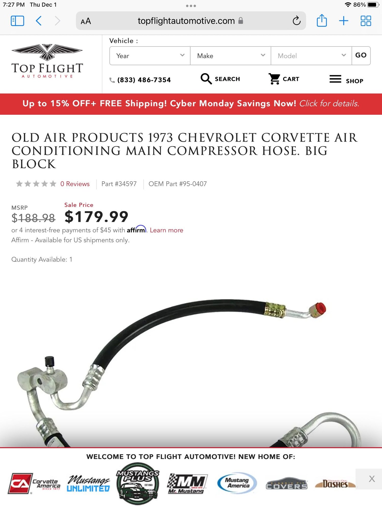

Could a local hydraulic place or parker hose dealer make some?
or
sponsors?
old air products?

everybody still running 45 year old hoses needs to replace them. rubber is not made to last half a century. especially with 250 to 350 psi in it. be careful which you buy as each era of AC has different fittings at the firewall. not sure all the same at the condenser end. i know 75 is same as 78-82, but the earlier type txv and sight glass up front may be different than later ones.

I would bet the new replacement hoses from the vendors such as Zip, are upgraded to barrier hose. Not sure you can buy the old crap anymore.
Just checked one on their site and can read the print that says Parker Futura, Barrier hose in the picture.
I have to make a comment here, sorry
73-E77 air-con is the VIR Style. The compressor changed types mid 76. Mid 77 they dropped the VIR System and went with a more modern system.
The hoses changed 3 times between 75 and 78.
