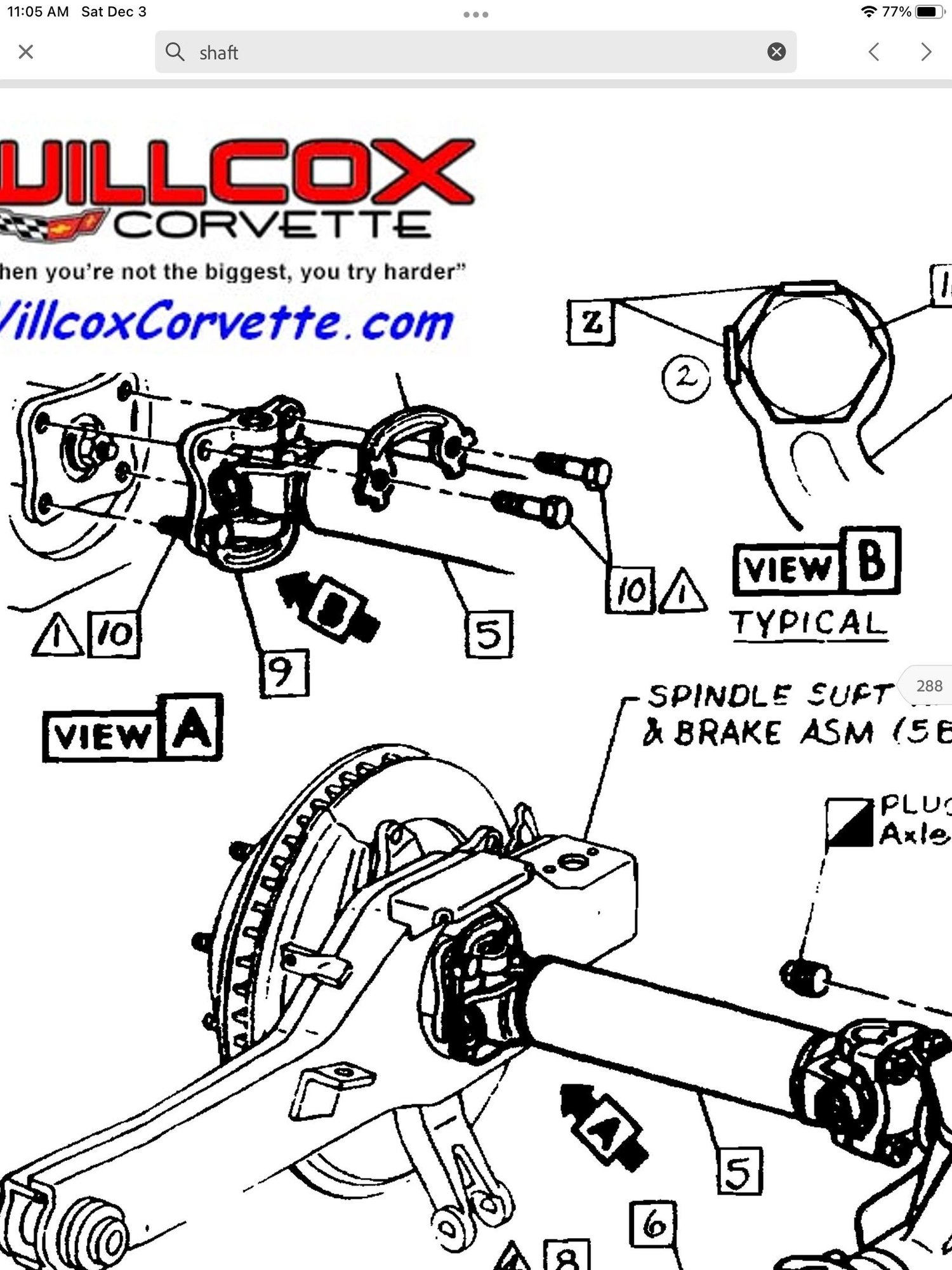

I'm replacing all four half-shaft U-joints, and at the hub end there are thin steel plates with the ends bent up around two sides of the bolt heads to keep them from coming undone.
I think I can save them, but I can see that one has already been out once, and I'm thinking these little tabs mightl break off.
Are lock washers ok?
I worked for years for Freightliner and Mack, (in parts), and even in extreme conditions like logging, I don't recall using anything except good quality lock washers. I can't remember ever handing out lock plates like the ones at the rear hubs.
It will takes some days and a bunch of $$$ to get those blasted plates shipped over here.
Opinions?
