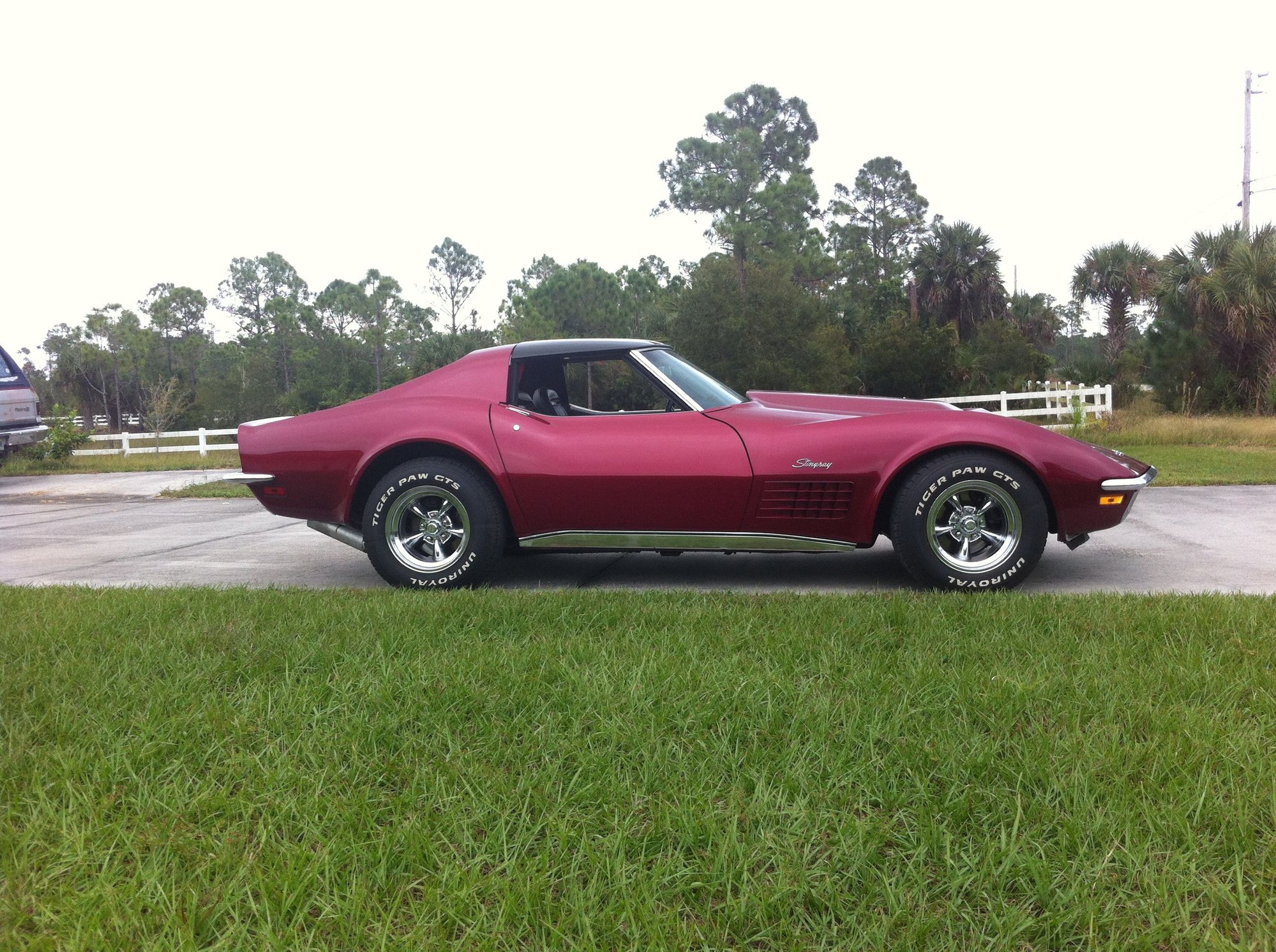

Headers allow everything else to work. My LS5 turbo 400 was a bit of slug 30 years ago when I got it. Headers and cam did help a bit. But really not worth the effort. The 3.73 gears helped more than anything.
I fought the issue hood of clearance and that was reason to not make my car actually fast. Putting off the L88 hood for as long as possible, but (went long L88 to avoid the wiper door), but finally had to give in. I spun a bearing at 110,000 miles, so the choice was big crate motor or making the little LS5 work…
It wasn’t until, the air gap style performer, 850 Holley, iron head bowl work, MSD and roller conversion do I think the headers started to matter. Years later I had a head gasket issue between cylinders, so yes, out with the small valved iron heads and into Brodix Race Rite aluminum heads, also did big aluminum radiator and electric fan, borgosan steering box. Now I am sure the headers matter. I’d post pictures of the engine, but it looks like every other. There is no spacer under the carb, even with a drop base, there is ZERO hood clearance.
Now the car feels fast, it is criminal that they put those little valved heads on a big block going in a vette, but now the car feels as it should have from the factory. In retrospect, I should have simply yanked the original LS5 and got a 540 stroker, but ai have no room for a giant motor in my condo.
my C8 should be on the way very soon. These are some older pictures, but the car is the same except for Radial T/As now.
