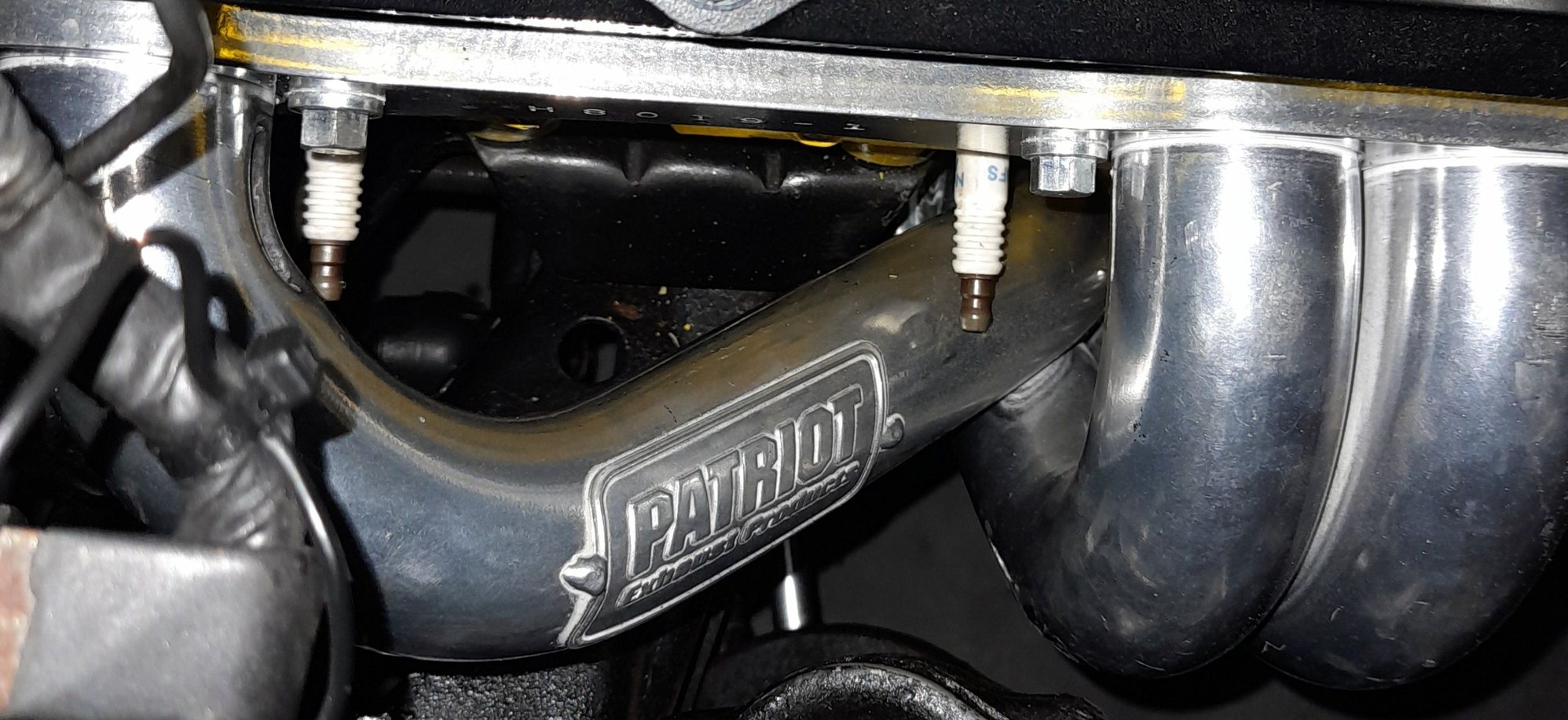

Trying to help a fellow Corvette enthusiast. He is in the process of installing a BluePrint 383 engine he had brought over from the states.
because he has side pipes he has decided to run block hugger shorty headers. This would not be my choice but I am trying to help him out.
the issue is that BluePrint calls for NGK BKR5E spark plugs. Same plugs I run in my car. But, with the block hugger headers the plugs are almost touching the pipes. If I install the plug wires the boots are touching the pipes. Even with heat socks on them I fear they won't last 25 miles. Tried to get some photos with my phone. Not the best but maybe they can help.
now maybe you can tell, maybe not. but there is maybe a quarter inch between the plug and the pipe on numbers 3,5,4and 6.
I have heard of shorty plugs on here before, those with a shorter porcelain end.
Does anyone have a part number for a short plug that would be the equivalent to the BKR5E.
or perhaps another solution?
Thanks heaps for any help. Poor guy is desperate to get this on the road.

Had the same problem on my 79 with those headers. Sort of a solution we’re these short spark plugs. With Taylor plug wires. It’s still close but wires don’t touch the headers haven’t burned yet. I’m running Dart 180 heads.

ACCEL 0416S-4 HP Copper Spark Plug - Shorty
Or leave the insulator off and see if spark jumps to the pipe too much.

https://www.holley.com/products/igni.../parts/0416S-4

Thank you everyone. We will get some coming. And some heat protector socks as well.

I have a set of long tube headers on a C3's 427 running 12.25-1 compression which generates even more heat than normal coming out of the cylinder after combustion. On my drivers side the spark plug wires are near the tubes so I have put the DEI Spark Plug wire insulators on them. The material even touches the exhaust tube for my #1 cylinder but the wire remains fine and works great. I am a strong believer in using the insulators as they provide protection for the ends of the wires.
Block hugger style "header" is not much of an improvement over the stock exhaust manifold in many cases. You might want to look at other options for headers from a bigger company with years of experience. I use Hedman Hedders and have been very happy with them. They have always fit without the BFH to help re-arrange the surface of expensive headers. In situations with the ceramic coatings you really can't bend them too much without compromising the coating.
Sometimes you might have to trim the spark plug boot on the wire to get a closer fit to help avoid contacting the pipes. If you can get the short spark plugs in your heat range they too are great for tight installations.
From your pictures I would bet they used a jig to make them without any spark plugs installed. That clearance is ridiculous, I have not seen anything that close before.
