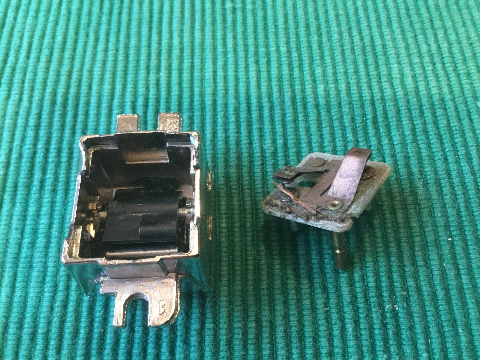

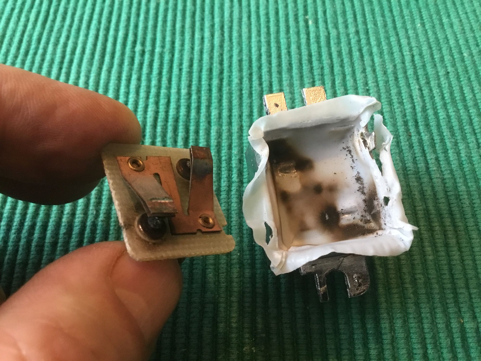

The up/down switches are a weak point. They easily get dirty and they arc a little just before contacting which causes carbon build up. They can be serviced, but their enclosures are brittle and it’s a cheap part. Clean up every connection in the circuit and put back together with a little dielectric grease.
Charlie
Fir needle blocking contact
Someone added a plastic shield to keep dirt out. Scorch marks from arcing.
