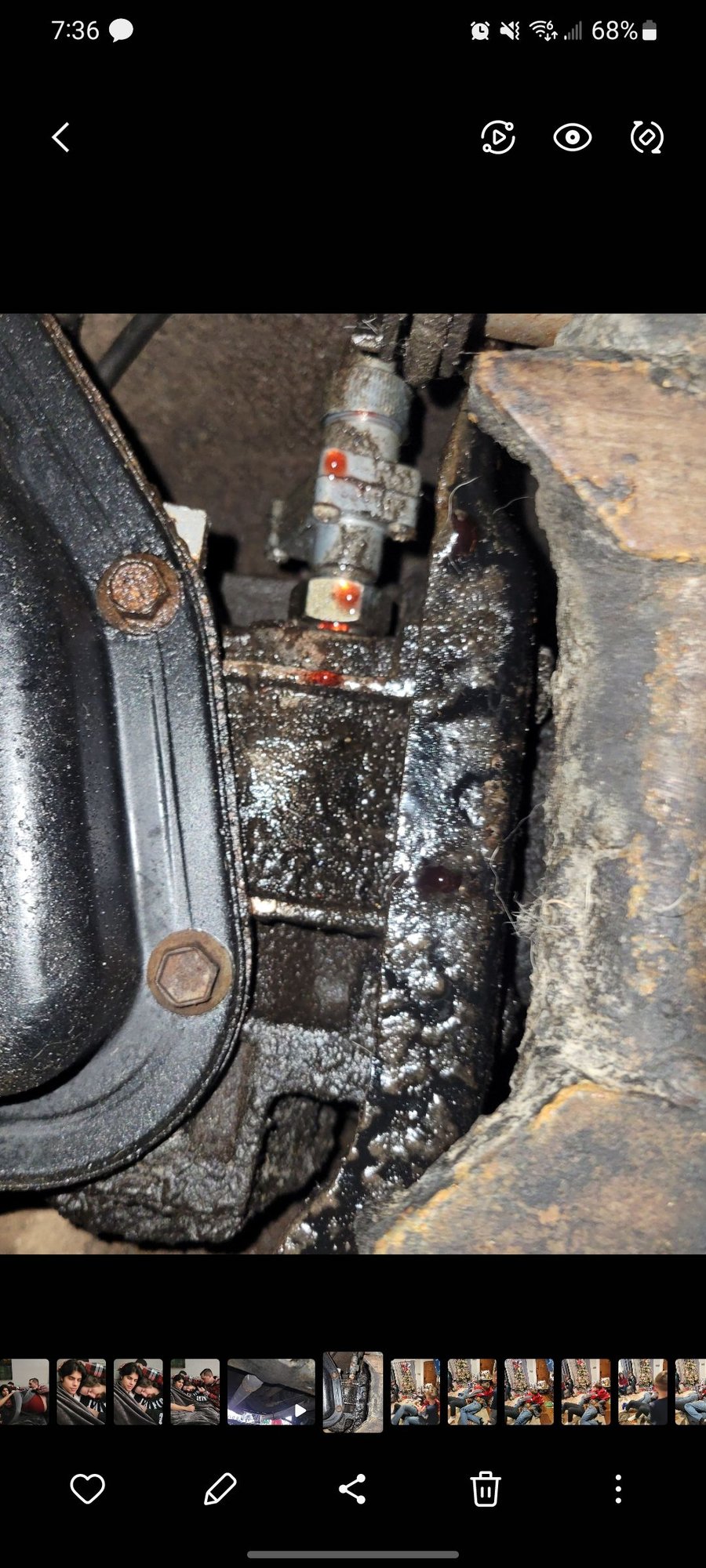

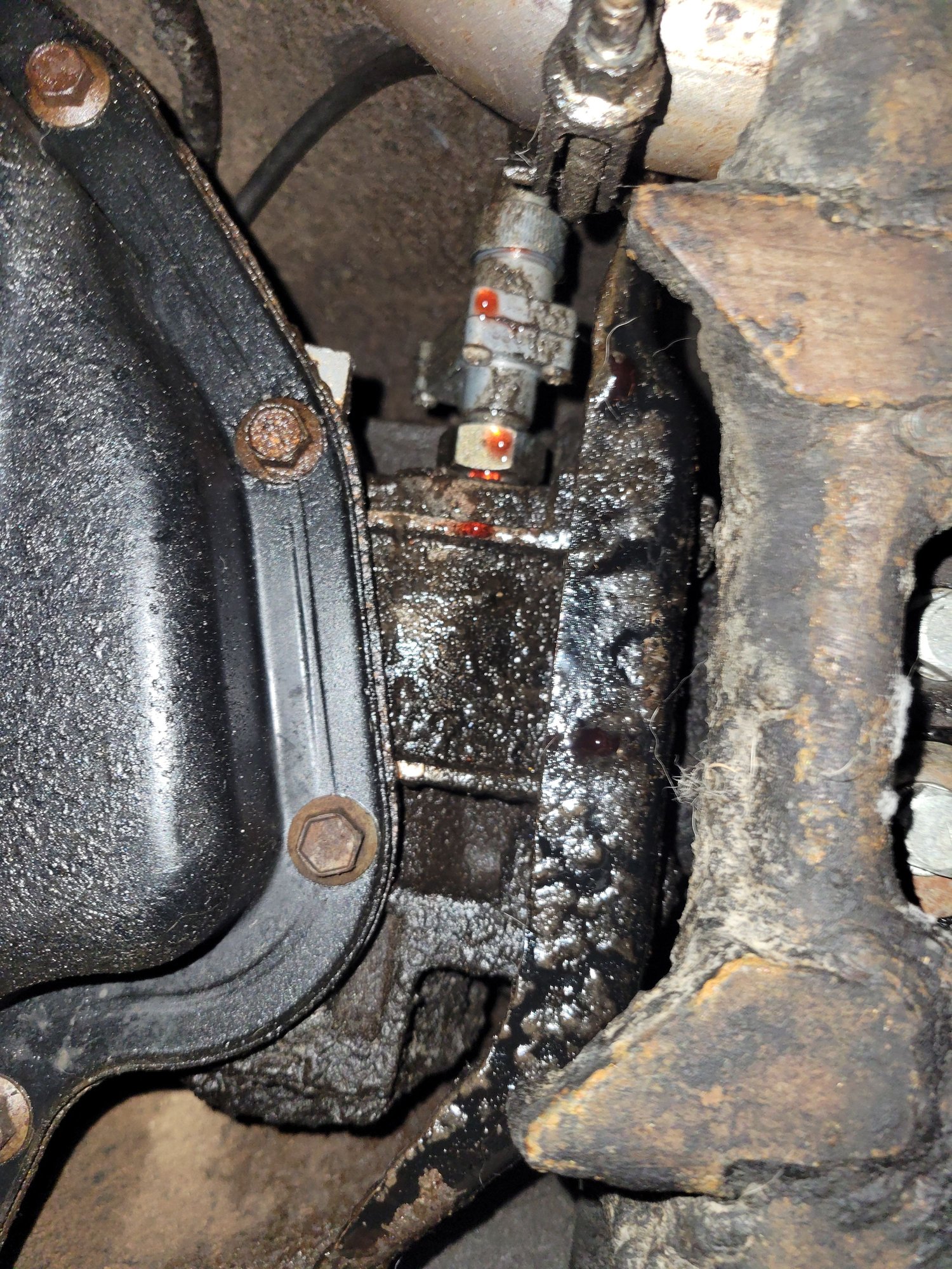

Hello I have a 1977 covette that was passed down to my wife and I. I am new to corvettes and still in the process of getting the vehicle relocated to me. But I am trying to troubleshoot a fluid leak prior to it getting here. Can someone help ID what part is leaking directly behind the oil pan?What part is leaking?What part is leaking? ​​​​​​​Please message me if you cant see the picture.

ATF?

Speedometer gear reduction adapter?

That the speedometer cable’s connection at the automatic transmission tail shaft. The seal has failed. Easy and inexpensive fix and no special tools required. There’s probably more leaks too but that’s what is showing in the picture.
