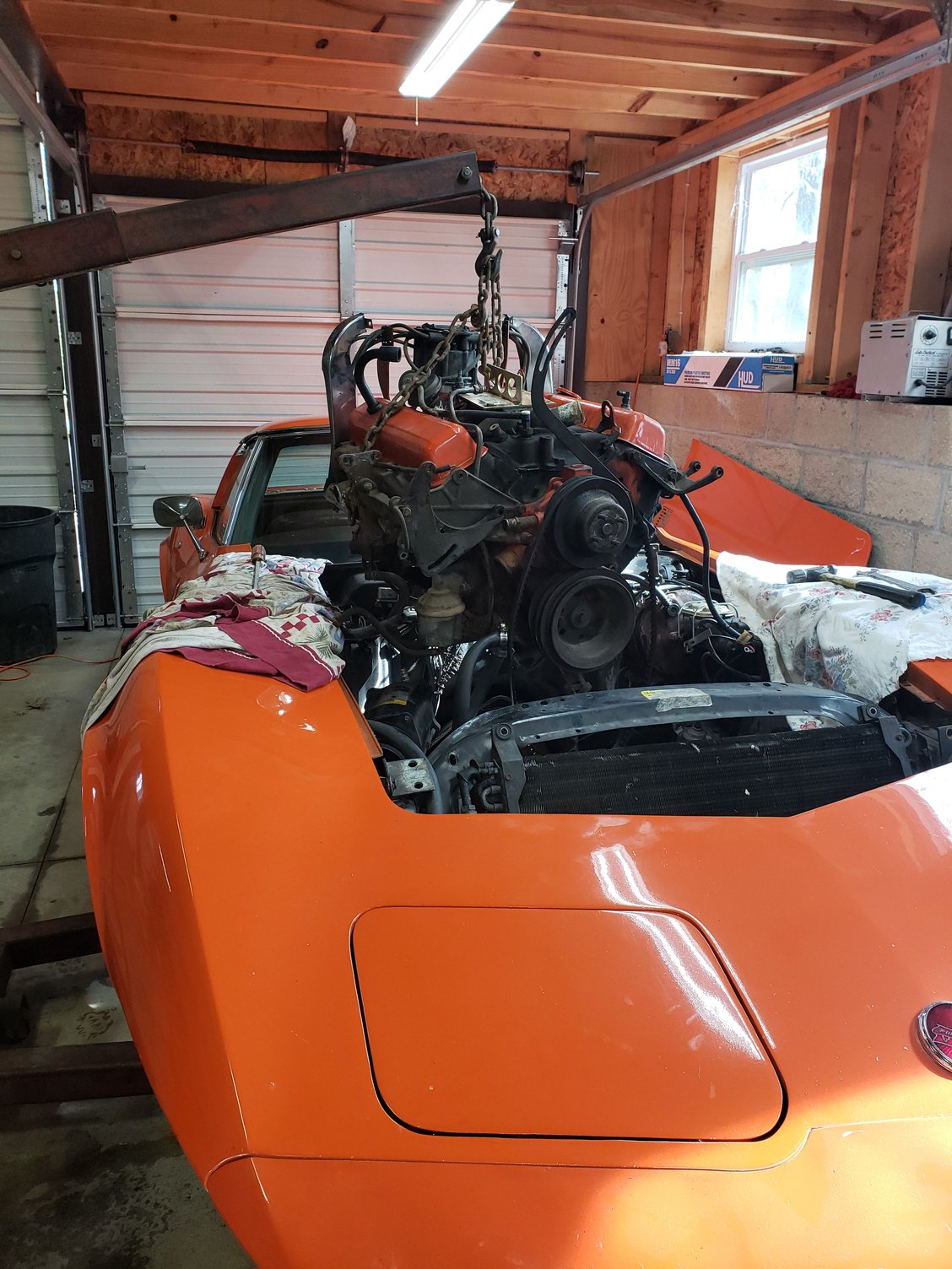

Hi there guys and gals. I currently have the engine out of my 76 l48 350. I am planning on doing some upgrades to the engine. I just finished the Borgeson steering upgrade. It was so simple to do with the engine out. Now I am looking into putting heads and a cam. I thought I had it all figured out but ended up starting over. I am thinking I will go with the Edelbrock E-street 64cc heads. I also want a cam that sounds pretty aggressive, not really concerned too much with power. One thing is that I want it to idle pretty smooth. I am hoping to get some good suggestions here. Oh and I have 3.08 gears. Thanks.
