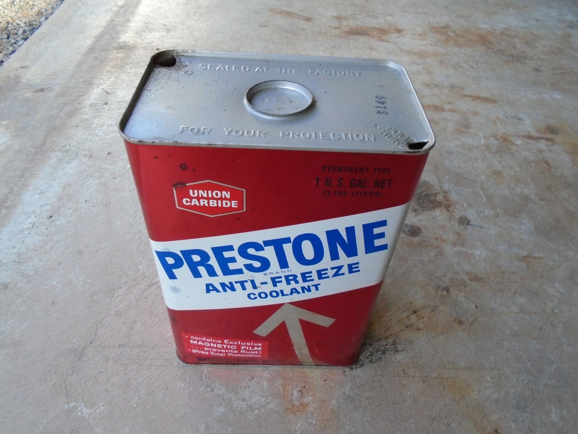

Oooo... Magnetic film... I gotta get me some of that!
