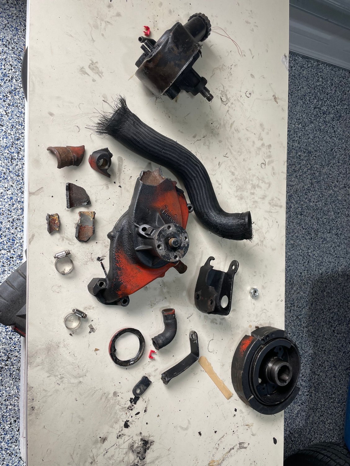

If you have ever wondered what would happen if your harmonic balancer comes apart, look no further. Here’s all the parts I had to replace plus the coolant and power steering fluid and timing cover gasket. If it weren’t for a couple of Good Samaritans, it still wouldn’t be back together. Power steering brackets are on back order until at least February, maybe longer. 1968 BB.

WOW …
what were conditions when it went?
glad repairable!
Old Jan 8, 2023 | 03:36 PM
Ron1968's Avatar
Ron1968
Joined: Nov 2019
Posts: 76
Likes: 7
It’s one of those things I never really thought about, I still don’t know how to check it. It gave no warning at all, I was just coming up through the gears at about 4500rpm and it came apart and made one heck of a noise.

The rubber breaks down and slips or comes off.

Was it a 55 year old balancer? never think about replacing due to age.
I’m not sure how old the balancer was. With the pulley on there it is hard to see what shape it was in. The only clue I had was that the front seal had started leaking and I am wondering if that had something to do with the failure.

Wow, I didn't know they could actually fly apart in pieces. There must be a cause to weaken the structure of the cast iron - or is it ductile iron; I wonder if it was pounded onto the crank, inadvertently creating cracks and weakening the casting.

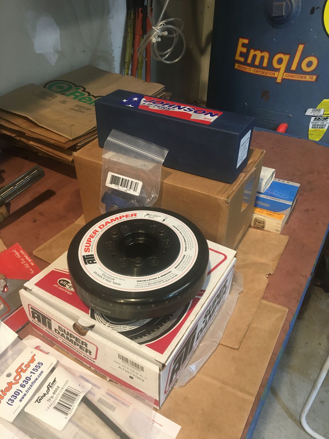

Was under the motor recently and noticed some sort of powdery residue on the back side of the rebuilt original balancer. I pushed on the outer ring And it moved for and aft. Not good. So this is going on in the Spring. I’m not messing around anymore.

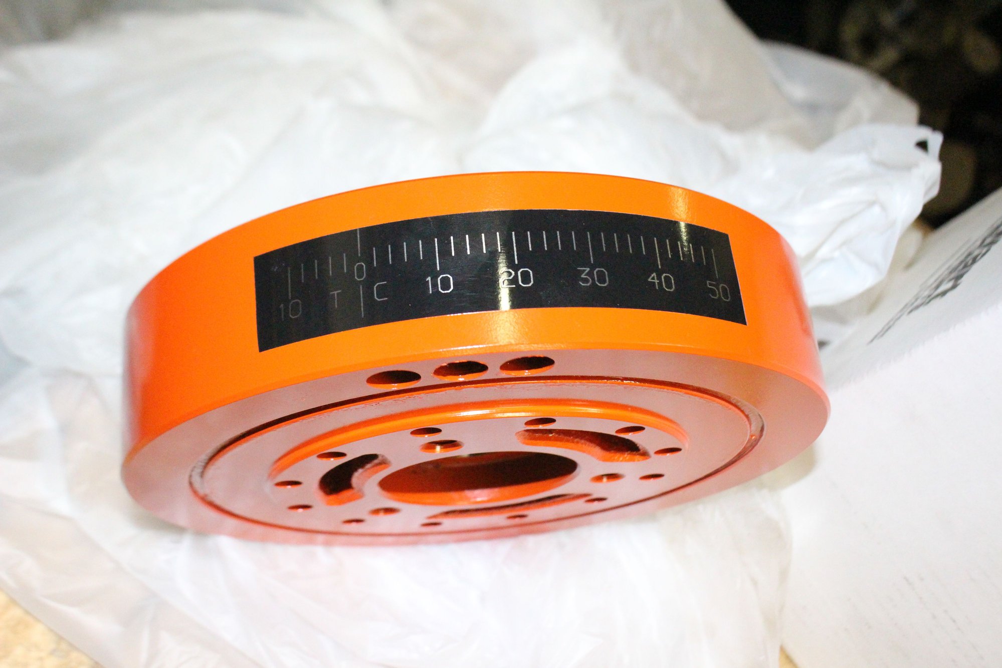

So if you want SFI approved safety, and an original look, and the convenience of etched timing marks:
Then you can paint yours the way I did: I taped off the one section.
Be sure to plan some time to hone the balancer to fit the crank. ATI's are the best..but they typically come undersized because they have no idea what crank it will be installed on.

I wonder if the balancer was ever installed with a hammer causing the ring to bust a piece off? The inertia ring is flat broken, yet the rubber still looks all intact .
