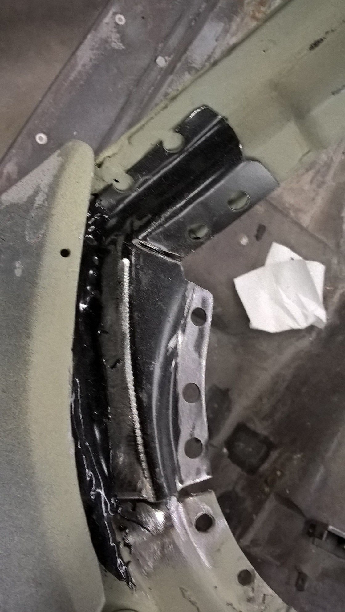

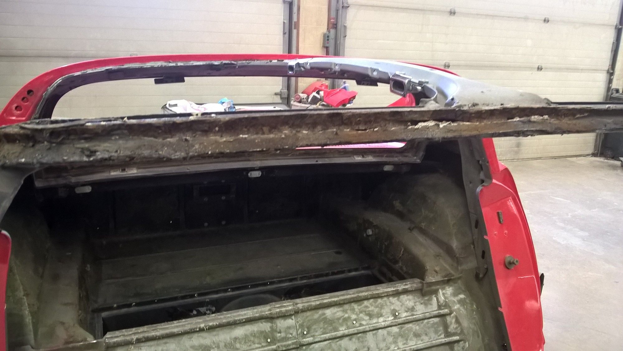

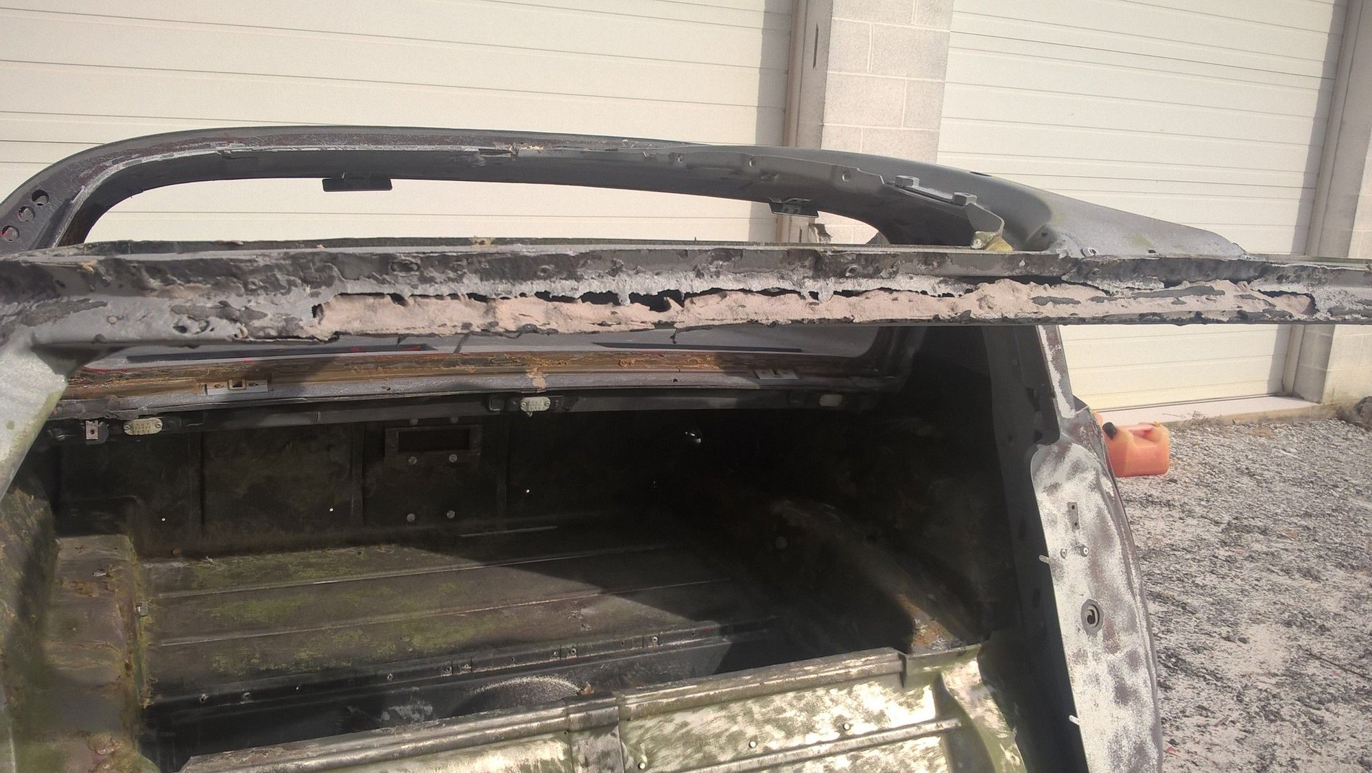

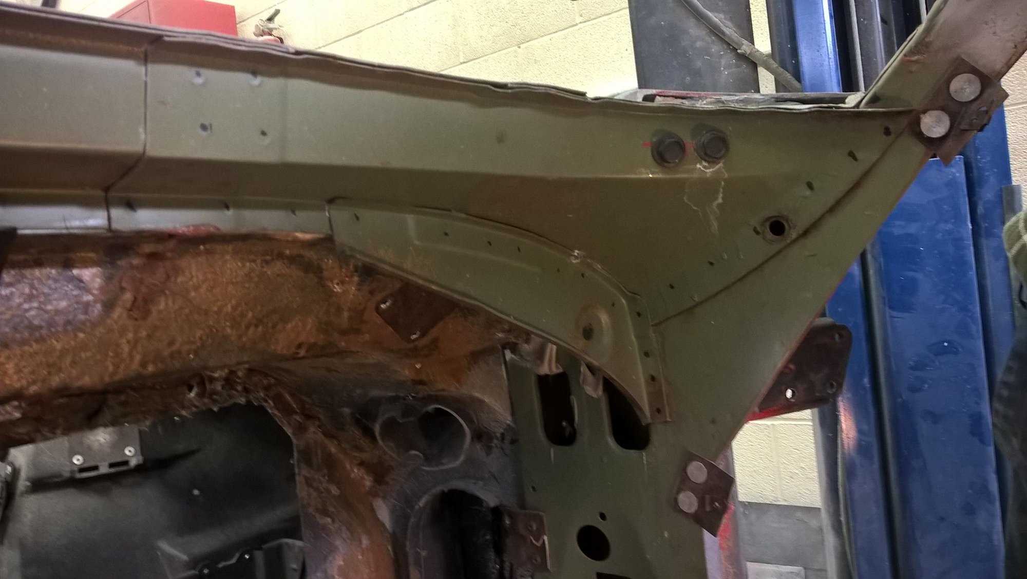

Another trick which revealed my cars rot in the windshield frame was to take a piece of white paper, put it on the floor on both sides of interior and open and close the door a few times. If you see flakes, you have problems. In my case, my #2 and #3 body mounts were perfect, but on passenger side #2 there were a pile of flakes from above. Also washing the car would cause water to puddle on the floor. As you can see from the pics, I also had some rot down low in the windshield frame, but was able to get it from the inside. Had it all fixed and all good now.
Bill
