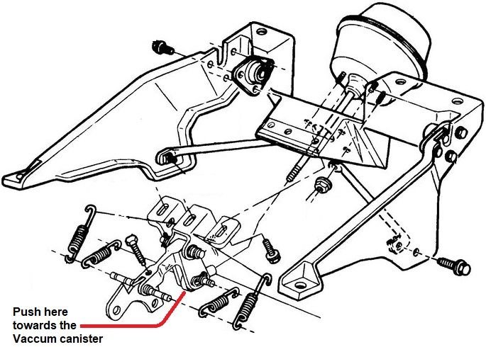

The mechanism was designed that you can open or close it manually. looking up from underneath if you push where the red line is shown the headlight cover should close. The vacuum system worked from the factory, but over the years it can be very frustrating to maintain.
I didn't see a year for your car, but the systems are all similar. I will make another post showing the vacuum system. It is for a '69 and should give you an idea of what to look for to find a leak in the system.

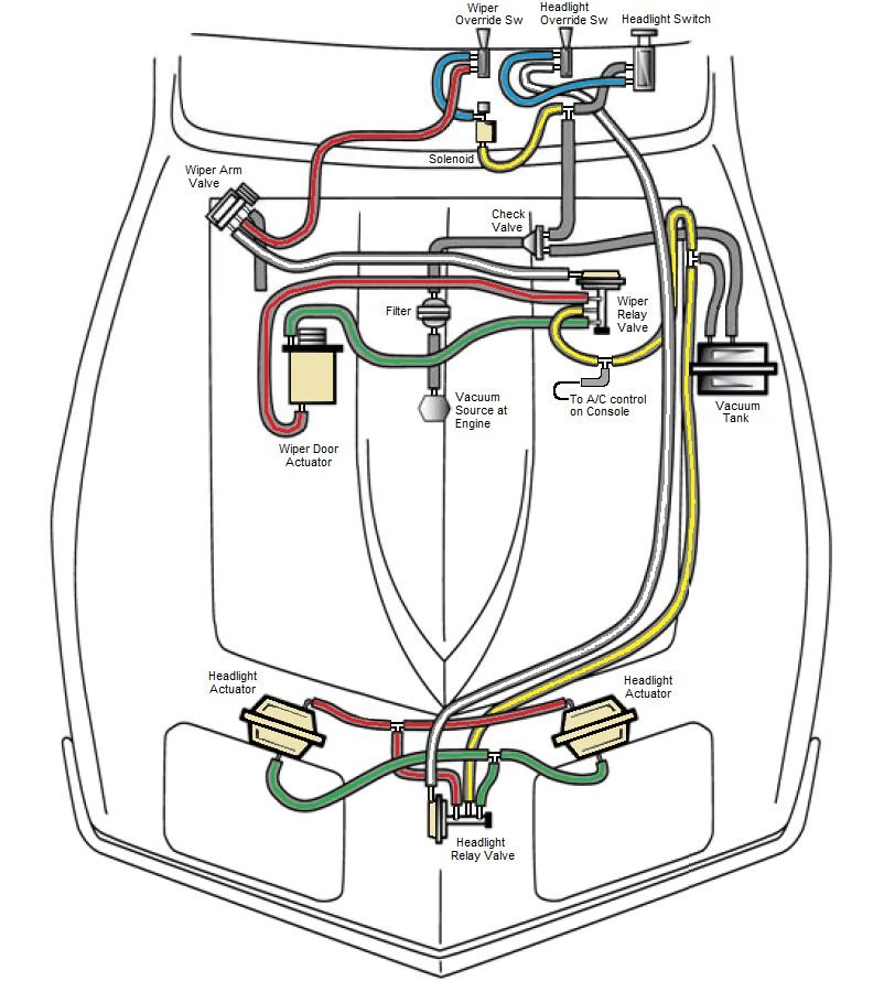

Here is the vacuum system for a '69. Later years had two vacuum relays in the front near the headlights, but the worked the same way. At some year the moved the vacuum tank towards the front of the car and I think they made it part of the framework.
In '73 they removed the Wiper Door mechanism, but you can see the system is a can of worms.

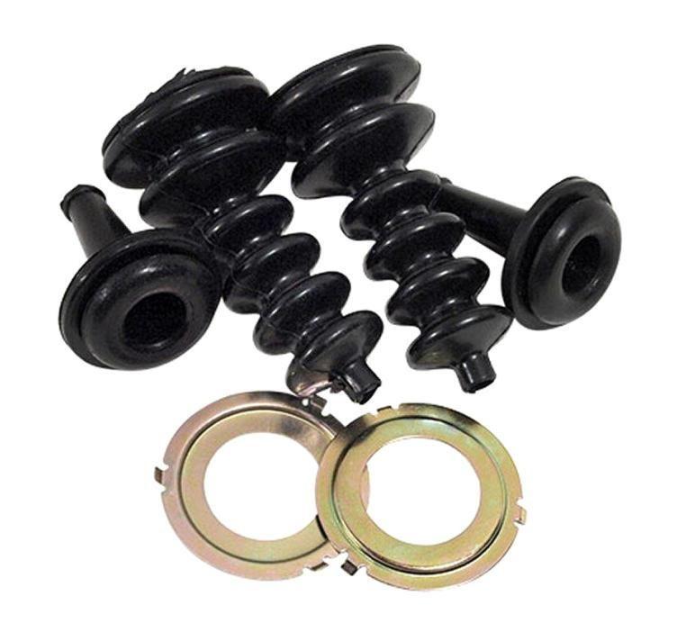

Most times when the headlights are SLOW to open the seals in the actuator are broken, here's the seal kit you need to fix it:
Headlight vacuum parts test:
http://www.corvette-101.com/vacuum.htm
