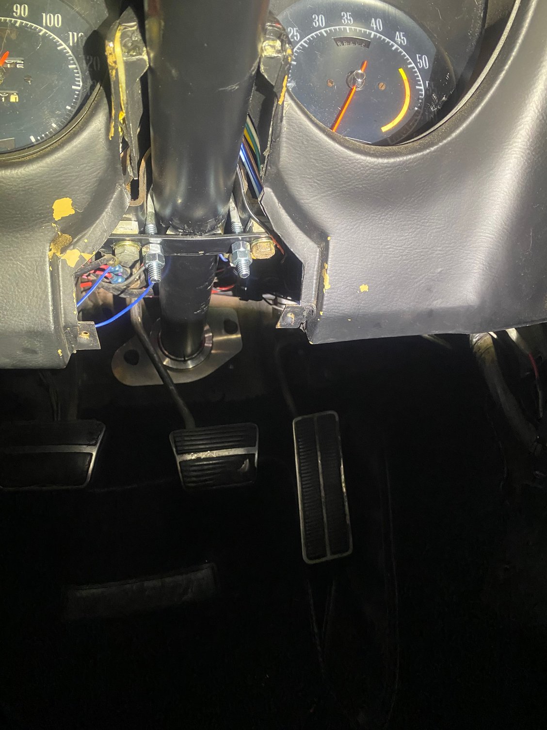

I just installed an Ididit Universal steering column in my ‘68 and it was super easy. I have the Borgeson Power steering and it was always sloppy. I have all new front suspension and ball joints, had the alignment done twice and the factory column rebuilt but nothing seemed to help.
I finally bought an Ididit column (part # 1120350010) swapped the splined end of my rag joint to a 1” DD fitting and bought a Flaming River firewall bracket (part # FR2010VT). The column comes with a flat connector but I cut it off and spliced i. The original wires and connector using the diagram from Jim Shea. For the upper column bracket I used a 2” u-clamp with a 1/8” flat bar and longer bolts. It worked great. This was recommended by ‘anesthes’ and it worked great.
I did buy the column as NOS so all in I was probably about $400. Its amazing.

The stock one was 37” but when I installed the Borgeson box I had to compress the stick steering column to about 35”, the Ididit column was 35”

I had shortened my original factory ‘68 column so when I ordered the Ididit I ensured it was the same length.
