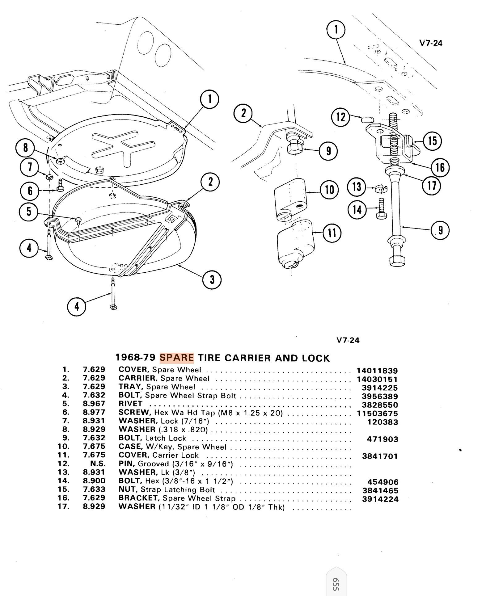

hey guys can someone tell me what year these spare tire bolts go to , i seen they vary with the different years? thanks Bill

The midyears (except perhaps those with goldline tires) used 9.xx" long bolts for the forward straps of the carrier but beginning in '68 through at least '79 use the 6.xx" bolts. All '63-'79 use the same 7" latch bolt. Measurements of my '67 and '72 confirm this.
