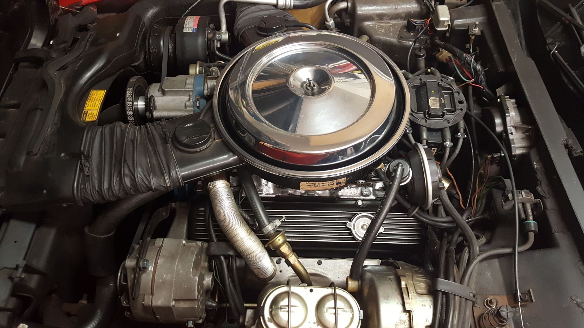

I need to pull my trans and have it rebuilt along with my top end gaskets need replaced. I am looking to maybe do the heads and non roller cam (would prefer not to do the cam if possible) with some shorty headers. Anyone do this? was it worth it?

Looks stock from here. Dart 64cc heads wake the L-82 up. Smog stuff can come out if you don't need it for inspections.
