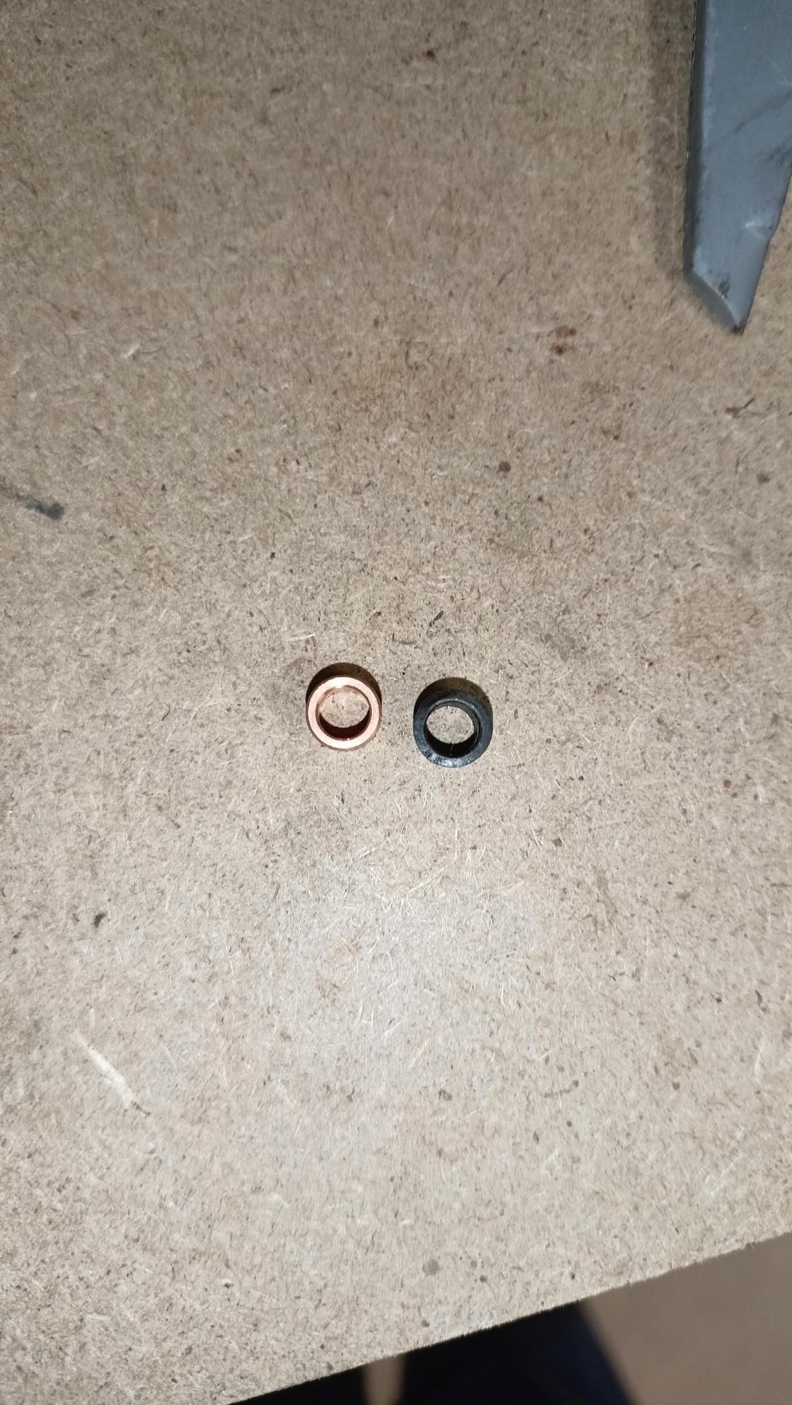

Hello to everybody, as suggested I open a new post instead use an old one. I'm working on my '69 L36 Corvette's distributor. It seems ok but it doesn't give more than 15 degrees in mechanical advance (it's really the maximum, I also tried with very soft springs). I read that it should be 26 degrees. If I don't pass the 36 deegres in total advance can I remove the stop advance bushing for have some more degree or it's better to have something around the pin?

I post some pic. I don't thing it's a weight problem: I tried with very very soft spring and the situation doesn't change, I'm sure the plate opens until bushing. I have a rubber bushing now, I found a metal one in the spring kit (same size), so I was not sure if could run without bushing, that's all.

That picture of your black rubber bushing shows it so far off it probably does not work. It needs to be all the way up on the pin.
Distributor on left has brazed up slot and no bushing. Distributor on right has brass bushing. Notice the brass bushing is pressed on all the way and peened over. You can alternately crush the bushing a little bit before pressing it on as a way to retain it.​​​​​​​

In the picture I moved the bushing fron the pin just for show you better the size, I found it in the correction position when opened
My engine is original so I don't need a big advance. I like to set the initial advance between 8 and 10 degrees, the engines runs good with this and it's quite ready yet. If I set more advance I have some resistance when I start the engine and also a little bit of diesiling when I turn off with warm engine, also if I use the high octane gasoline (we have also 100 octanes in Italy).
The mechanical advance gave me just 15 deegres, now without the bushing it take 22 degrees and 10+22=32 is enough for me, I don't need to reach the "magical" 36 of total advance (from where does this number come?). I just don't understand why the distributor doesn't give me the 26 degrees of maximun mechanical advance (the plate reach the pin so opne completely...)
