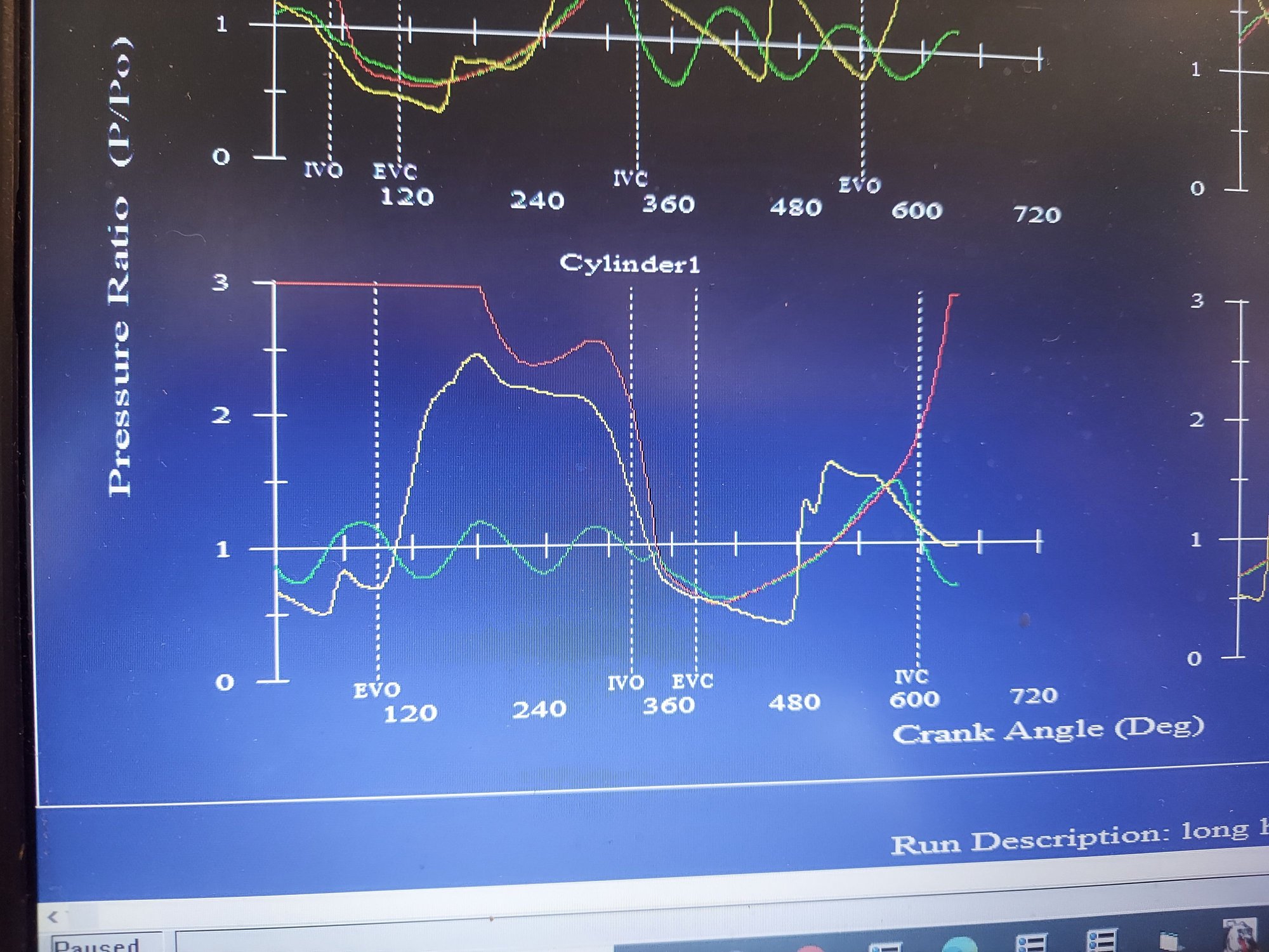

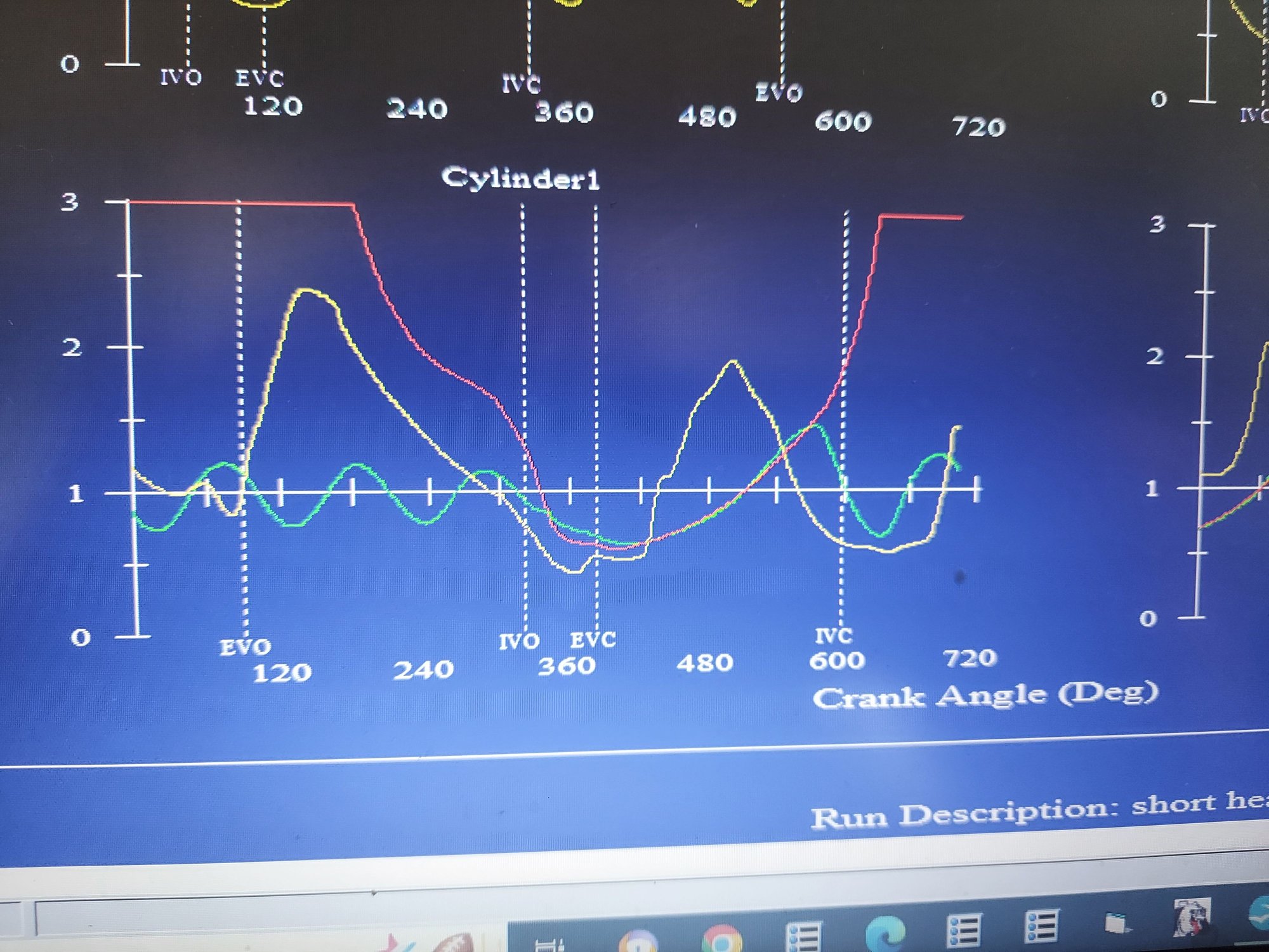

Tuned header vs untuned in the virtual world is worth another 20hp no restriction, assuming the combustion is the same. take it for what's its worth 28" vs 46" I am guessing the 28 may not be as touchy on restriction . 46 inch 28 inch​​​​​​​Chart​​​​​​​

28 inch
46 inch I did make the primarys bigger than the 28. Pretty ugly
Chart

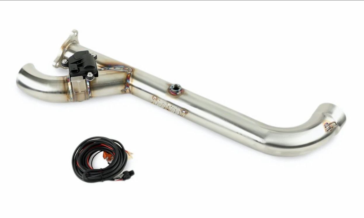

how about a hidden muffler exhaust with an electronic cut out for the side pipes? best of both worlds at a push of a button?

Originally Posted by interpon
great read thank you.
I love the idea. It would definitely add some complexity to any exhaust system - but that's never stopped me before! Better yet, if you have a way (via EFI output or similar), you could trigger the exhaust to open automatically at specific conditions. Throttle position, or manifold pressure, OR both... Where did you get that picture / what product is that?
I think some other members of the forum were looking at doing a side pipe bypass damper or something like that. Either way, it is a good idea.
