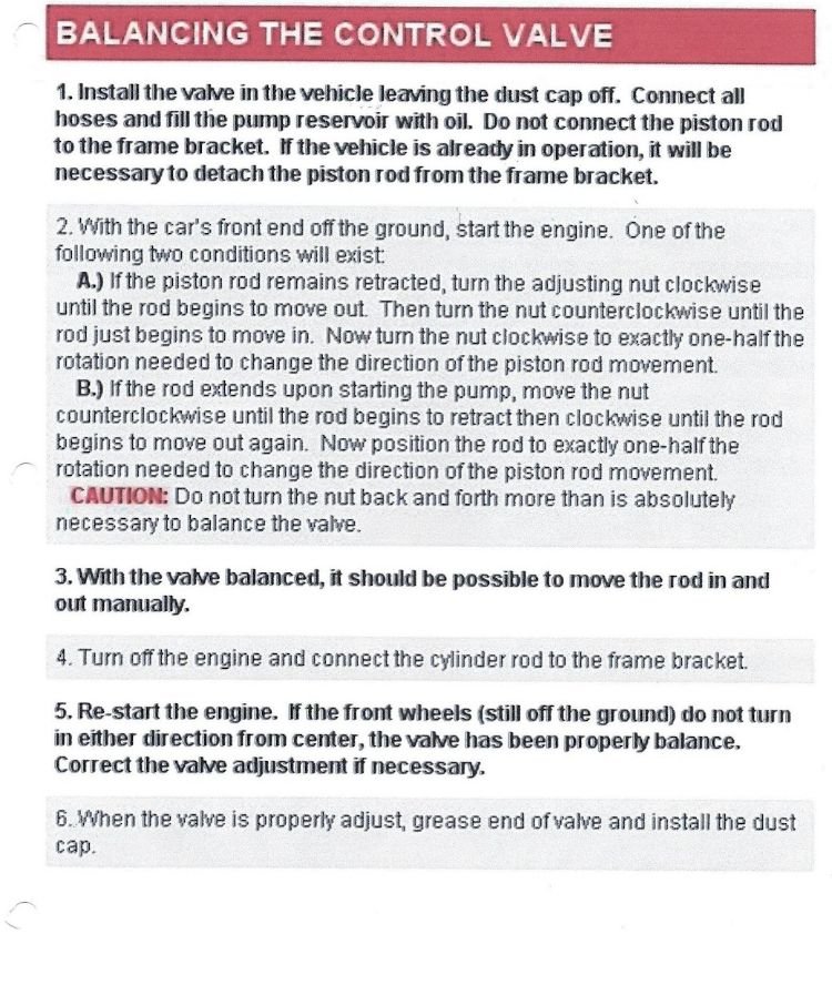

I will assume that you will install the control valve on your car. The instructions call for the front wheels off the ground and then starting the engine, and next turning the steering wheel. In my case the car would be on jack stands, and I am always reluctant to open the door with my convertible in the air, much less starting the engine. I took it to a shop and paid around $ 125 to have them install a new valve. Oh it never leaked and it was from Lonestar.

Actually you want to have the ram disconnected from the frame bracket for the first start up and adjustment so that when (not if) the valve is off center, it only extends the ram and doesn’t slam your steering linkage to one side and possibly injure you if you have your hands on the wheel at that time. I used to have the adjustment procedure on my phone, lemme see if I can find it.
Old Feb 17, 2023 | 01:25 PM
wwiiavfan's Avatar
wwiiavfan
Joined: Oct 2020
Posts: 1,567
Likes: 576
From: Wisconsin
Here it is:
Old Feb 18, 2023 | 07:03 AM
