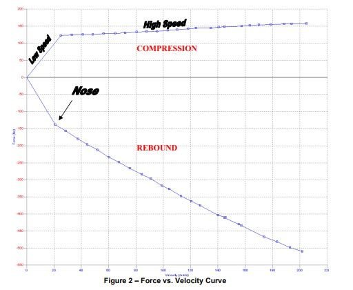

Here is a somewhat typical shock graph from a shock dyno.
The area from a piston velocity of 50 to 150 mm/s is the most important regarding handling. And it is the force applied here that is important, not the %
Compression is 150lbs in this range.
Rebound is from 200 lbs to 400 lbs.in this range.
Certainly no where near 90%.
More like 42/58 to 27/73 in % terms.
Here is a Koni graph of a Double-Adjustable showing the effect of the adjustments.
Still no where near 90%.
30/70% is more common.
