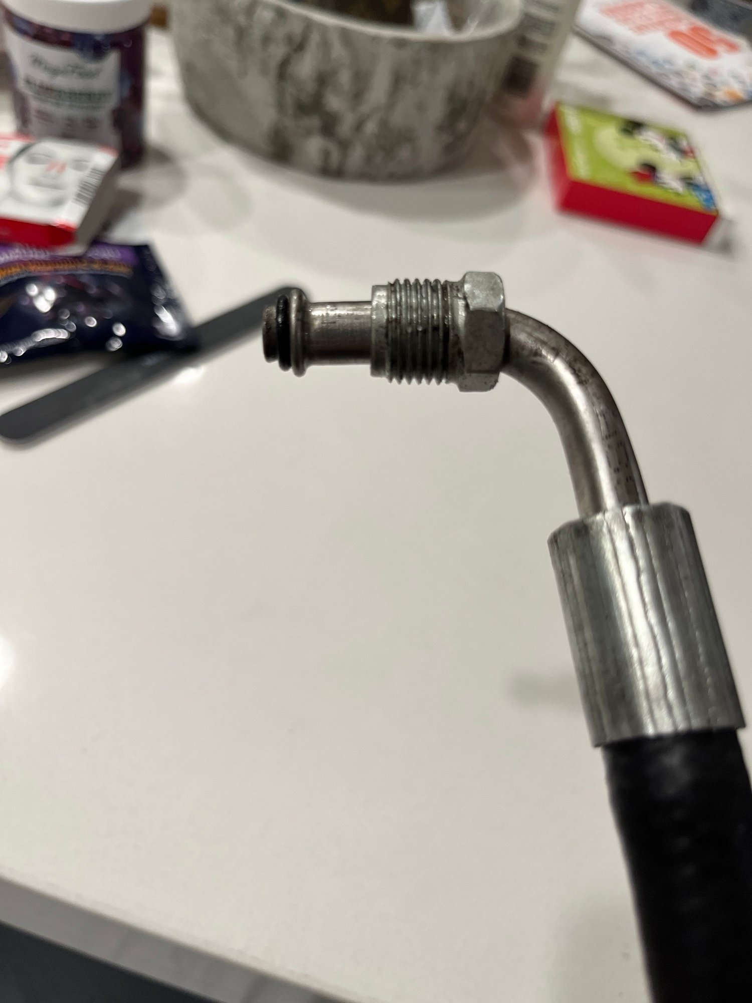

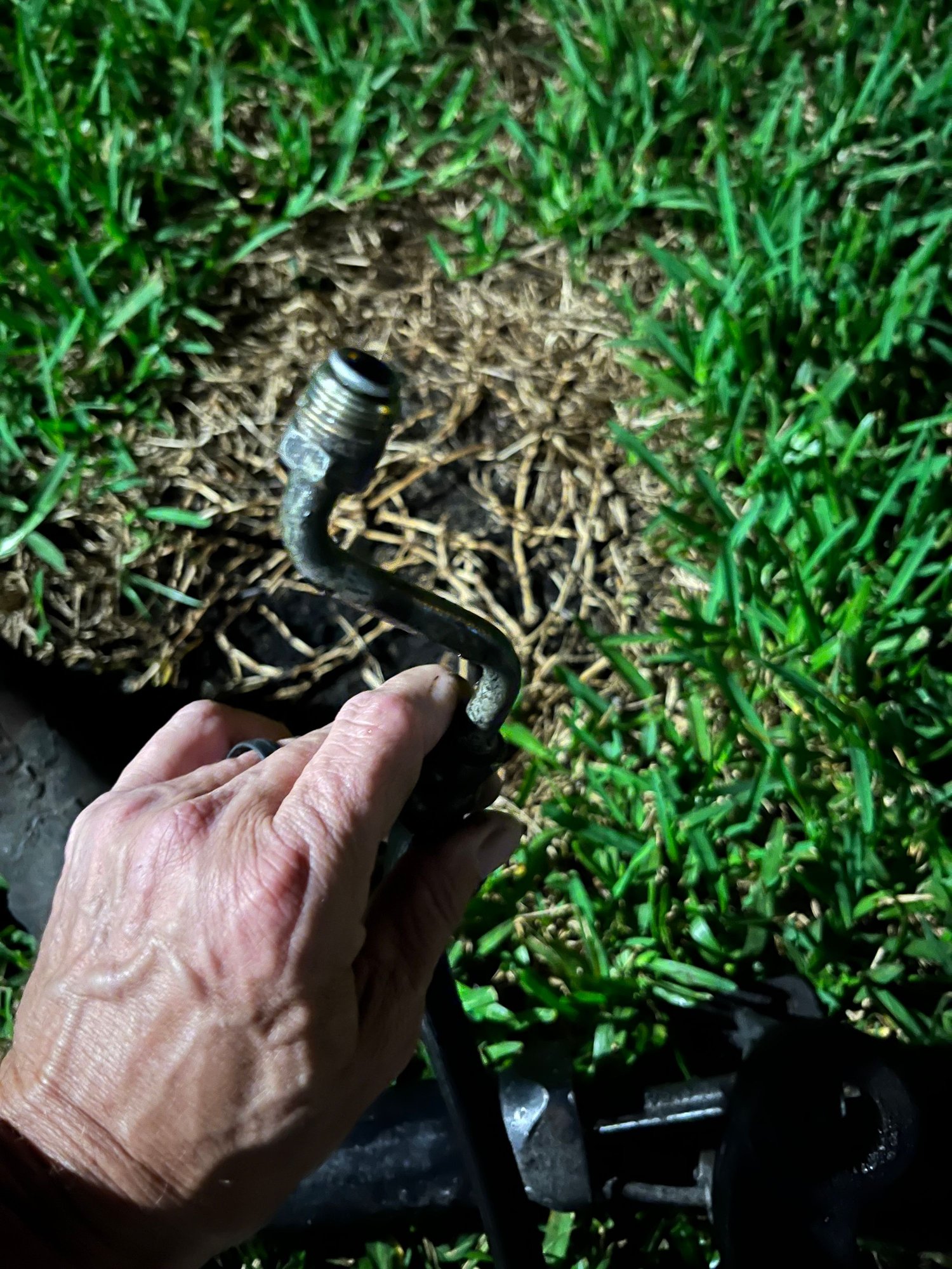

I bought a never installed steeroids 63-82 rack and pinion conversion kit from a guy on offer up. The unit was never installed and still had everything sealed. The installation was simple and it went on with no issues. I'mmtrying to connect the power steering pump to the R&P but the hose that came with the kit has an fitting that is not compatible with my PS pump. I've attached pics of both fittings, hoping someone on the forum is familiar and can point me to an adaptor of the appropriate hose. The top pic that has grass background is the original hose that was connected to PS Pump and the lower pic with o ring is the fitting that came with the steeroids kit.
Thanks
Jose

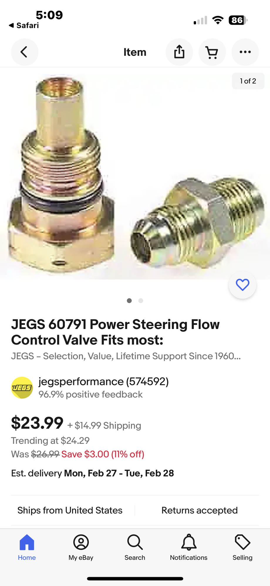

This is not the part number I bought. I just wanted to illustrate what is needed.

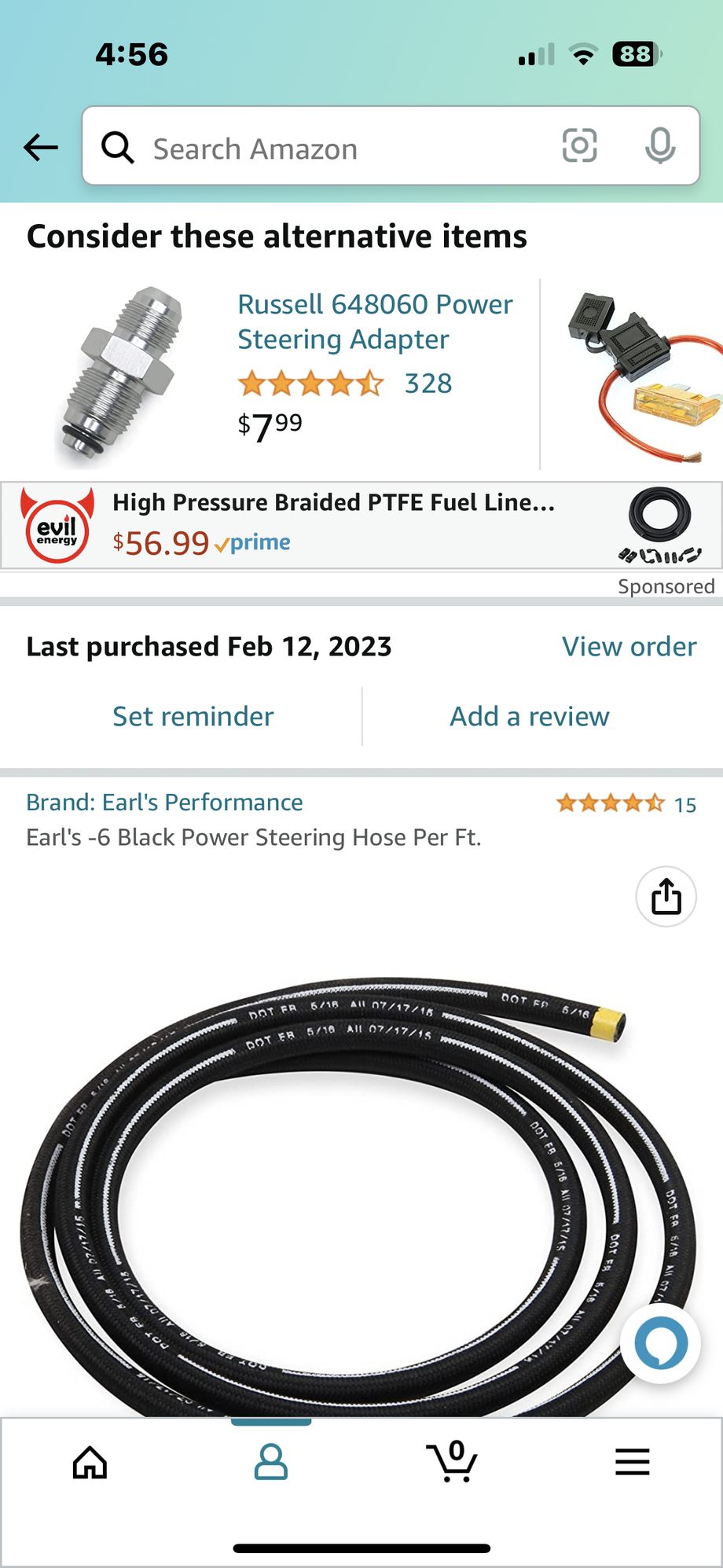

Jose I feel for you. I had problems with my high pressure side power steering hose. I changed the power steering pressure control valve and the installed a fitting with a 6AN male fitting. I had a hose made but it didn’t fit. It was made too long. I decided to buy Earls Plumbing power steering hose fitting and hose. I will be installing this tomorrow. I hope there will not be any leaks

Thank you for all your replies. I replaced the PS pump with the correct one for a 1980 that has o-ring instead of flange and I have no leaks. Now I'm just dealing with the binding on the articularing u-joints. Its been a pain becuase I can get it almost right but not perfect. I still can feel a bump at several points as I rotate the wheel. The difficulty is that I don't feel those bumps with the car is up on the rack and headers remover for easy adjustment. I feel the bumps when the car is back on the ground there is some resistance on the rack. Any suggestions from anyone who has done this would be appreciated.
