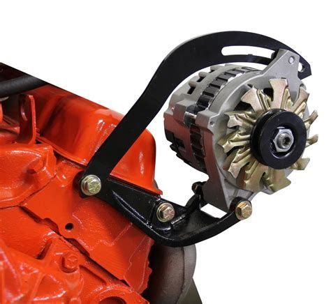

I want to change my 2" rams horn exhaust manifolds to 2.5" rams horns. However my current driver side exhaust manifold has mounting screw holes for the alternator. I have found some reasonably priced aftermarket 2.5" "smoothie" manifolds that I would like to use but they do not have the mounting holes for the alternator. Are there other options/ brackets that can be used used to mount the alternator?

Use a 1972 and later brackets lower 3951337 upper should be able to use your original. Would look like this.
