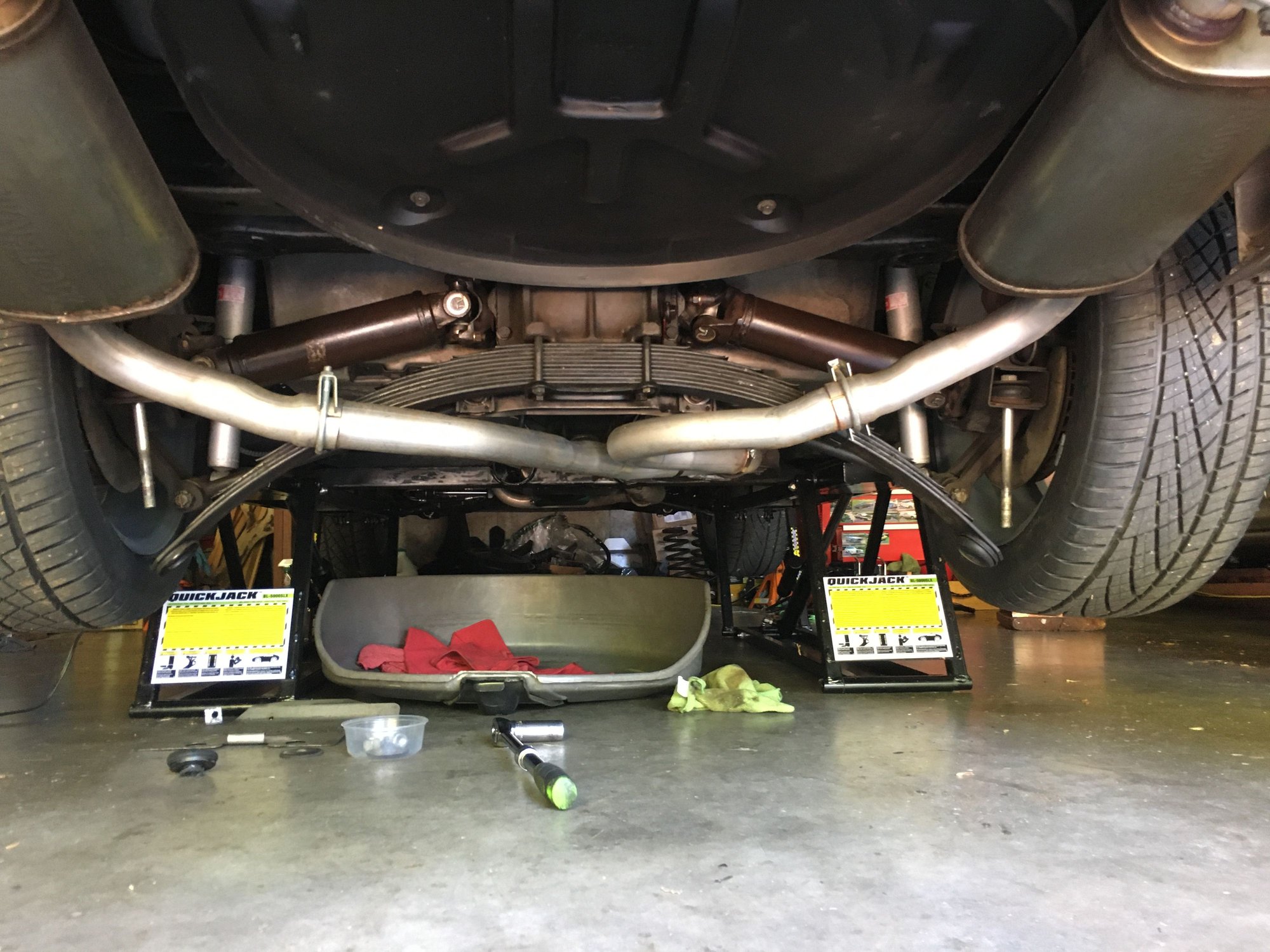

I put the original type exhaust from CC on my 78 12 years ago. The cat came with gaskets, but they could have changed joint/seal types. The Magnaflow free-flowing cat is round vs the pancake original with pellets inside. Opted for Magnaflow mufflers as well, and have been very happy with the sound they make.
CC replacement exhaust after 12yrs/16k miles.
Charlie
